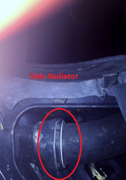

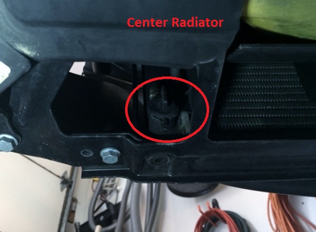

1] I only see a drain plug on the center radiator (see attached picture). Is it sufficient to drain from this one location, or should I also unhook the side radiator hoses ?

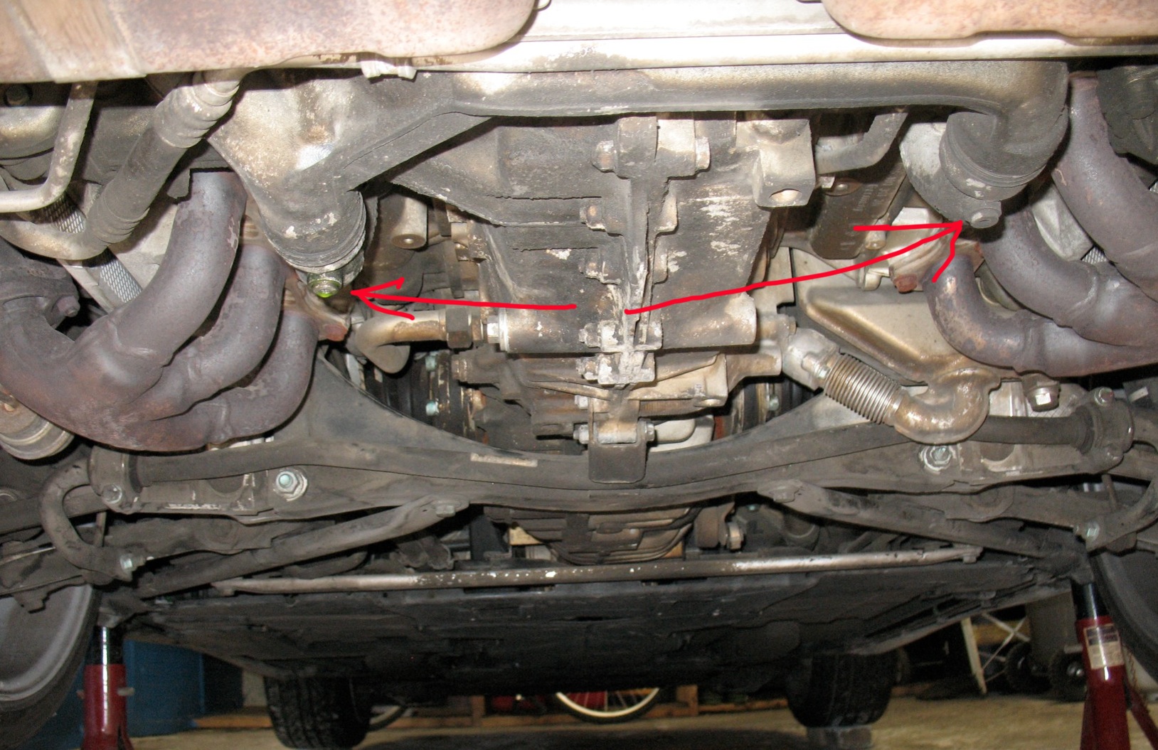

2] See other picture showing the location of where I think the 2 lines close to the transmission need to be drained. Is this the correct location ?

I've not done the 996tt but on others I remove lower hose on radiator.

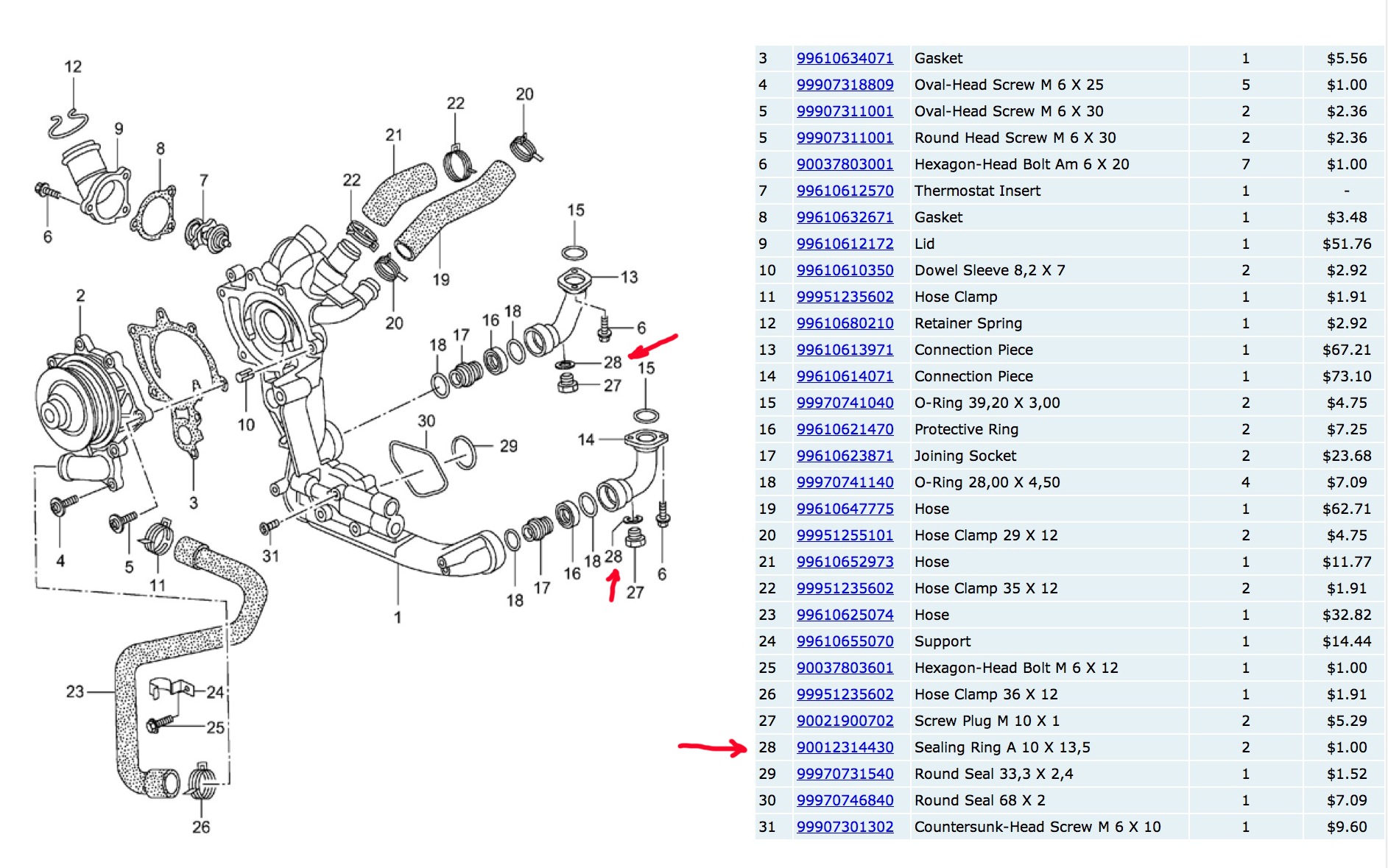

Shop manual page 520 is specific about draining the system. The engine lowest point to drain is from the elbows (see pic) There are little thin washers to seal them. Never done the job so I cannot comment about drain location. Applying air to the hoses you had disconnected near the transmission and you will get rid of the old coolant from the radiators and hoses. Also removing one hoses connected to the lowest point of the radiator can also be a good procedure.
