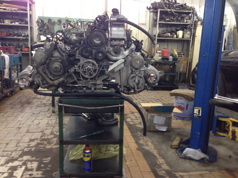

Hey guys
Iam installing turbos , the turbos are not even , one is sitting lower than the other , your kind support please . The right one looks higher, what do you think? Headers new . On my old headers and k24 , I had the same problem ( as I have been told when I installed my muffler ) is that normal ?
pics would be helpful
Check it out

if the headers are new and you had the same issue with different headers and turbos it has to be the upper turbo mounts. thats all that holds the turbo on is the upper mount and the header

Posts: 316
Rep Power: 36
Bader996 has much to be proud ofBader996 has much to be proud ofBader996 has much to be proud ofBader996 has much to be proud ofBader996 has much to be proud ofBader996 has much to be proud ofBader996 has much to be proud ofBader996 has much to be proud ofBader996 has much to be proud of
Will check it out
Thanks Steve

From: tn
Rep Power: 628
if the upper mounts are all factory and not bent in any way then that may actually be the way they sit. honestly i never really looked at mine from the front when the motor was out. its possible to be like this and make adjustments in the exhaust system to level out the tips when installed

From: Virginia
Rep Power: 575
BLKMGK Is a GOD !BLKMGK Is a GOD !BLKMGK Is a GOD !BLKMGK Is a GOD !BLKMGK Is a GOD !BLKMGK Is a GOD !BLKMGK Is a GOD !BLKMGK Is a GOD !BLKMGK Is a GOD !BLKMGK Is a GOD !BLKMGK Is a GOD !
Turbos are going to be positioned by the header aren't they? The turbo hard mounts to it right? There may be support brackets to relieve weight from the header but they shouldn't change the height.

stock header geometry with the efr turbine housing will have the compressor cover touching the tires, which is why we made our own turbine housings

Rep Power: 65
itguy Is a GOD !itguy Is a GOD !itguy Is a GOD !itguy Is a GOD !itguy Is a GOD !itguy Is a GOD !itguy Is a GOD !itguy Is a GOD !itguy Is a GOD !itguy Is a GOD !itguy Is a GOD !
Looks like you have the black market kit with headers looks like a bad boob job

Posts: 316
Rep Power: 36
Iam happy everything is good and it did fit , the car belong to a friend in Qatar
