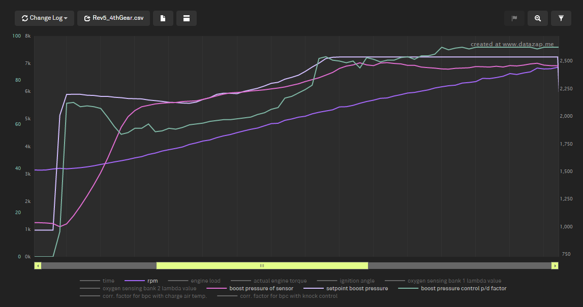

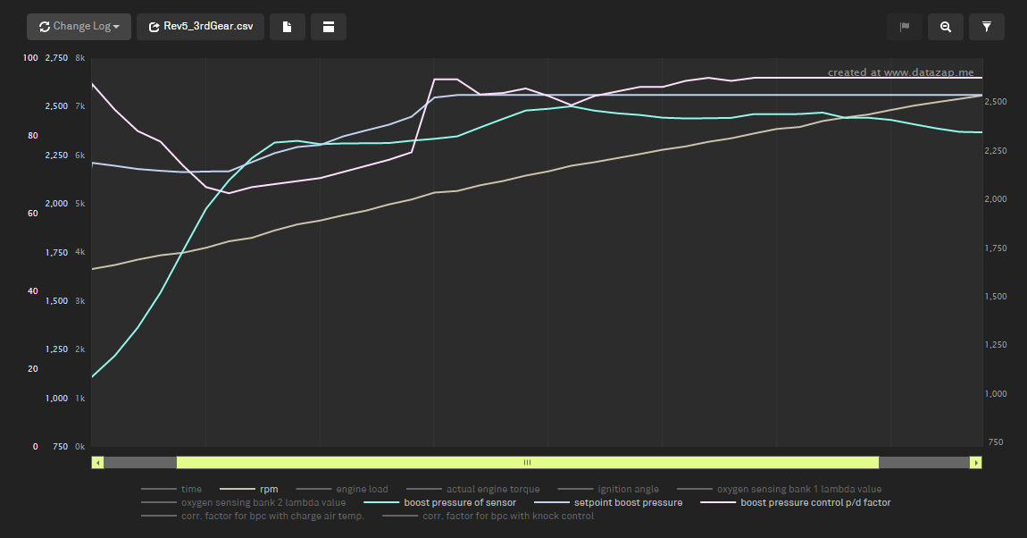

Hello Everyone,
I've recently found the limits of my turbos (Older alphas, gt2871R). I'm getting about 600 whp out of them on a mustang dyno. However, as you can see from the picture- they just can't make the boost in the top end. They're "out of steam". IAT haven't risen, so its not out of their efficiency range, just out of flow or restricted.
From personal experience, what is a good way to free up, or help the top-end flow? I'm about to do the 997tt throttle body, but I'm skeptical of the IPD plenums.
I can't imagine a 30whp gain from the plenum on a stock car, it just sounds ridiculous. That should be 60whp on my setup... I know that isn't possible.
Worse case scenario I upgrade the turbos, but I'd like to look into freeing up some top-end first! I have catless 3" exhaust, gt2rs intercoolers, and fender intakes, so the pre and post-engine restriction is low.
Thanks for any help/advice.
Cheers
Edit: forgot image...
3rd Gear:
4th Gear:

How big is your Y pipe ? I wouldnt touch the ICs and TB for now, if I read the graphs right you run 1.5bar and consider the gt2rs with similar turbos runs 1.5bar, also I was able to get easily 820whp on stock TB and didnt get to the limit, only 1.65bar
Injecting meth will make your Y pipe even narrower, take a closer look. try to use racegas only without meth and see if any difference
What exhaust do you run? This might be another limiting factor
Maybe would be a good idea to share your full setup
How is the methanol restricting anything? I don't understand that.
My Y-pipe is stock, but tapped for the methanol jets.
My exhaust is a full 3" x-pipe with no cats. Its not restricting at all.
