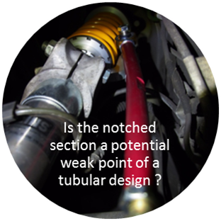

Originally Posted by daedalus
^ Thank you. Call up Tarett. They will insist it's not their fault, they've never heard of the issue, and it's installer error. And you're only the 3rd person on this forum active to respond within 24 hours with the exact same hardware setup and problem.
I sent the pictures to them tonight and will follow up in the morning

From Ira @ Tarret:
Yes, I’ve recently been working with a customer that appears to be having the exact same problem. It looks to me like the link is hitting the bracket. Is that correct, or is it also hitting the wheel carrier, or both? On the turbo cars, the link needs to be connected on the inner side of the bar to clear the wheel carrier. Also, please let me know what bar you’re using?
My bracket design has some clearance added to better clear the link. If your link is hitting the bracket, I have a spacer that I think will help.
I’m happy to work with you to help sort this out. Let me know what you think by email or feel free to give a call tomorrow.
i will get the car back to my wrench and have them put it up on rack to confirm his questions. Stay tuned

Originally Posted by rxbike
From Ira @ Tarret:
Yup that's what he told my installers. That's why we have our's installed on the inner side of the bar. It will buy you more space but not enough to prevent hitting. I have my guys source a high strength upper top bolt so we can use more washers to bring it out further and hopefully clear.

I keep thinking how spacers would decrease the load of the sway bar when it is twisting going in and out of say a driveway. From my pictures of where the bends of both sides are occurring, this seems the weak point.

Picking it up today. Ended up having to put 6 spacers/washers at the top to get the required clearance.
