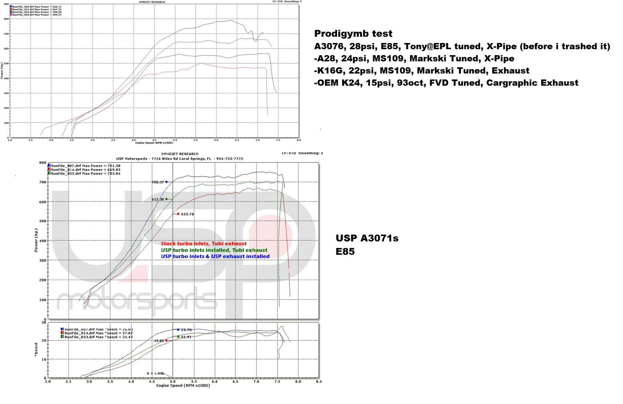

I found some old dynos and comparisons of spool etc and overlayed the USP Alpha 3071 on E85 vs the Alpha 3076 (prodigymb car) and Alpha 28s and K16 billet and K24.
Apologies for steaing this from an old thread but I guess at 21 psi on E85 the A3076r will be somewhere in the 620-650 whp area and look more like the red line on the USP A3071 curve below at that boost level

Looks like the boost comes on really well with the 3071s with the additional upgrades! And the 3076s looks very strong overlaid with those smaller turbo setups...I wonder how much that has to do with the E85?? Tune? Can't wait to see how these 5431's do on my car!!

Are 5431's more like an A28-68

Not sure on that. But it similar to a 3076 on the front side...just a 54mm inducer (76mm exducer) not 56mm and on the back side it's similar to a TD06 with a 57mm exducer. It should flow more than a 3071 and maybe even close to a 3076 since the turbine wheel is a little bigger but not sure. I chose the bigger a/r as well do it should be pretty efficient.

BLKMGK I think my charts above are apples, oranges, apple sauce and tangerines but give some basic spool up and power ideas which was the reason for them.... basic timing on E85 makes up a good portion of the gains vs other gas at the same boost but I hear you re other engine work.
