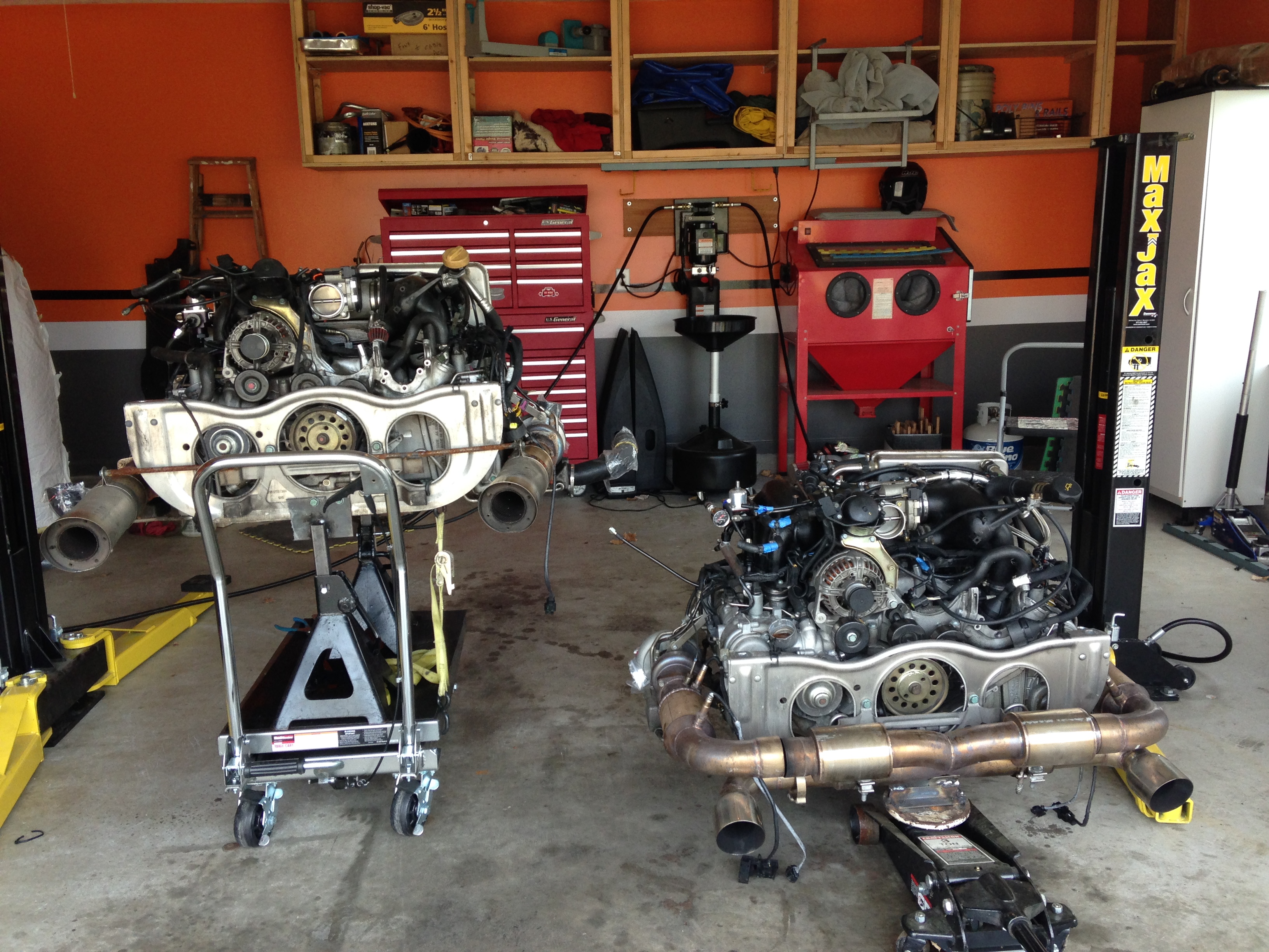

tell me about it! i think i have put 2000 miles on mine since last june when it was down for 6 months the prior. i was going to drive it all summer then another car fell into my lap and now this is going on!
Old May 2, 2015 | 10:24 AM
  #78
03EvoIII's Avatar
Joined: Sep 2011
Posts: 1,266
From: Colorado
Rep Power: 94
03EvoIII has a reputation beyond repute03EvoIII has a reputation beyond repute03EvoIII has a reputation beyond repute03EvoIII has a reputation beyond repute03EvoIII has a reputation beyond repute03EvoIII has a reputation beyond repute03EvoIII has a reputation beyond repute03EvoIII has a reputation beyond repute03EvoIII has a reputation beyond repute03EvoIII has a reputation beyond repute03EvoIII has a reputation beyond repute
LOL oh man!! At least my motor is still in the car! Better get crackin!

Swapping the engines. Sneaky

plan was to put at least one driveline back into a car today. then i woke up with a knot in my shoulder blade you could play baseball with chiro and therapy and orders not to be wrenching today killed that idea

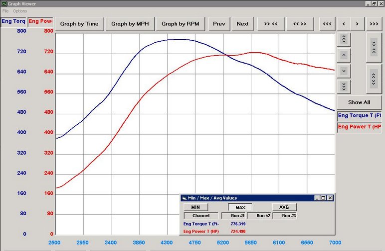

Just seeing this thread...for the OP's info...
I've been running the following set up for 6 years now:
Tial alpha series 3071
83lbs injectors
5bar
EPL tune
Water/Meth
Cargraphics Exhaust
Stock internals, stock ICs, stock inlets, etc.
Peak power on the dyno was 724awhp/776ftlbs which if i recall correctly was 1.5-6 bar and had a mix of 93 and 109 in the tank.
I've probably put >35k miles on the car and probably 15-20 track days. No issues.

Also very interested in this data. HP is a "calculation" of torque based on RPM. I think the potential for high-hp on stock engines is there, its just needs to be up top.
What really impresses me is the fact that its holding together with the stock intercoolers and inlets. Methanol is a hell of a... dru.... fuel. There is so much potential. I'd like to know a little more about how your meth is set up, as well as your boost!
Also would love a data log or two...

Here is link to the original meth system install: https://www.6speedonline.com/forums/...-complete.html
Here is a copy of the dyno graph i could find, will see if I can find boost profile...

Have any vbox data to back up the numbers?

Okay now I'm truely impressed... That is serious rod-bending torque.
I dyno'd my car at 680WTQ on a mustang dyno (one of EPL's dealers). When I saw that number I **** bricks and had todd tune out more boost in the bottom end.
Maybe you just have a miracle engine or something. Thats why I'd like to see the data-logs

Congrats on the setup, I presume this is on stock ECU?
Other members (including myself) have made such numbers (with many other mods) on 3076's E85 and 30+psi of boost.
Would love to see some v-box data...
