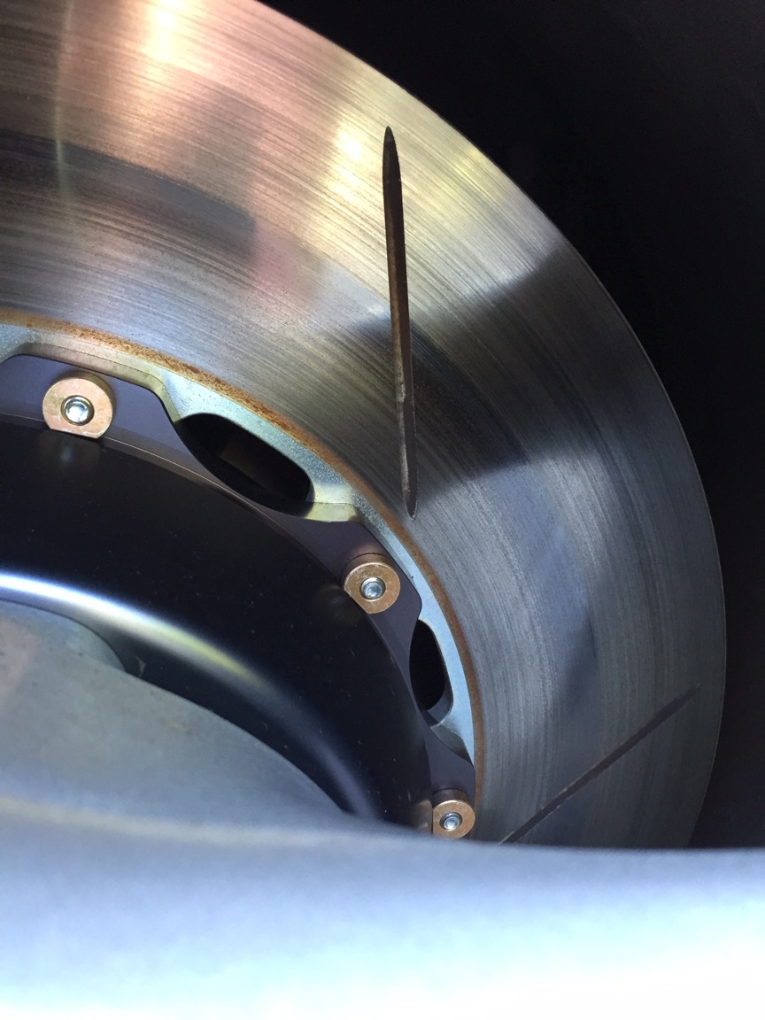

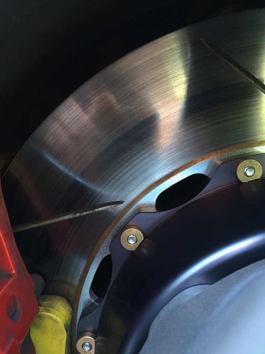

I finally had some time to get out & bed the brakes/rotors in on Saturday. I made 10-12 runs from 100 down to about 40. Looks like I transferred material from the pad to rotor. Not sure if I do a second round as I'm going to VIR next weekend for a 3 day HPDE event. Just wanted some thoughts.
