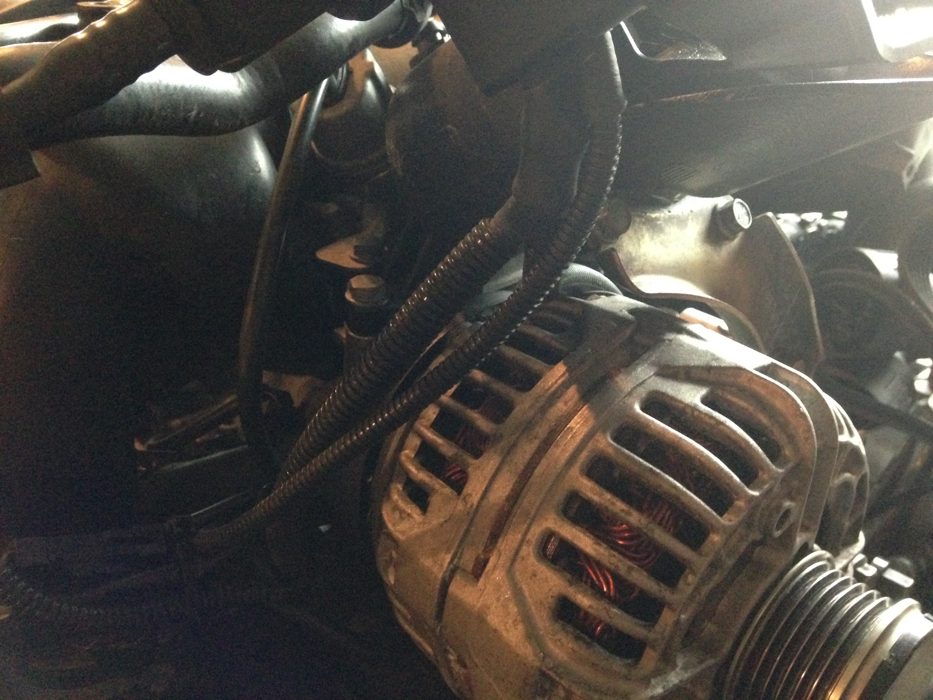

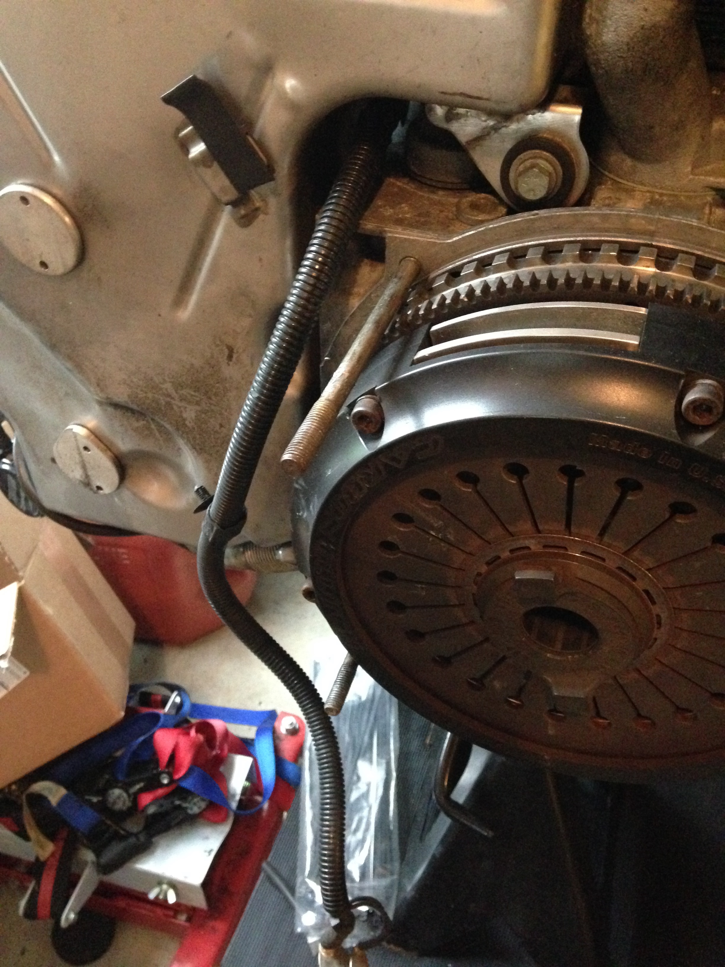

it just so happens i have a motor sitting on stands so i grabbed a few pics for you! looks like its a diy with some patience. it feeds under the oil tank behind the a/c compressor under the oil filter and up to the jump point and alternator. looks like theres some tie wraps holding it along some other harnesses but doesn't look to awful difficult. remove the a/c compressor and lay over the back of the car. this will get you the most access. no need to remove the a/c lines.
heres a few crappy pics
Sweet! Thanks. I need to check the voltage but ripping these out looks like a job where I will be throwing wrenches across the room.
