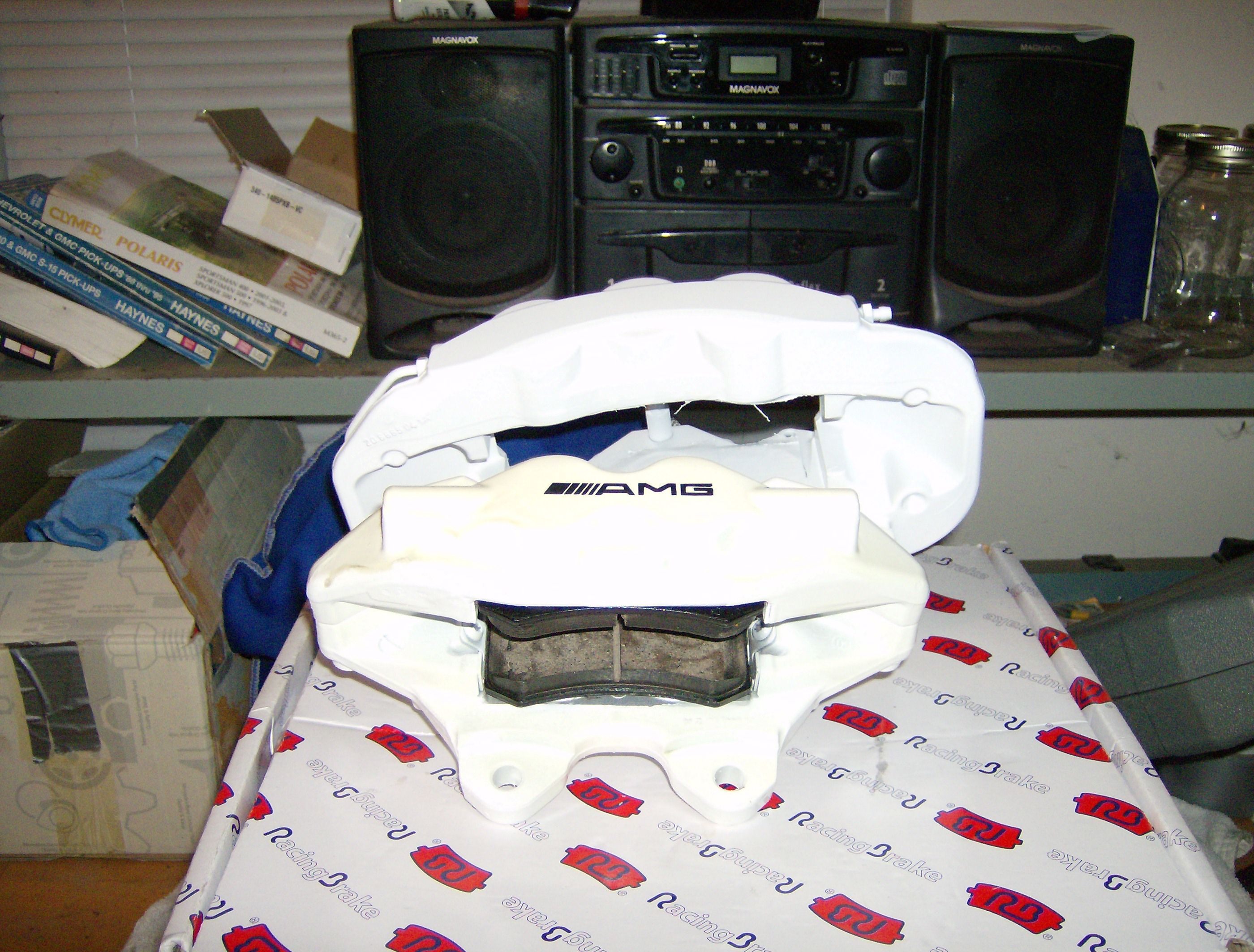

i did mine in white first. big time keeping those monsters clean!

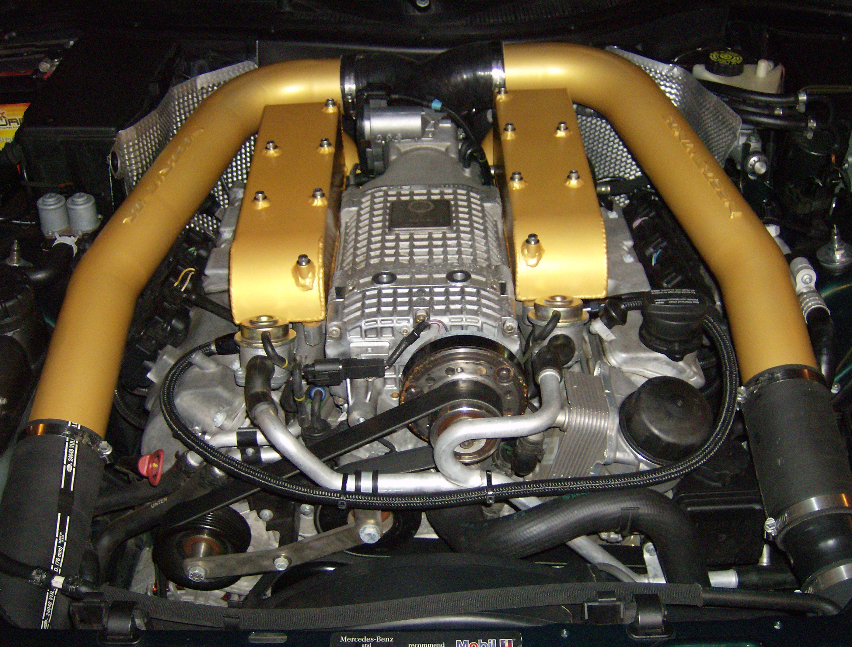

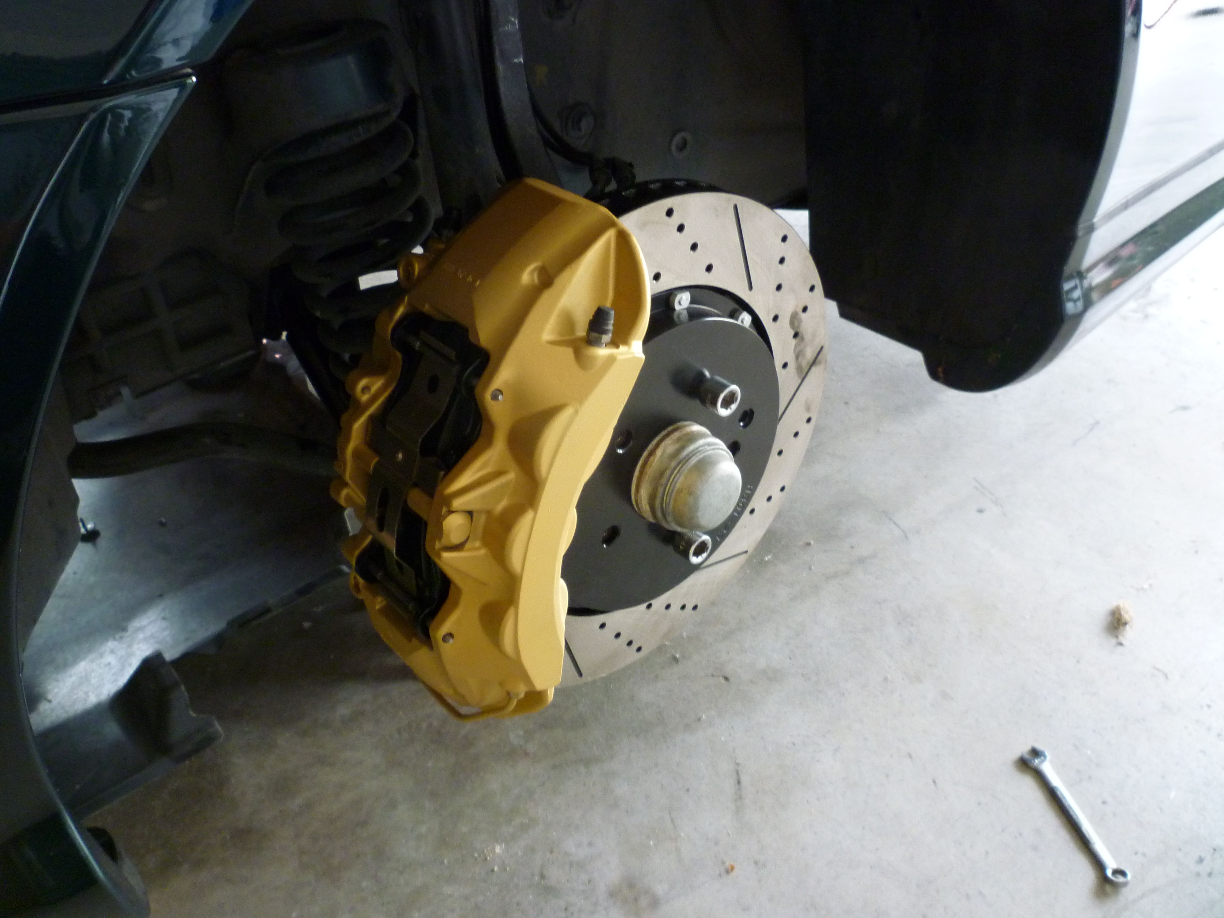

i did my amg calipers in gold! they went well with my engine mods. teflon coating for heat dissipation
