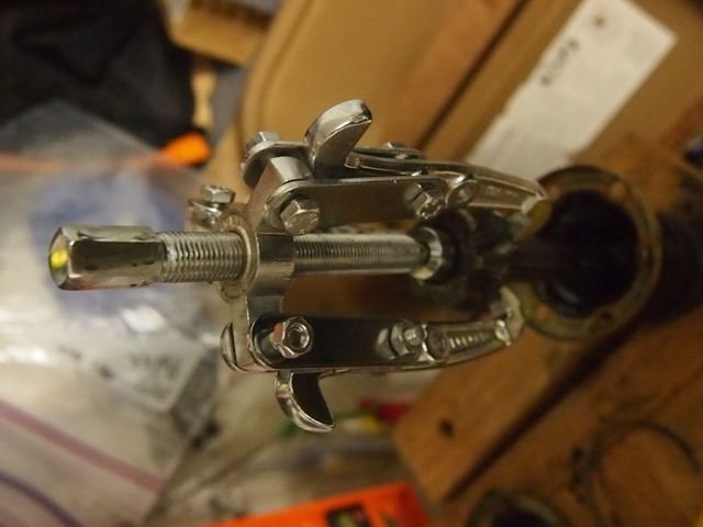

I replaced an outer boot on mine recently (replaced the inner boot as well since I had it apart). I ended up using a a 3 jaw puller. Have you already removed the c-clip itself? I tapped it a few times but there was no way it was coming off that way. With the puller it came off nice and easy...I think I took some pics and will dig them up and post for you.

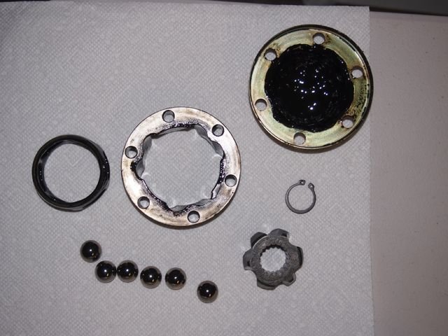

Found a couple pics...sorry for the quality. I ended up taking apart the inner joint to be able to slide the new boots on. You can rent one of these pullers at some autoparts stores. First pic shows the puller doing it's thing, second pic is inner joint taken apart while I started to clean it up, third pic is of everything back together with new oem boots.
