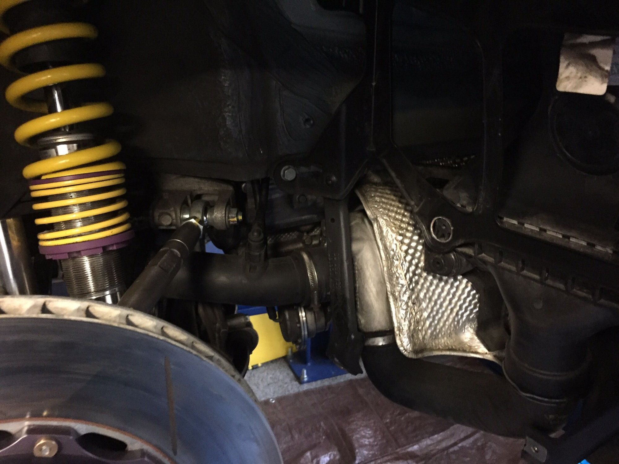

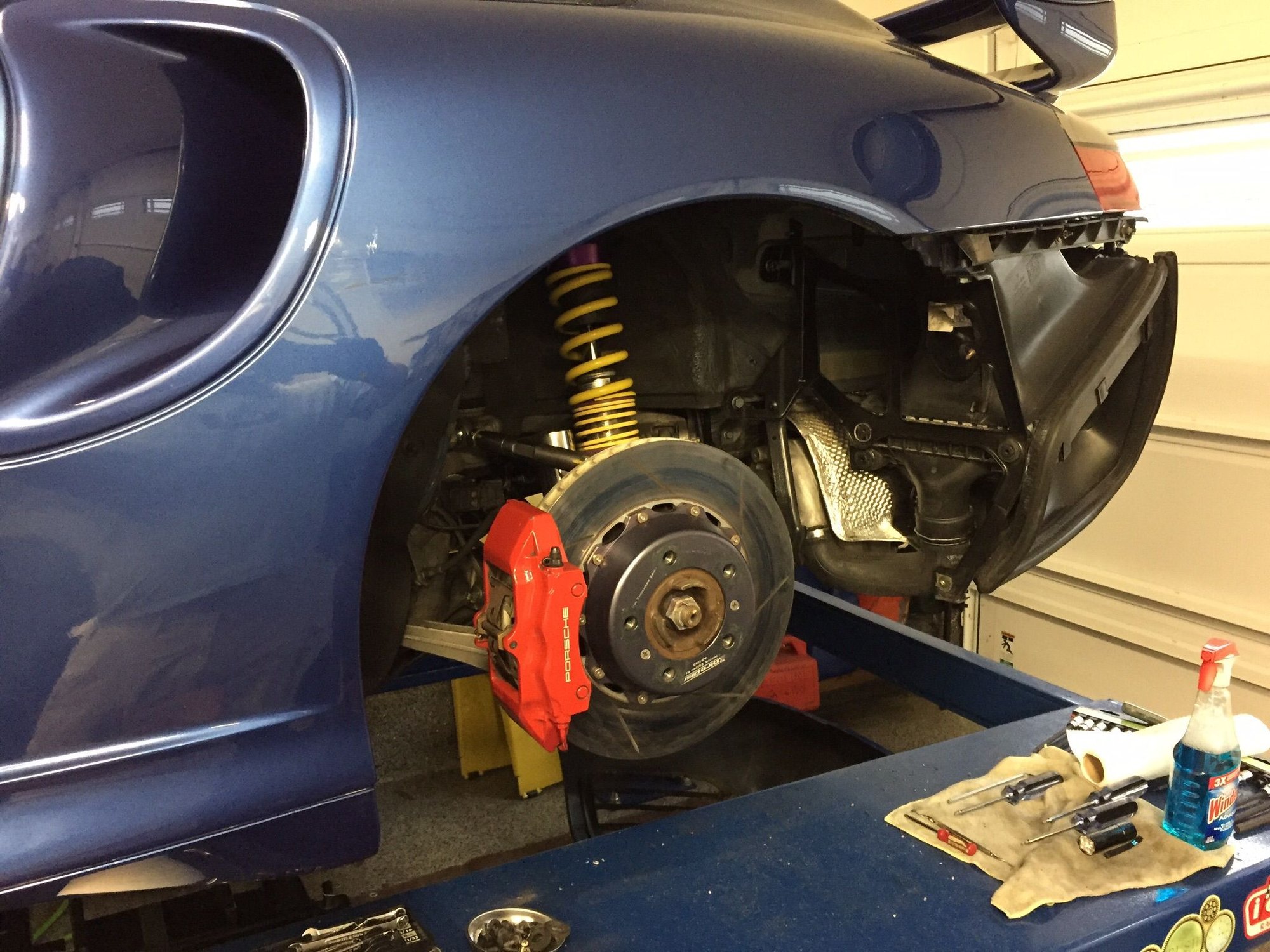

I have the exact same issue (same location) going with my car. More rubbing going on with the driver side. Took everything apart yesterday to investigate.
Old Jan 10, 2016 | 10:04 AM
'02996ttx50's Avatar
Joined: May 2009
Posts: 7,984
From: la
Rep Power: 608
About to get started and I appreciate the pictures I'm getting all the advice I can anywhere I can but I can't for the life of me see any rubbing it's got to be because the pictures are not showing up properly on my phone ?? is your rubbing in the same place as my earlier picture upthread? appreciate it if you are online if you could let me know Thanks
All I see is coilovers and heat shields !?

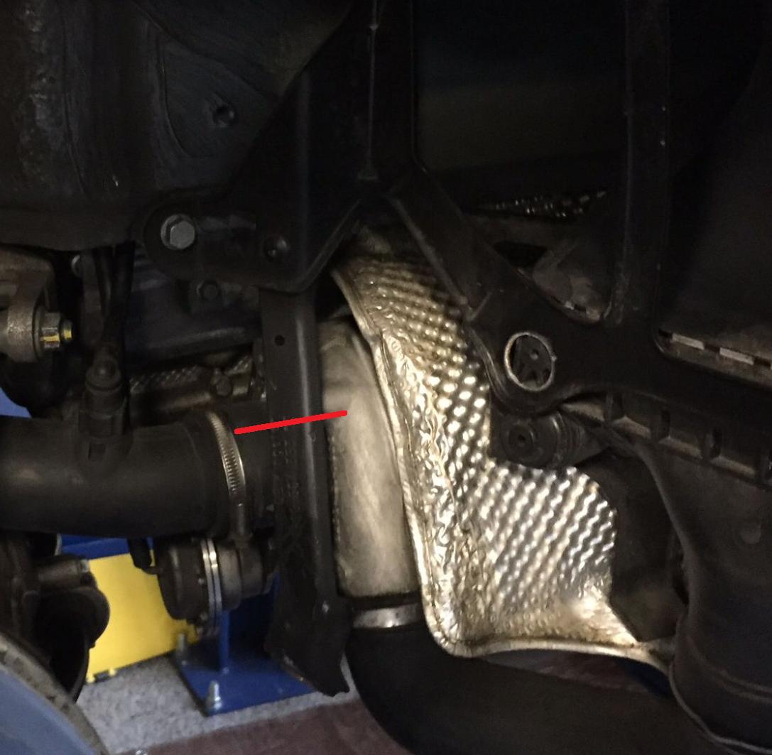

Will it work to just cut the tt piece, drill a hole and use the speed nut from the cut of piece?
Or is the angle different?

Ronny - Is that actually how your car is? You run without a fender liner and are still rubbing? Where is the inner fender liner?
Old Jan 10, 2016 | 12:17 PM
  #29
Ronny-'s Avatar
Joined: Mar 2015
Posts: 215
From: Norway
Ronny- has much to be proud ofRonny- has much to be proud ofRonny- has much to be proud ofRonny- has much to be proud ofRonny- has much to be proud ofRonny- has much to be proud ofRonny- has much to be proud ofRonny- has much to be proud ofRonny- has much to be proud of
No picture was borrowed from viprklr
I run with the liner but it has rubbed through so i need to fix it before getting new liners.

i don't have my car close but i don't remember the bracket being so inline with the compressor housing. seems mine is closer to the fender
