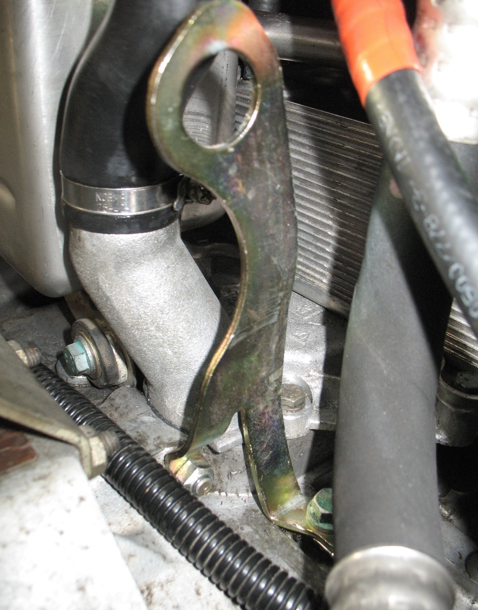

Here it is:
Name:	Screen Shot 2016-01-19 at 06.58.52.jpeg

Only one eyelet ?? where do you lift from the front of the engine

The eyelet is to lift the engine with the transmission attached. But without the transmission you can use the eyelet and the two attach point on the engine carrier. Were the chain ares on this picture.
