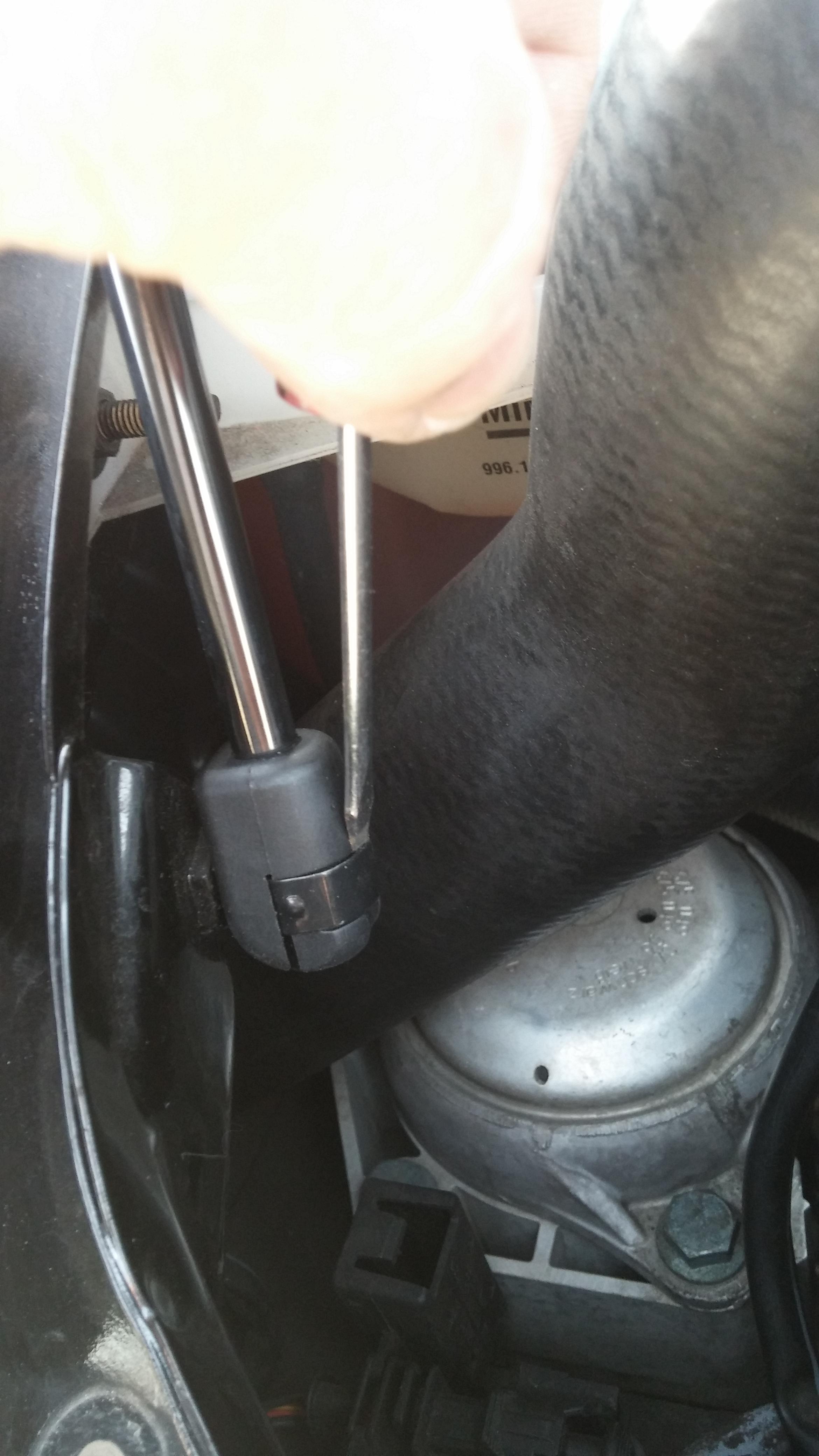

drivers side: just slide the screw driver and pop the clip, make sure you hold it the metal clip, we don't want to drop inside the engine bay. pop the strut out

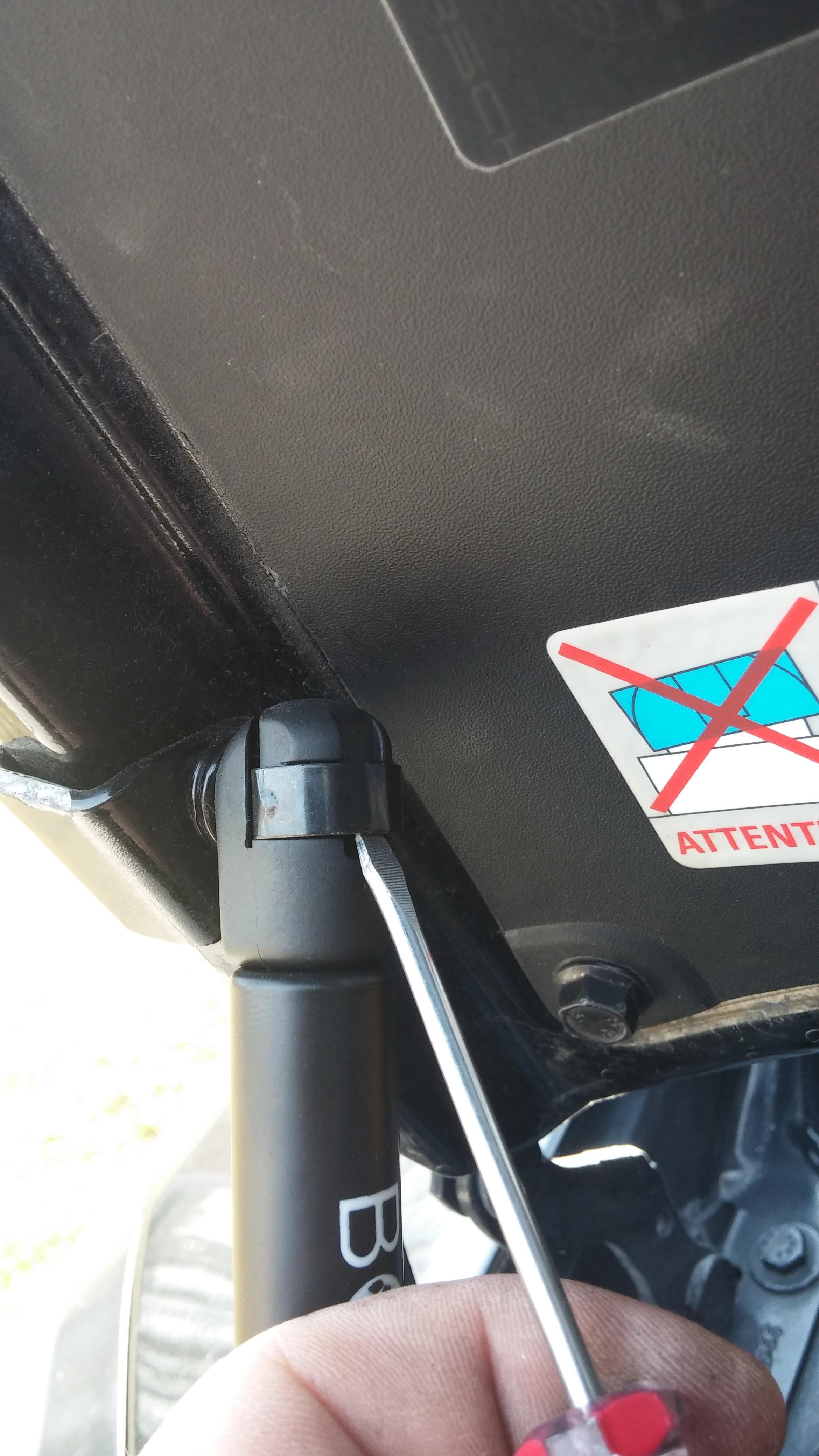

same thing with upper one.

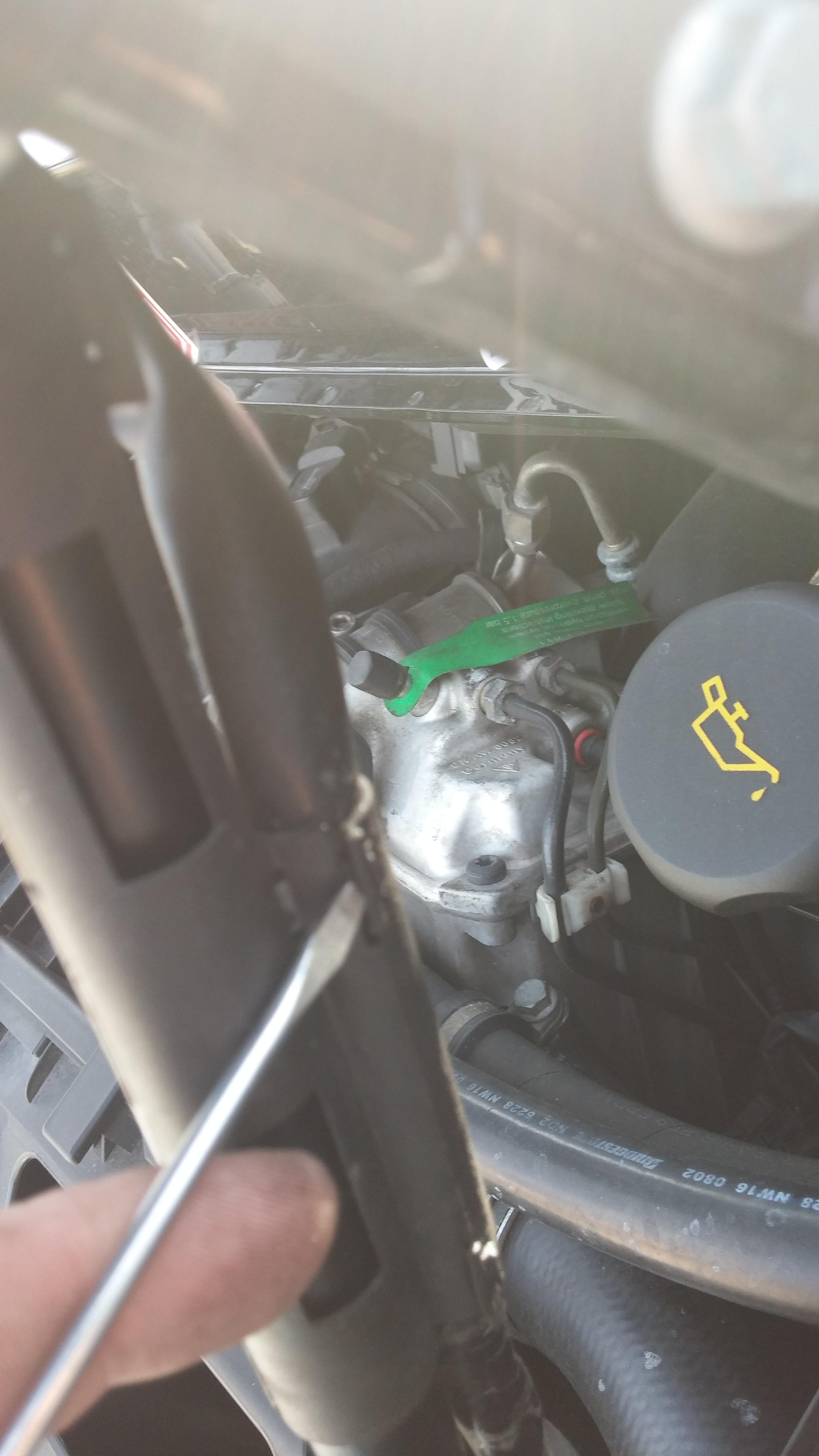

take new strut and just snap it on. done, easy right?
now the passenger side:
behind the strut you have 2 small clips, just pop them open. move harness to the side. pop the clips, done.
