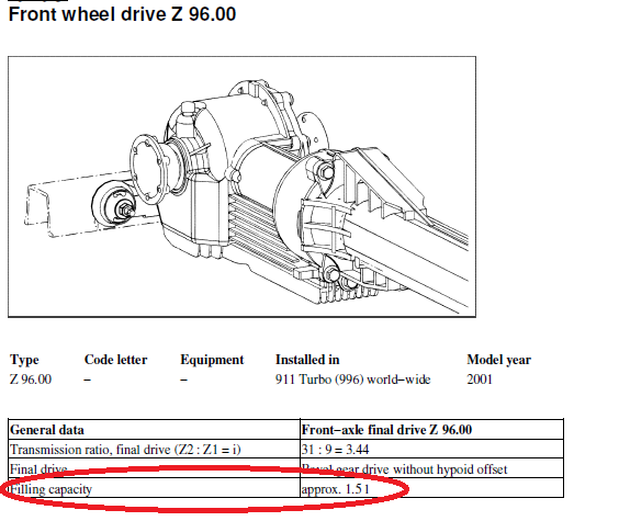

Originally Posted by magoochi
Thanks guys ...I mainly needed to know how much gear oil I will need. I already did the trany and only have 1 quart left. Looks like I will need +/- 1.5 Qt. to do the front Diff.
Thanks
