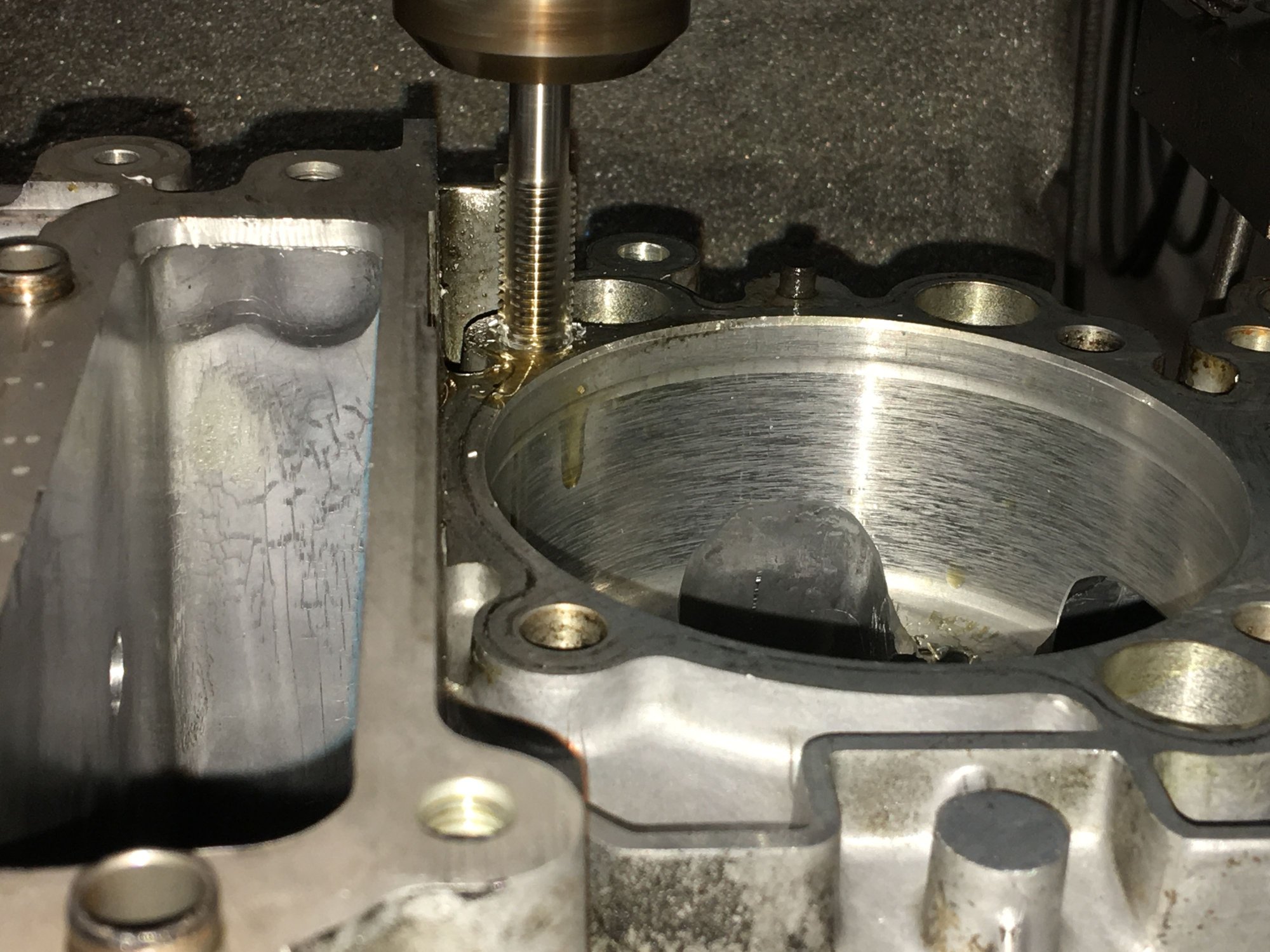

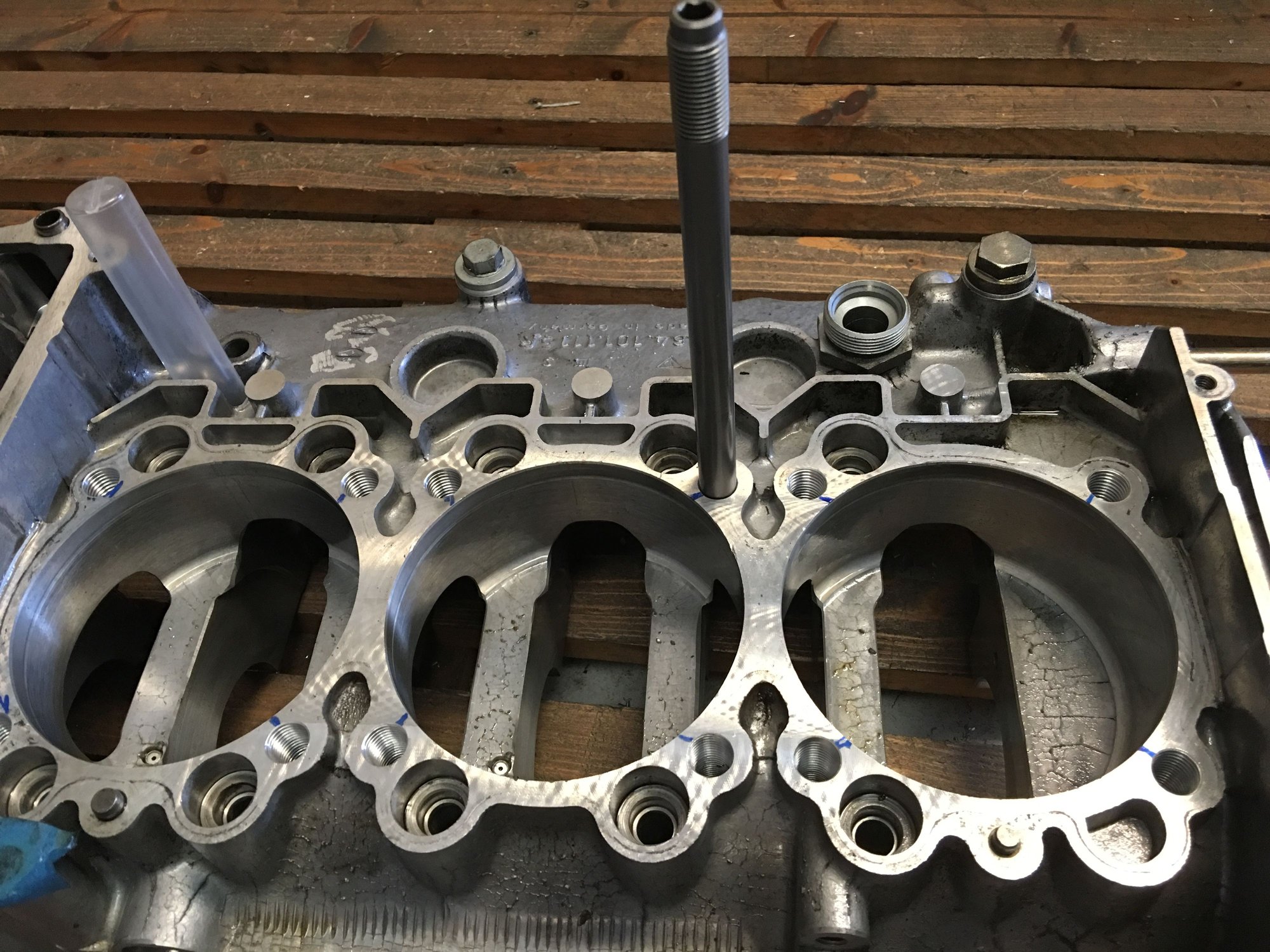

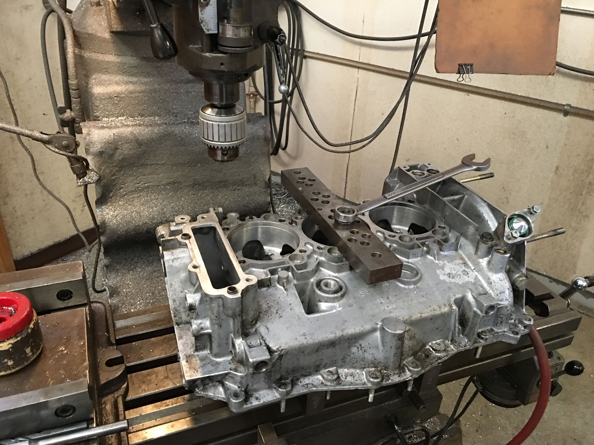

As some of you may know we're the ones responsible for the build of turbodanny's 996. We put this car together last year and it was suppose to be a raceware 10mm build shooting for 850-900whp. Well we all know how that goes. The car ended up making a little north of the 1000whp mark and was limited by fuel. Being that I built a lot of other platforms beside the Porsche boxer engine I never felt comfortable with the 10mm studs/stock piston & liners at the level(I know this is a never ending argument). This go around we went the 12mm route, forged piston& steel liner, I feel much better. We're shooting to have the car ready for FL2K in Bradenton, FL. Since there no shops in the Tampa Bay Area that are heavy hitters in the Porsche market we're looking to fill that void. Stay tuned we will post more pics of the build as it progress.
