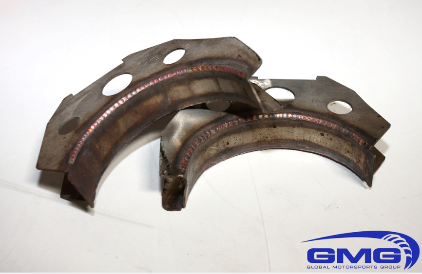

Yes, thanks. It does in fact use T-Bolt clamps in conjunction with two half circle wedge shaped brackets that go between the muffler can and the rear support on the car. Unfortunately, this exhaust does not suck directly up to the rear support like most systems for these cars.
i have the same exhaust in 3". t bolt clamps are all thats needed to mount it
Interesting..... I'll have to mock it up again and take a look. These are the brackets that GMG sells for the exhaust? Do you have any pics of yours mounted? BTW, how do you like it? Is it "run you outta the car" loud?
ill have mine mounted tonight and take a couple pics. as for loud its not suoer loud but i had terrible drone with the 4" slash tips. welded some 4" round double wall tips and the drone all but went away. straight cut gears in the trans fake cats big cams zero foam under the carpet and triple disk c/f clutch so my car is loud as can be anyway

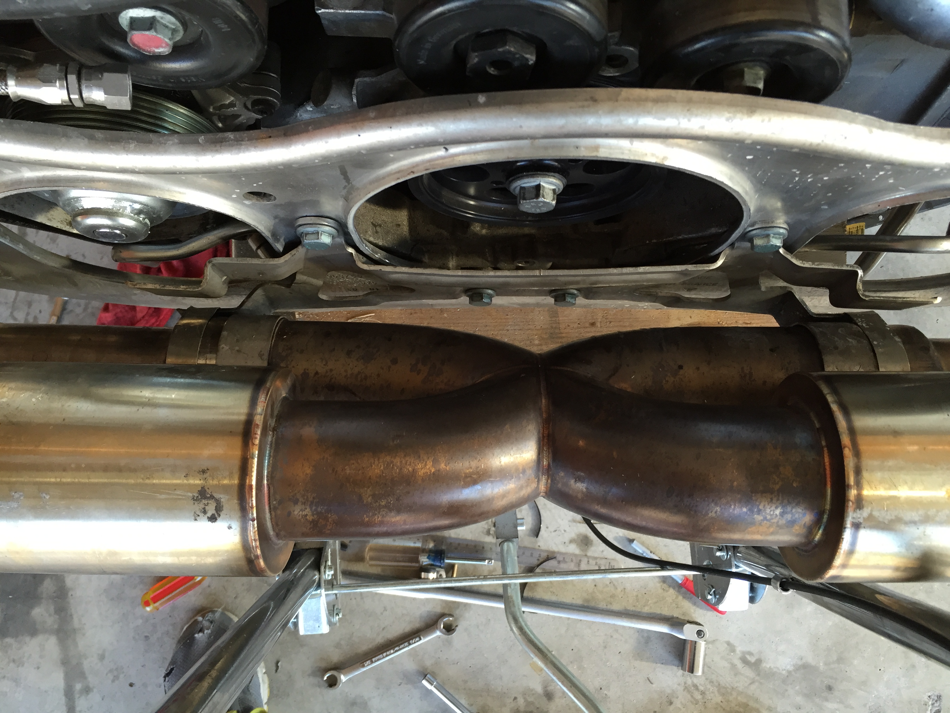

heres mine. withe exhaust mounted to the turbos and the main engine support its rock solid zero movement
Thanks 32k! I like the tips on yours. I'm going to go mock it up again this afternoon. Hopefully it will line up like yours. Why did you pull your engine?
