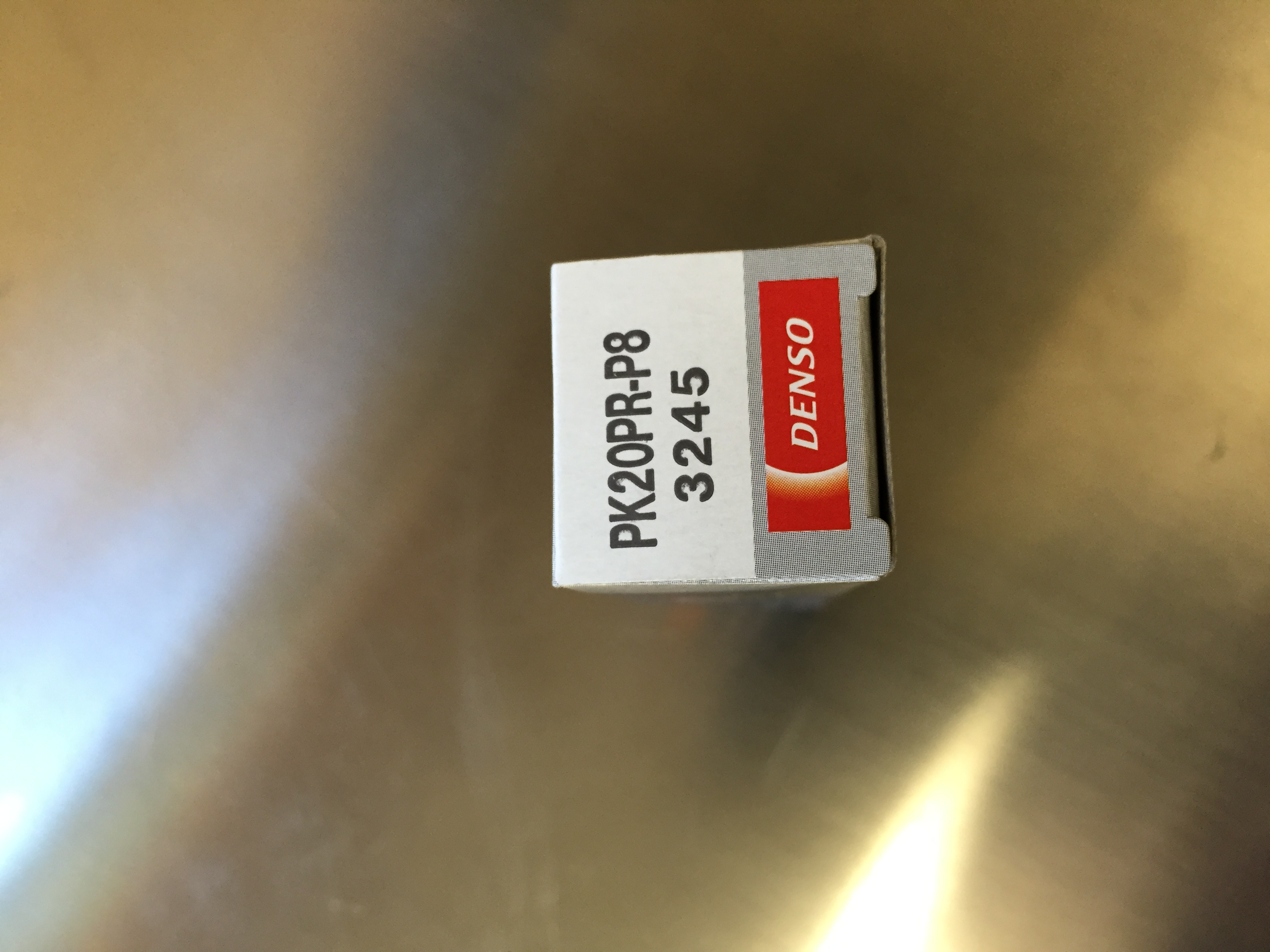

Replace Spark Plugs with Denso PK20PR-P8 Gapped at .025

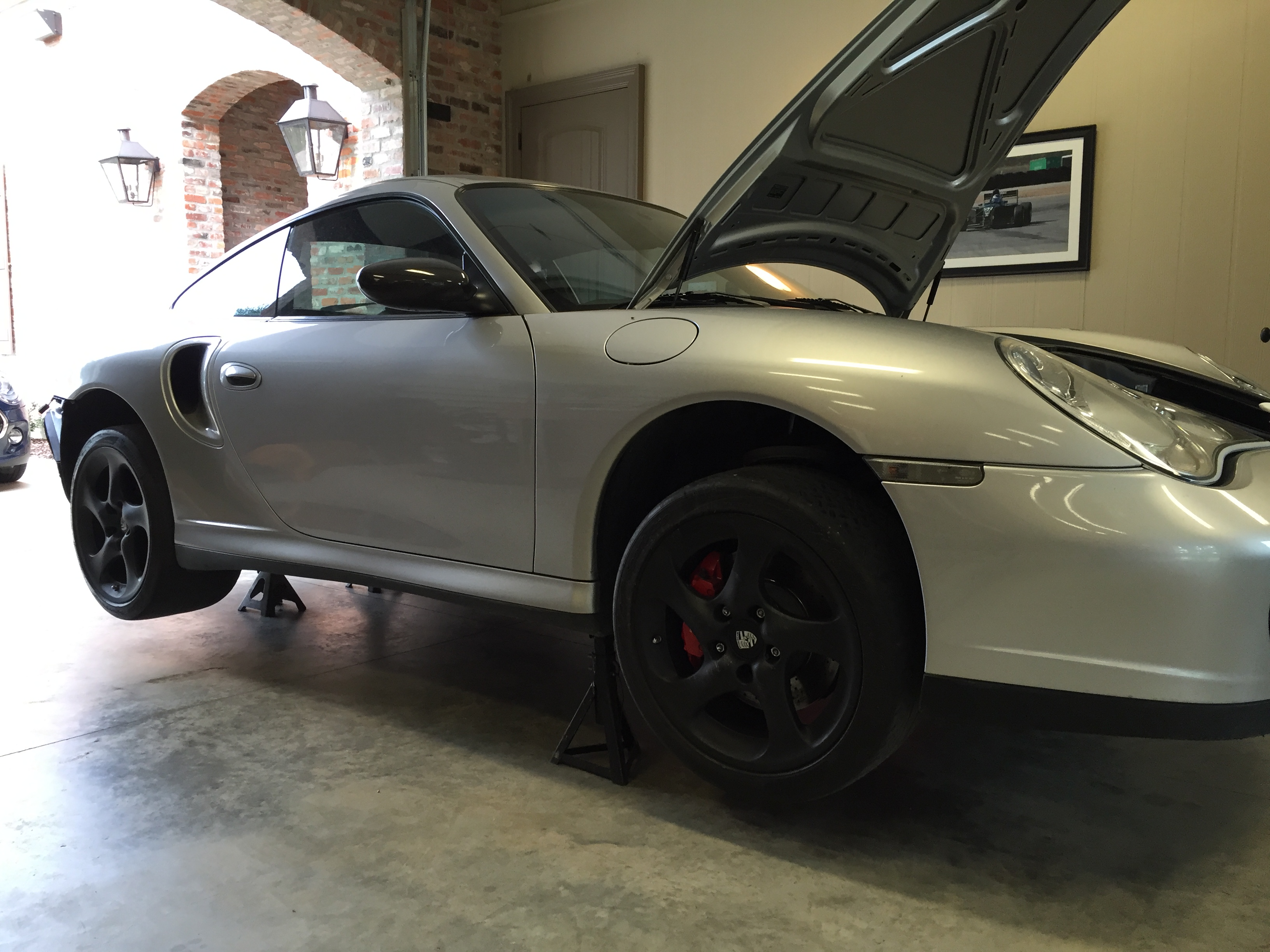

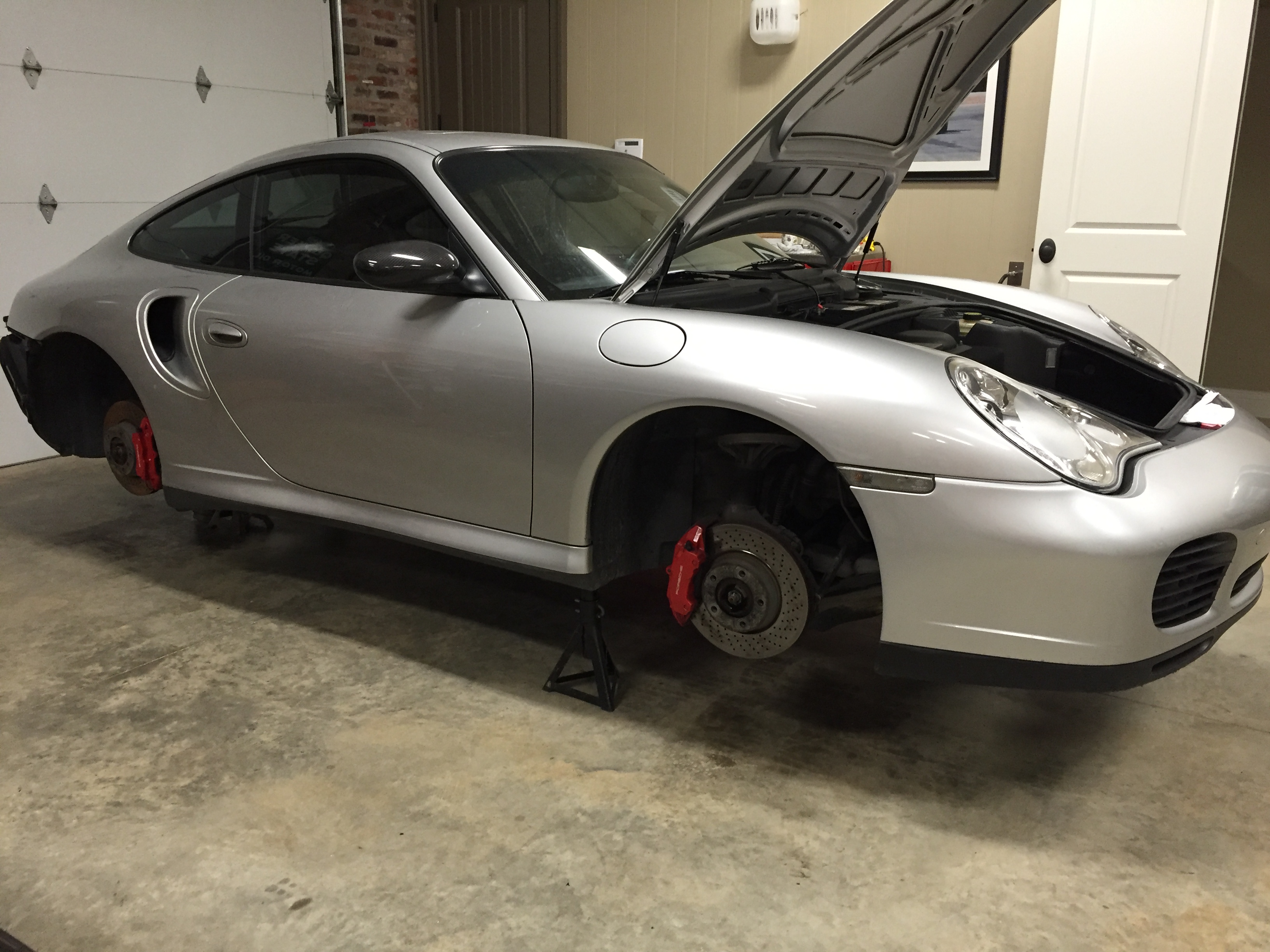

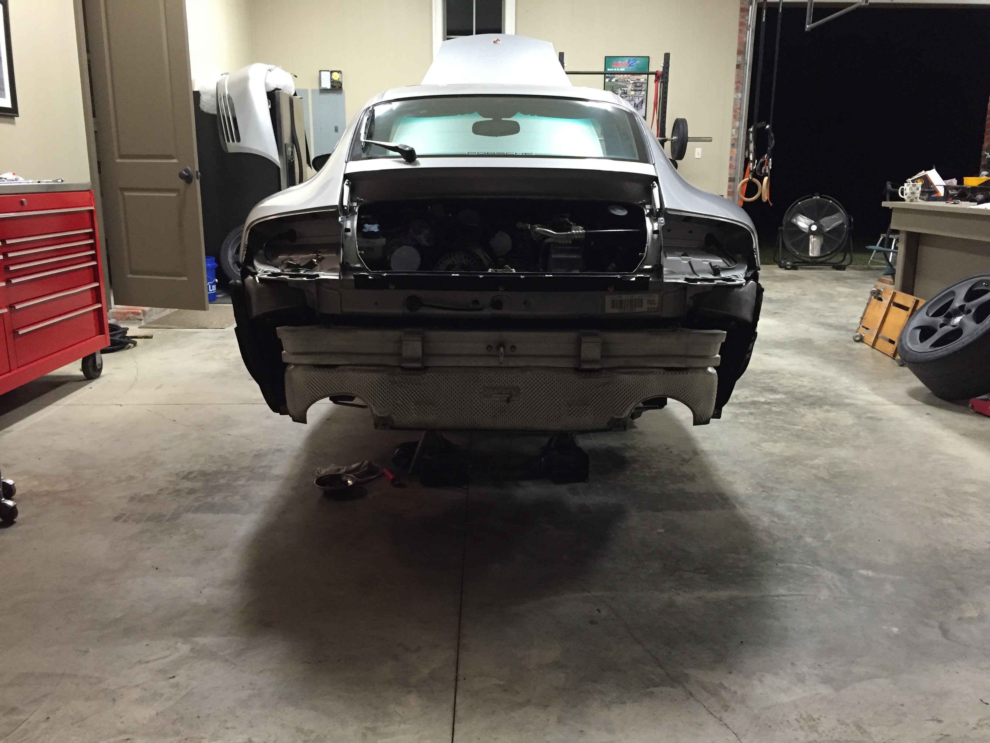

First Order is to get this thing up on stands and remove the wheels.

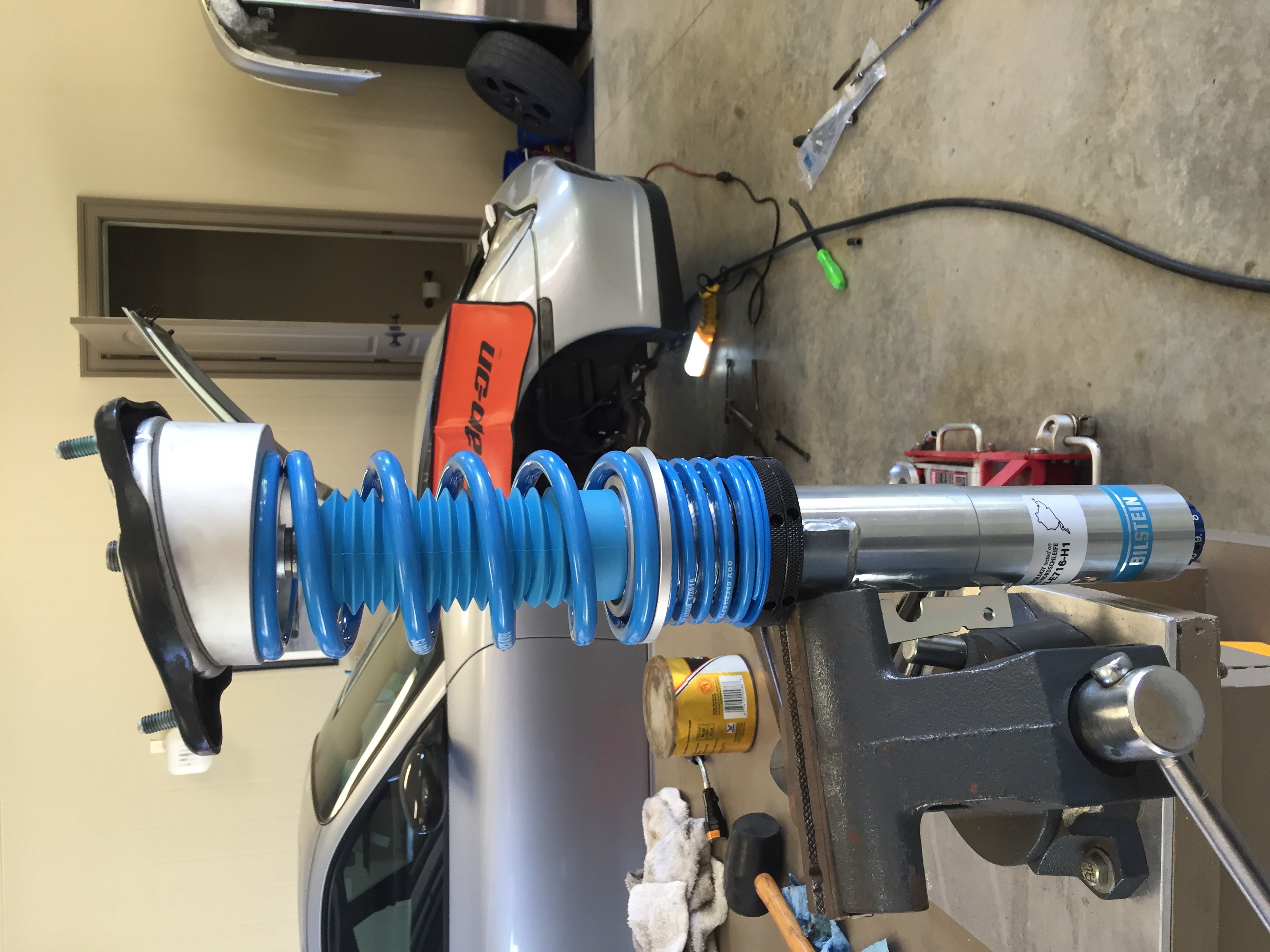

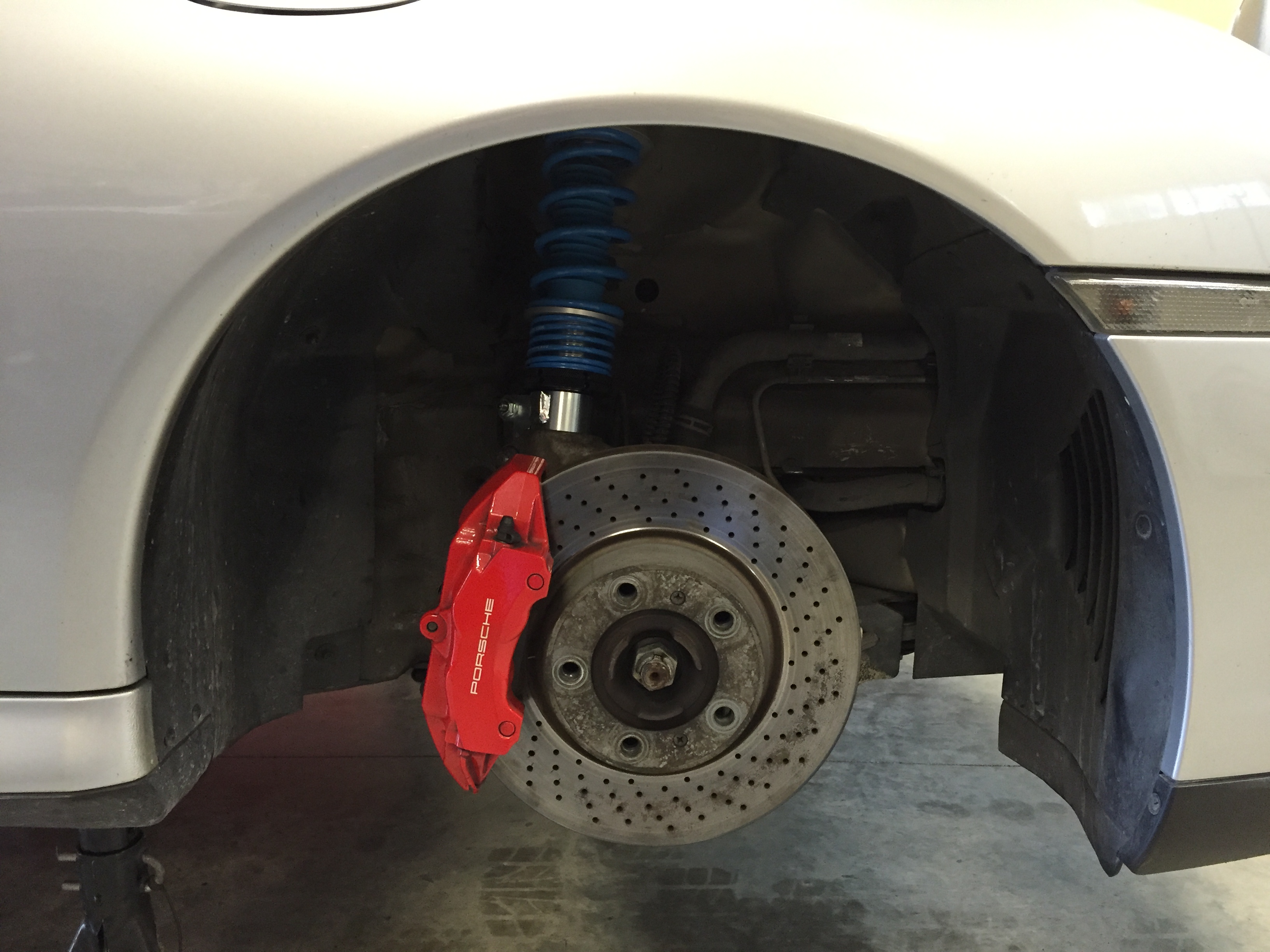

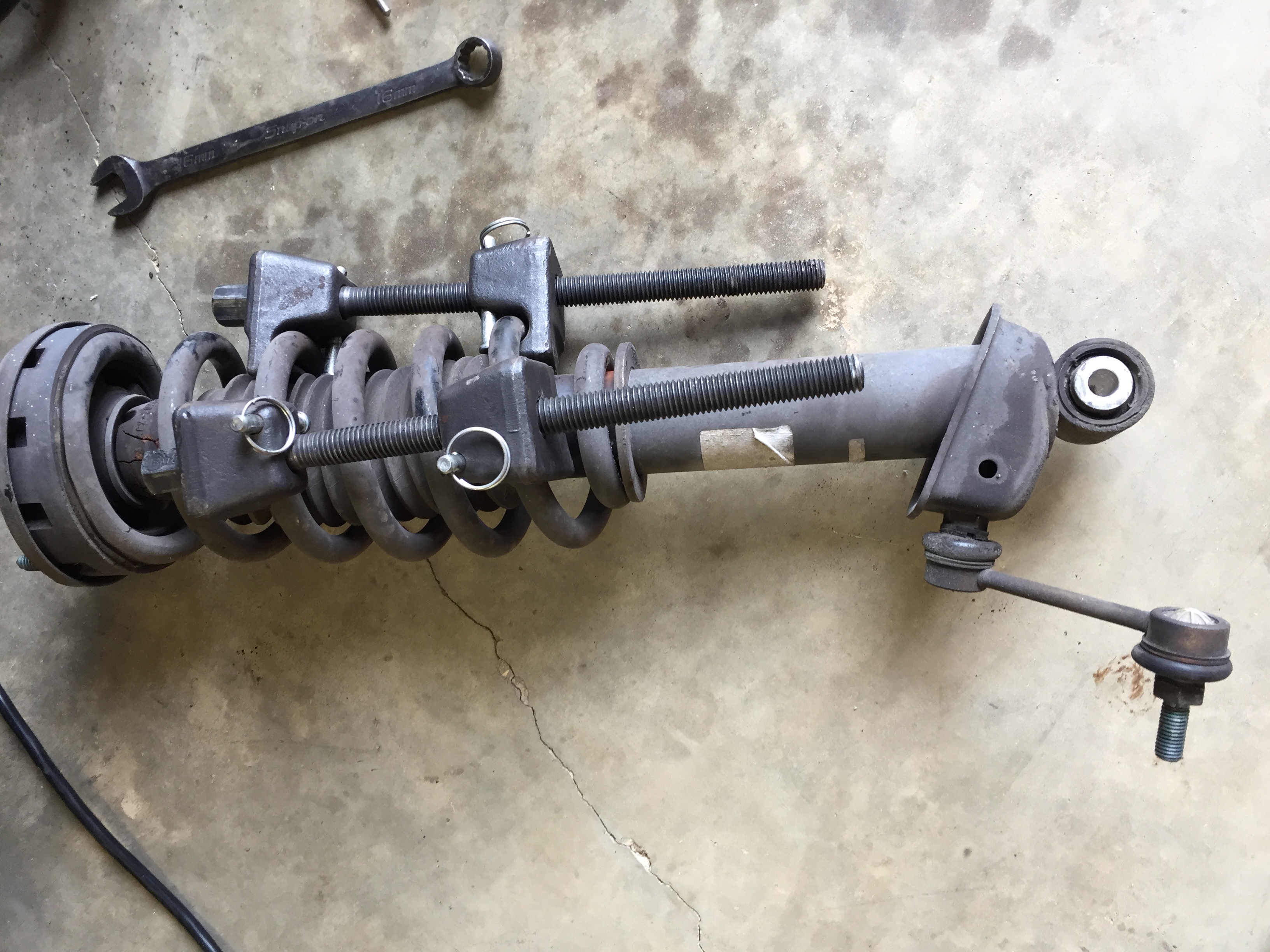

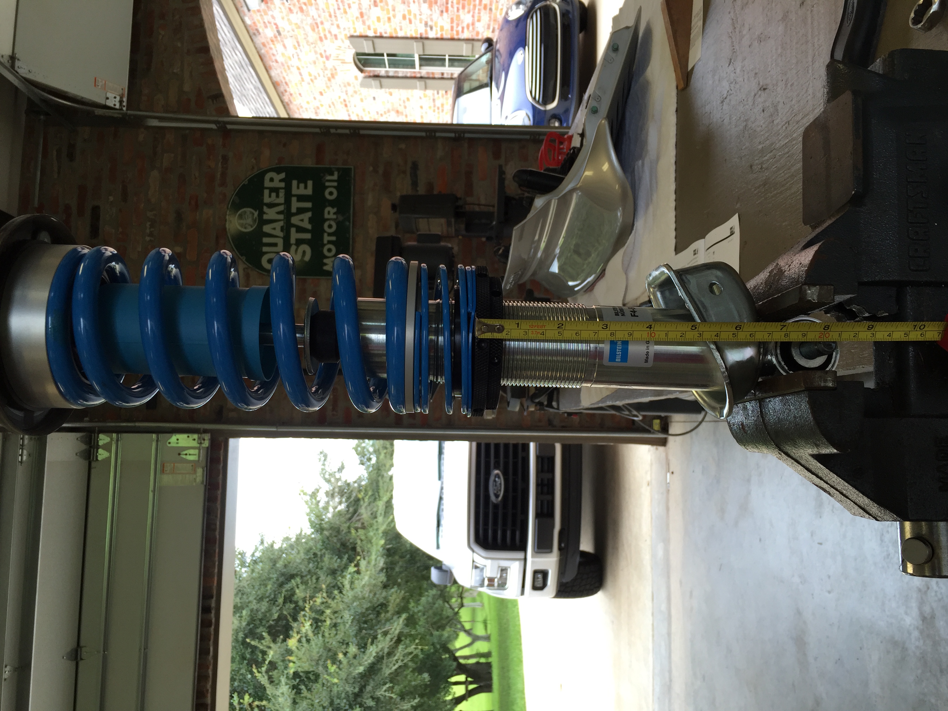

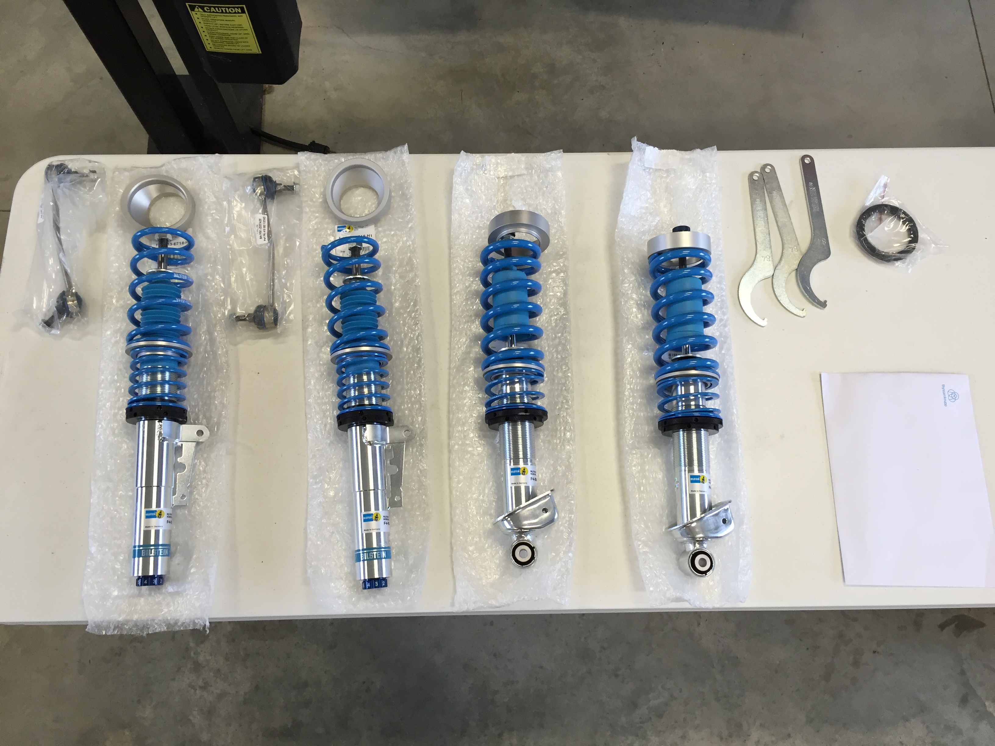

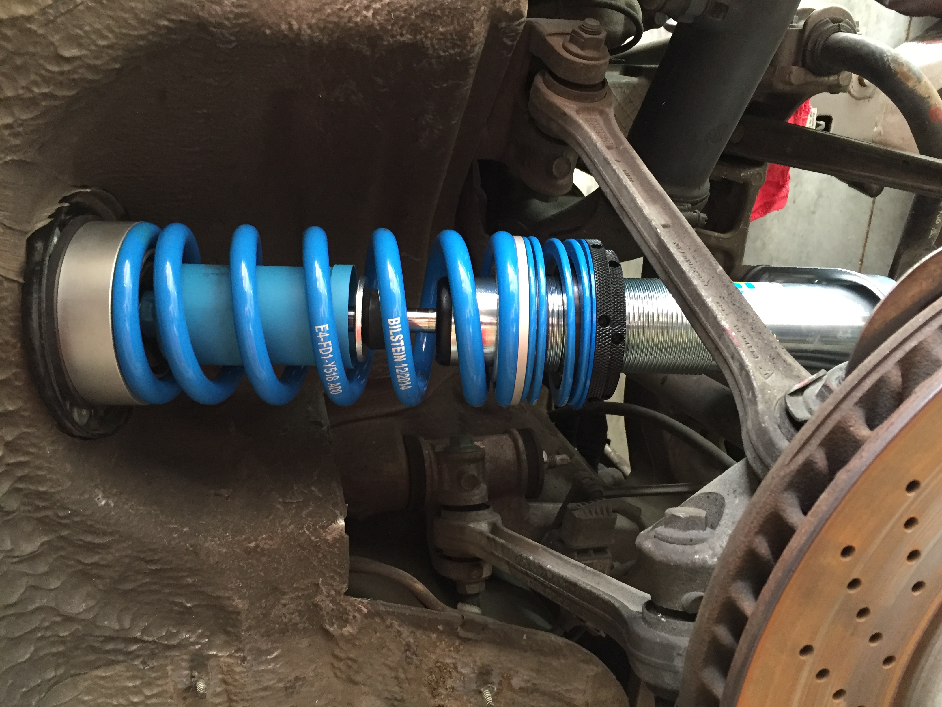

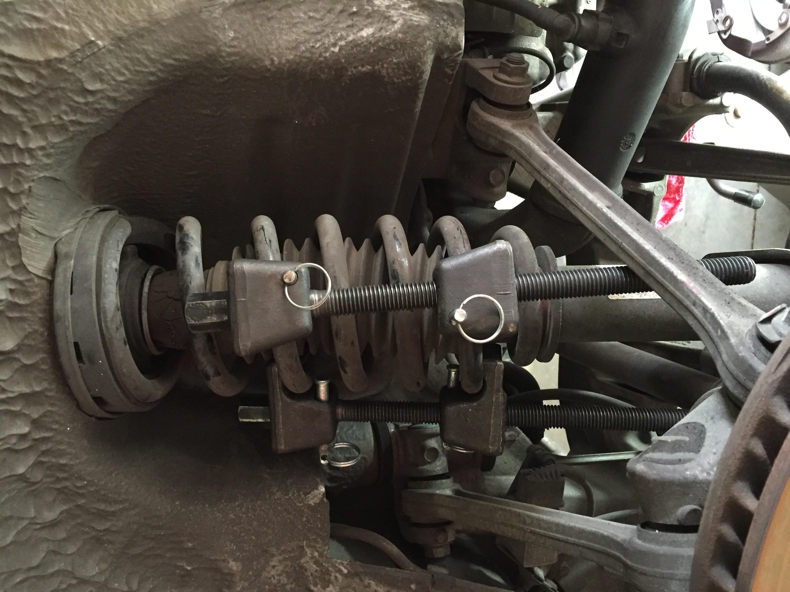

Next, time to remove the old suspension and install the new PSS10's. I did check the ride height settings on the PSS10's and they were adjusted within range of what Bilstein recommends so I left them as is for now.

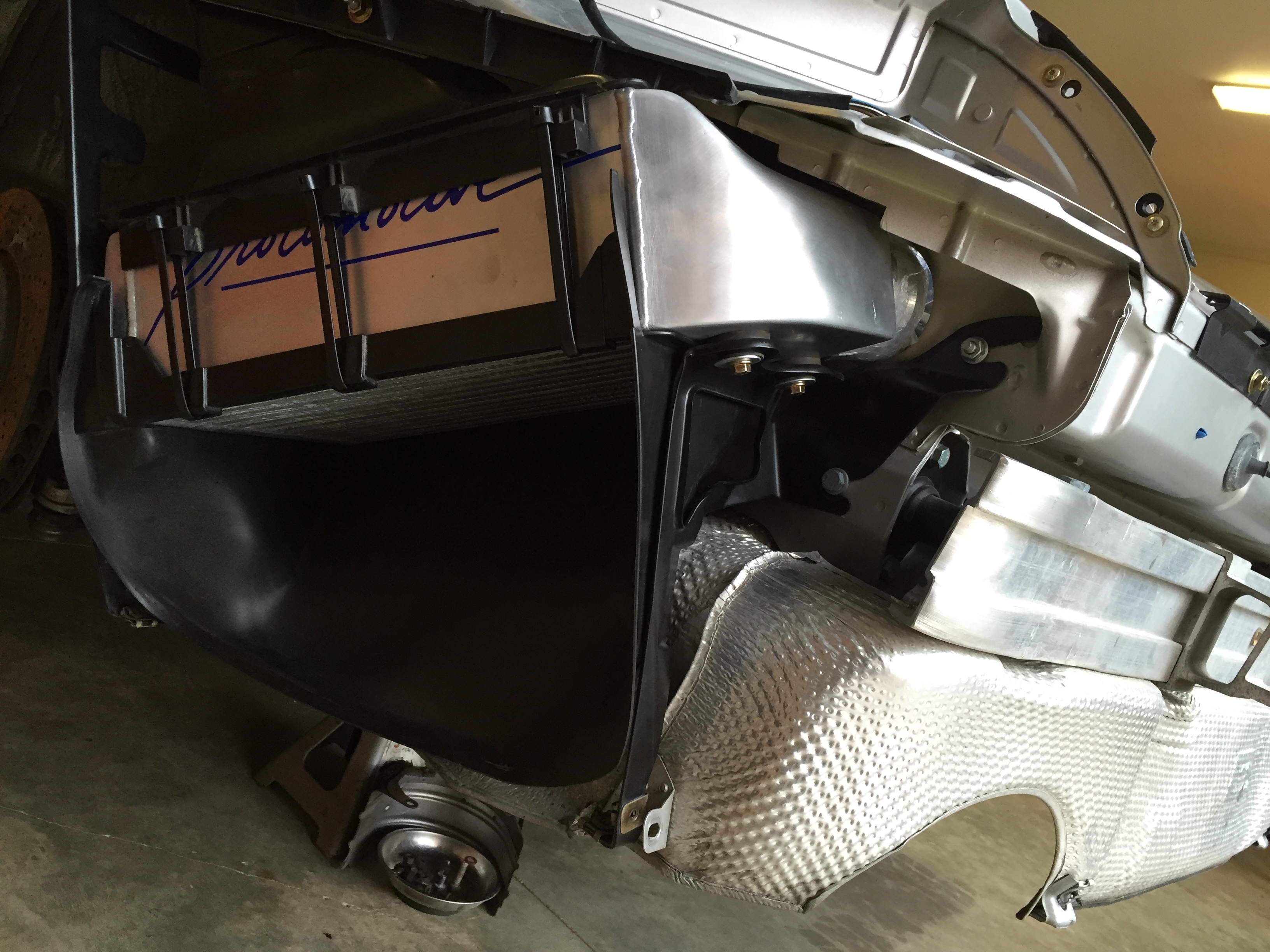

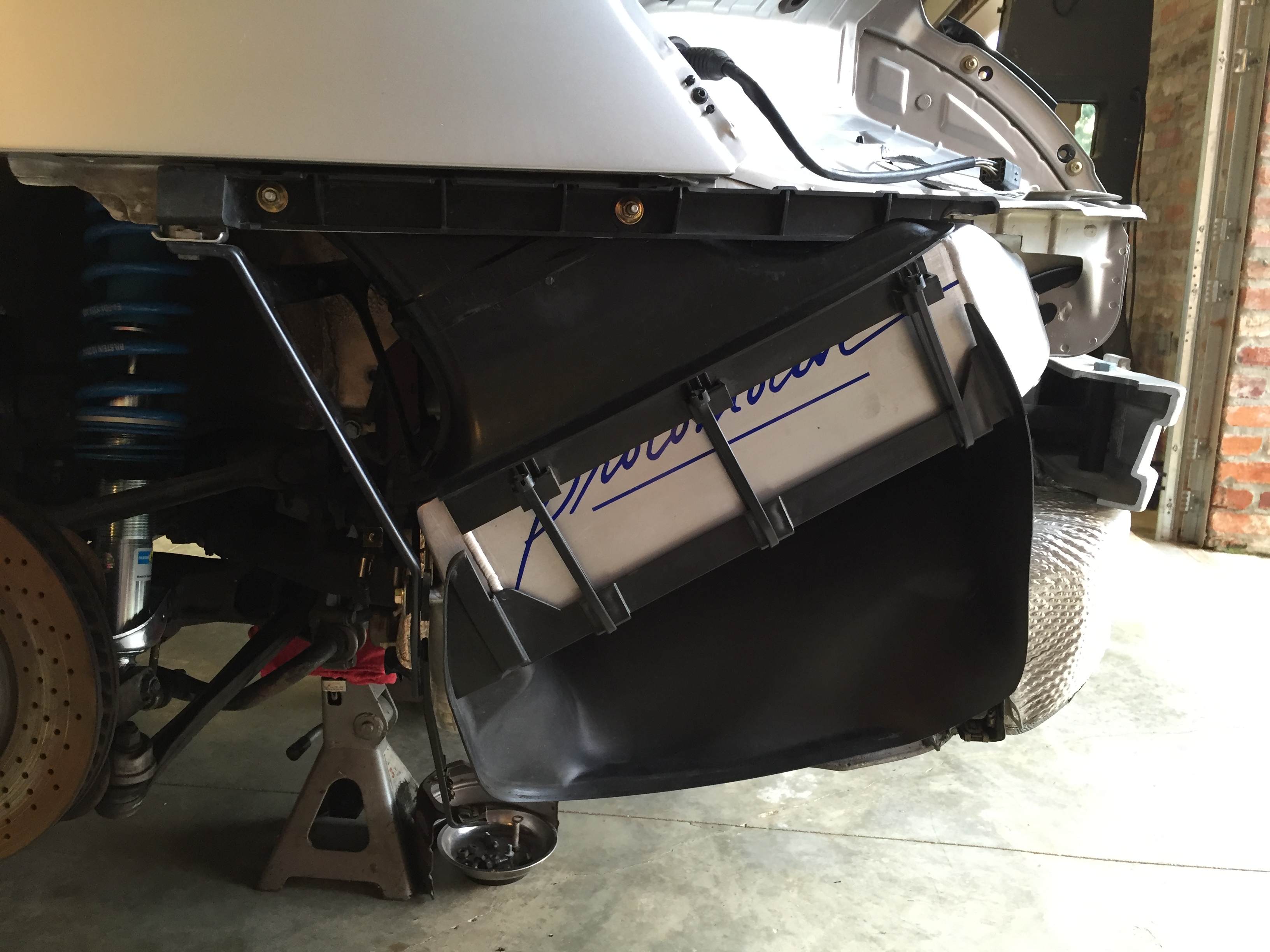

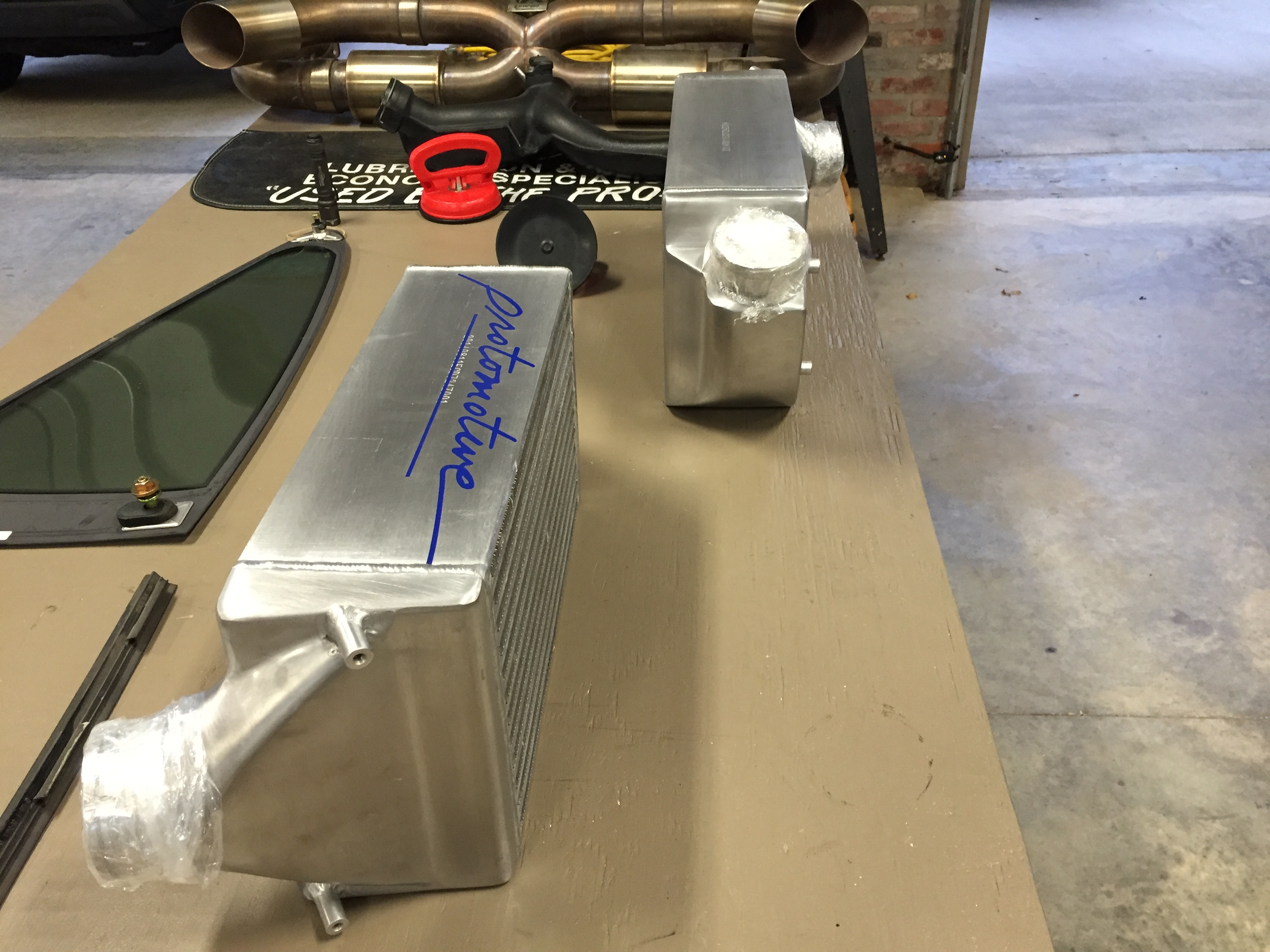

Intercooler Time.... Boy these things are enormous!!!

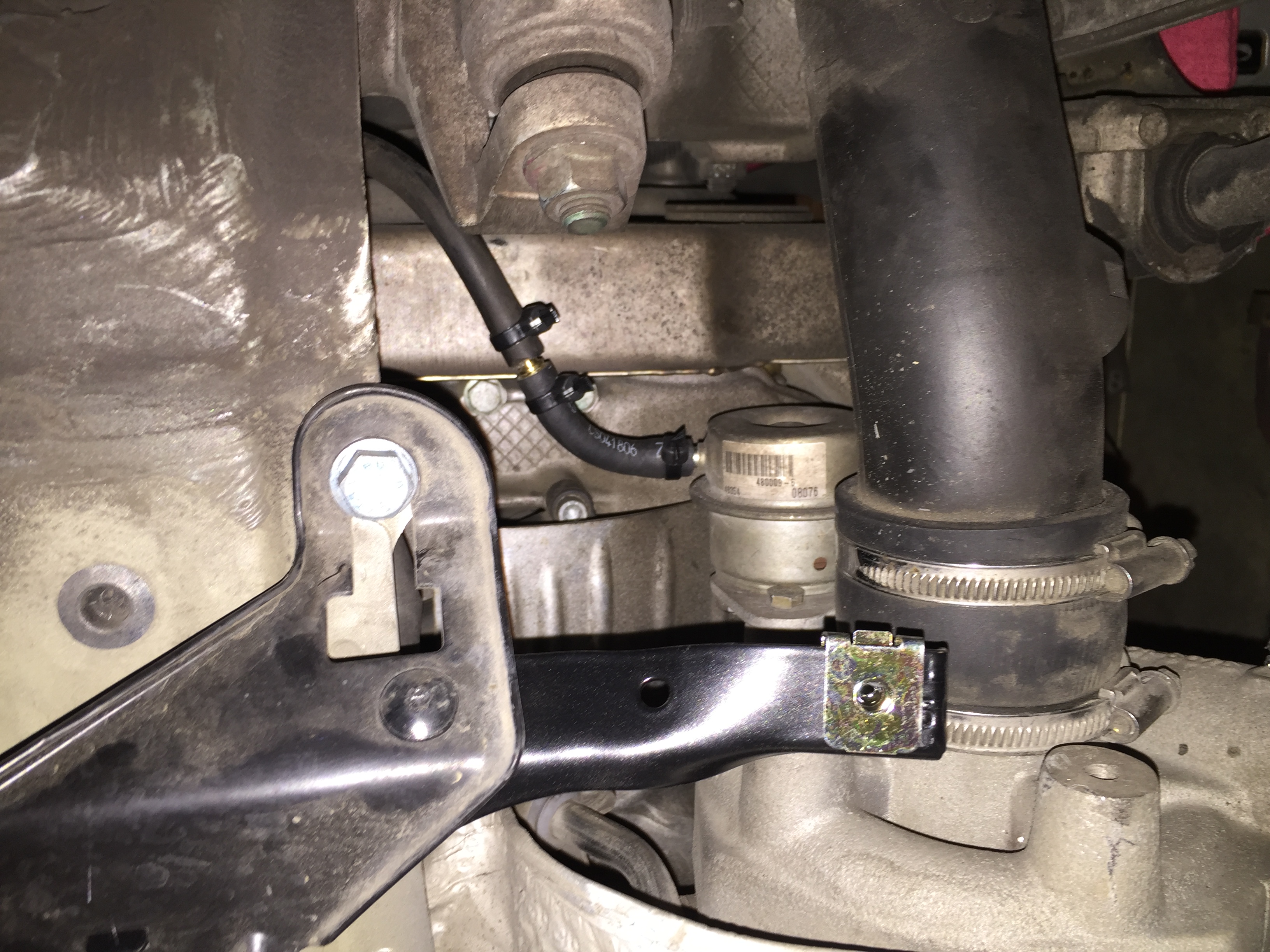

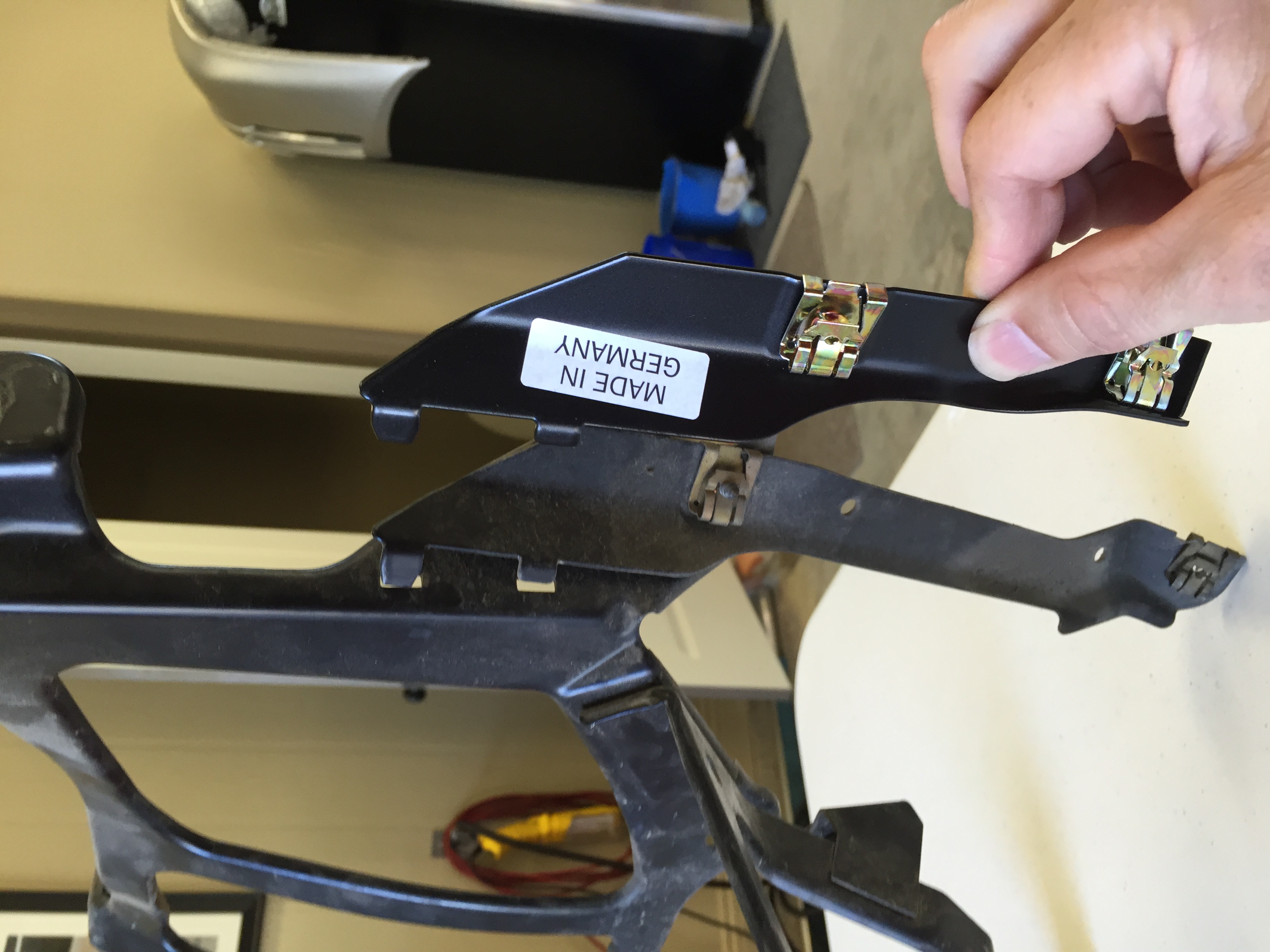

While installing the intercoolers is a good time to install the new GT2 fender liner brackets for a little extra tire clearance. You can see the GT2 bracket is quite a bit shorter than the TT bracket. Notice also I installed brass barb's and zip tied the wastegate lines while I was in the area. I got the barb's at Lowe's of all places.

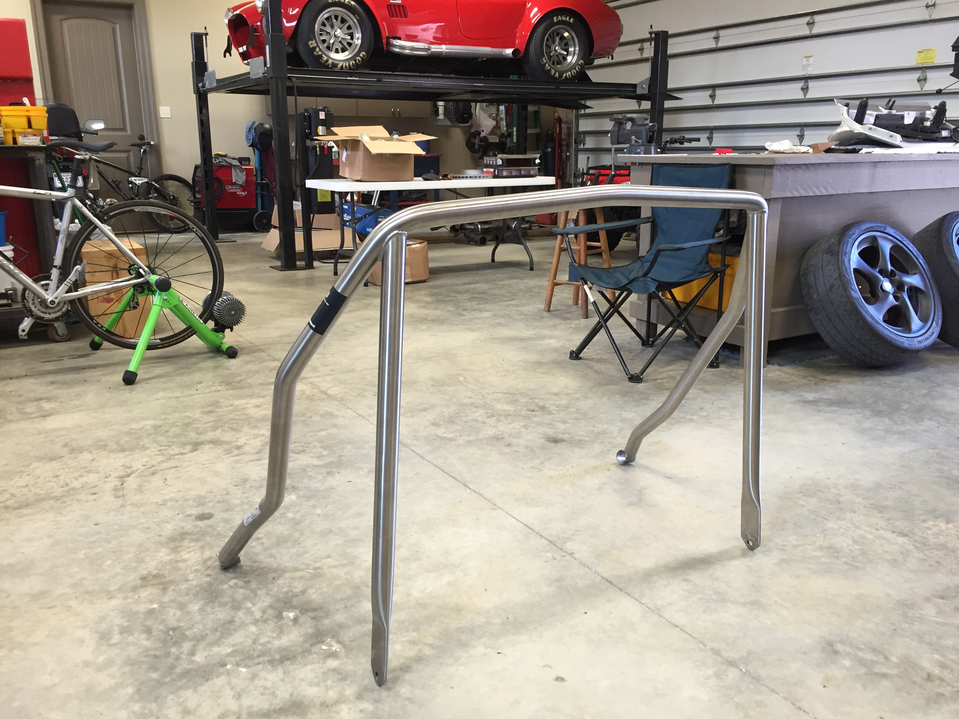

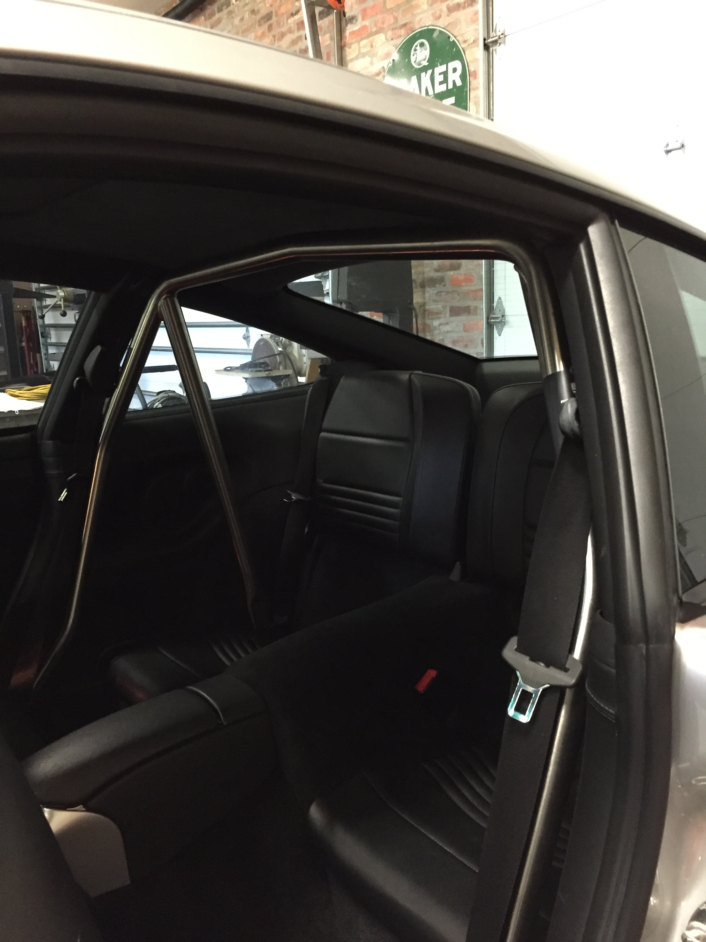

Roll Bar time......

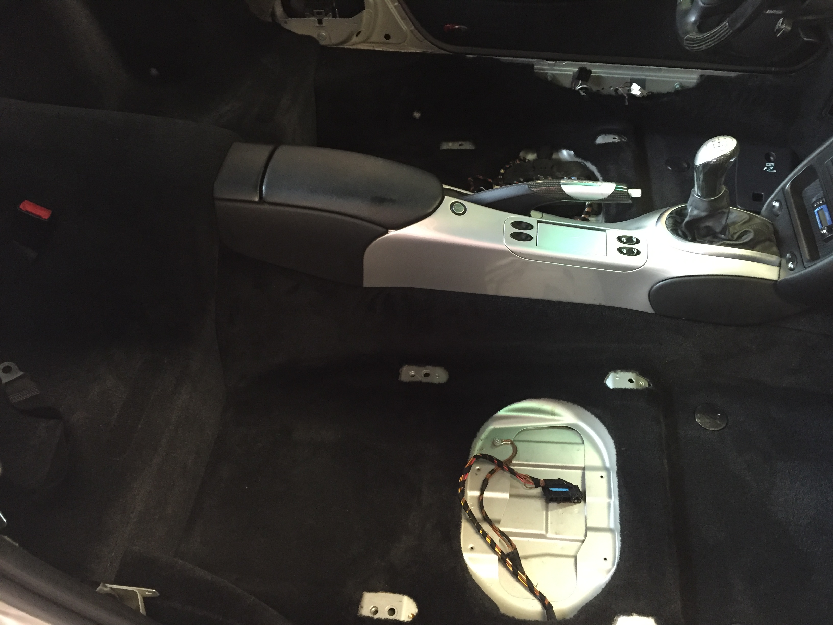

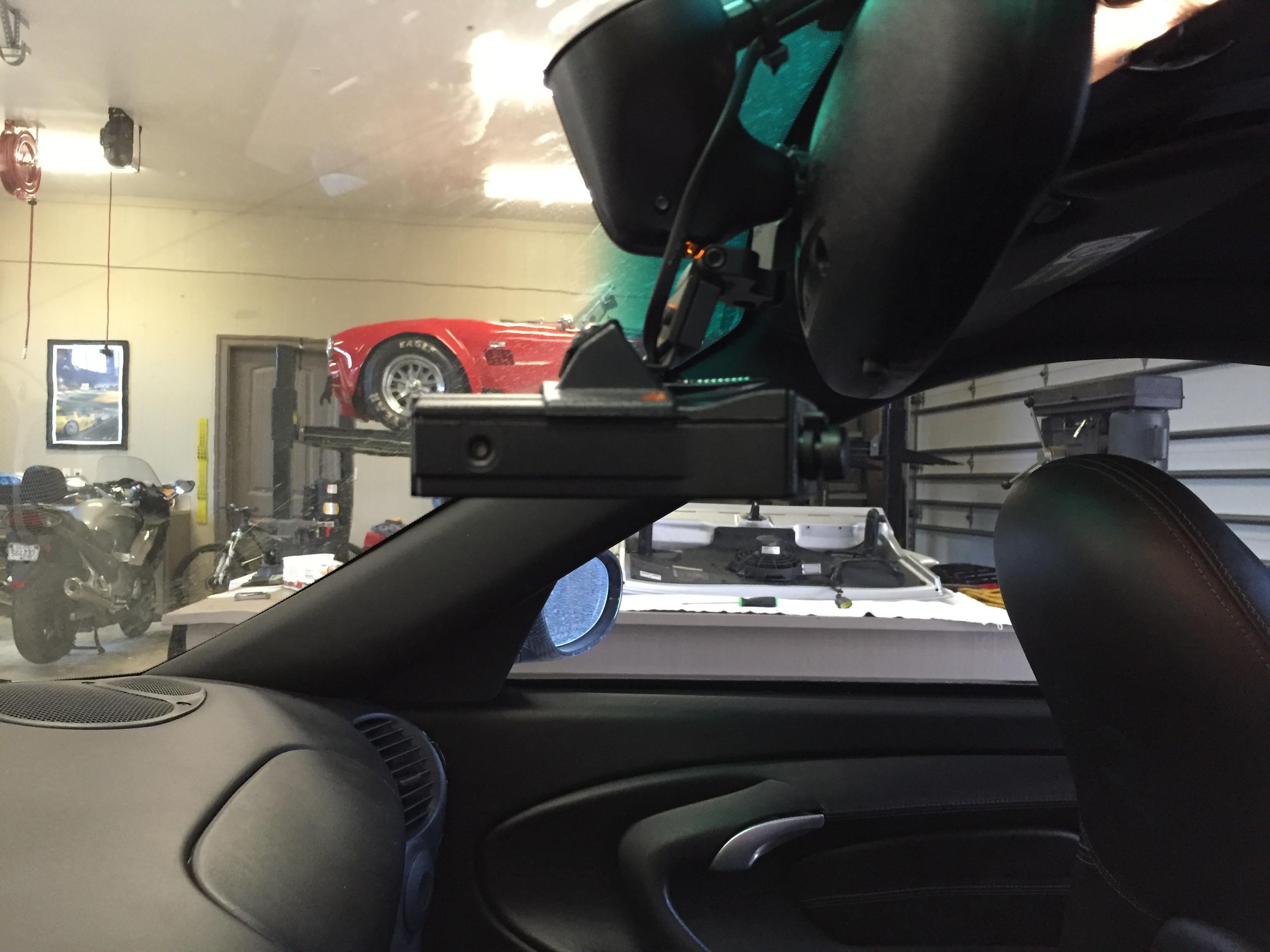

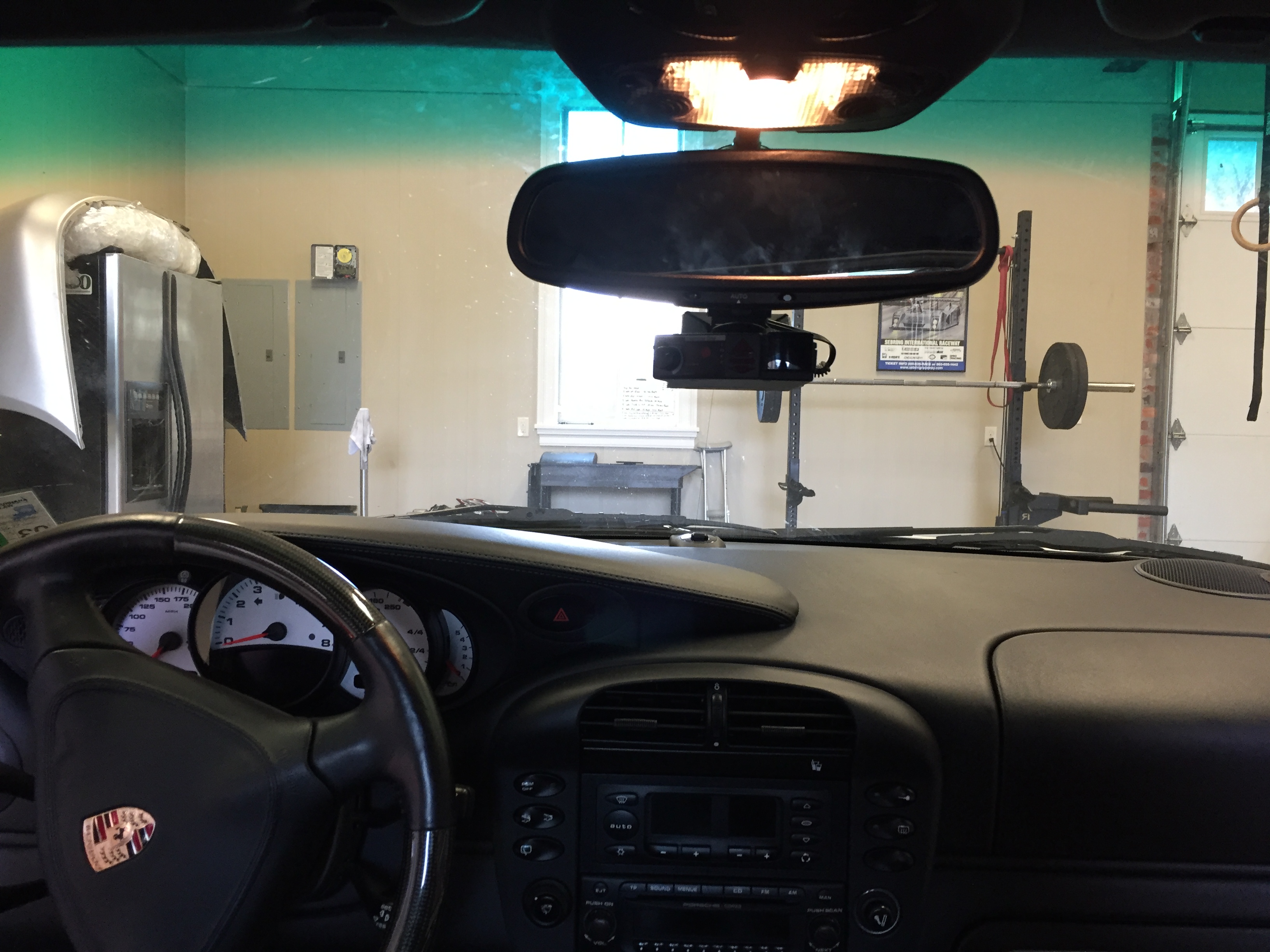

While on the Interior I decided to install a Blendmount rear view mirror bracket for the V1 Radar. We also hardwired the radar to the fuse panel. No messy cords or suction cups.... Thanks to my buddy Martin for helping out with the roll bar an V1 setup.

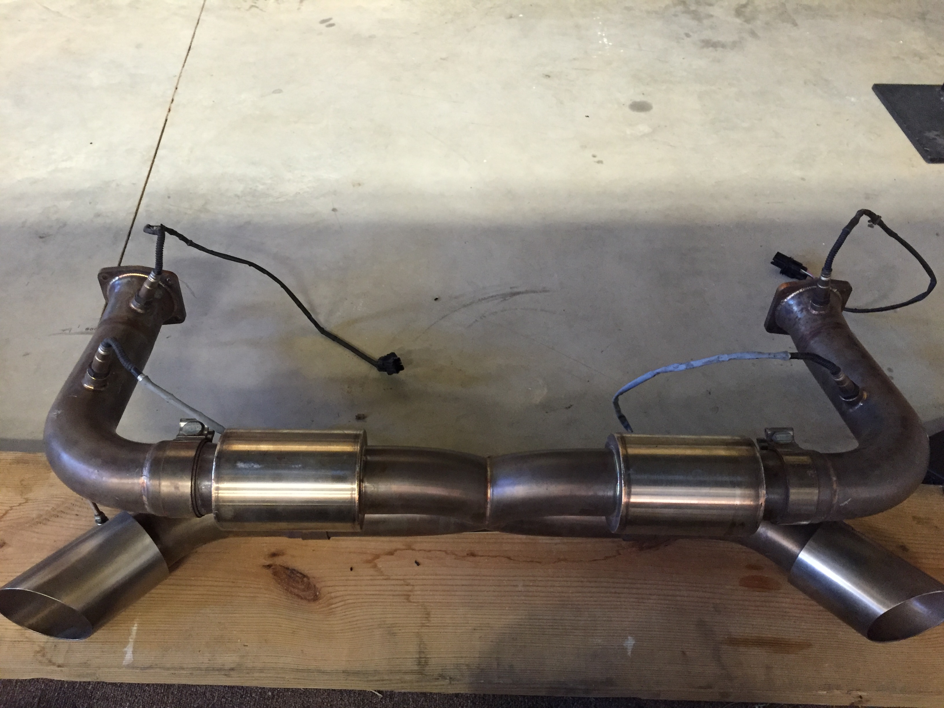

Pulled the old Fabspeed Exhaust off and swapped the 02 sensors on to the new GMG 3" exhaust. Also changed the spark plugs and gapped to .025. Since I bought the exhaust used it did not come with the rear mounting brackets. I am waiting for the brackets to come in from GMG now.

Yes, thanks. It does in fact use T-Bolt clamps in conjunction with two half circle wedge shaped brackets that go between the muffler can and the rear support on the car. Unfortunately, this exhaust does not suck directly up to the rear support like most systems for these cars.
