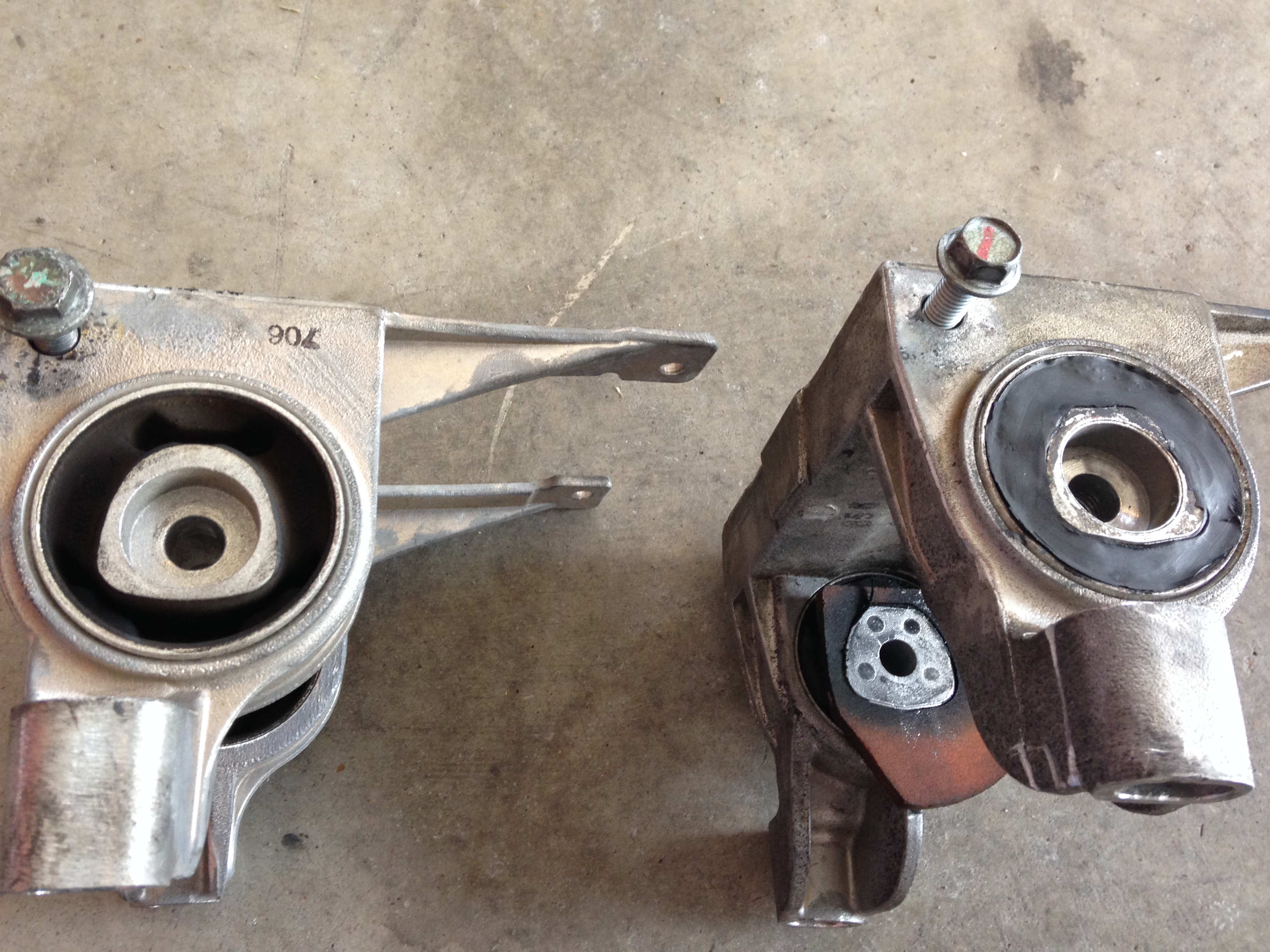

Originally Posted by pwdrhound
The transmission mount inserts make the gearbox noise very loud. No way around it. Stick with a 997 mount..
I run this combo with a 997 trans mount, 964RS engine mounts, Cup shifter/cables, and a lwfw flash that raises idle from 740 to 860. There is virtually no extra audible noise...
Any merit to this "window welding" on the 997 mount? From what I can tell, the 997 is far superior than the 996 so why mess with it if it work is my thinking.
https://www.6speedonline.com/forums/...ml#post4510725
the 997 is doesnt have the windows that the 996 unit has. so it wont get as much benefit from the window weld since it has almost no were to meld into. its more along the lines of making a broken 996 mount more like a 997 mount for pennies on the dollar. of course if the 996 window weld isnt to your liking you can always buy the 997 mount for a few hundred $$. fwiw i run the 996 mount with window weld. 3 yrs and still going. total cost was 20$
I wouldn't mess with the 997 mount. Just install and go. Same mount is used on the 997GT2RS/GT3RS4.0.
I would not window weld your mount.
On another note, I window welded my factory 996 mount before it failed. I scuffed and cleaned the existing rubber and added window weld over the existing rubber. Fast forward to engine removal for a clutch jib and coolant pinning and as soon as the belly pans were removed two transmission sized chunks of window weld fall to the shop floor. The window weld did not adhere well enough to stay. The other sides came off as well when the mount was removed off the transmission.
window weld on my 996tt mount 3 yrs ago still solid as a rock. if the area isnt prepped properly it wont adhere. done right its better than new
We'll see after 4-5 years.
after 3 yrs its more than paid for itself at 20$. if it lasts another 2-3 yrs its just a bonus as it would be considered a wear item and not expected to last forever
I am not saying it isn't worth it for the 3 years and $20. Just saying it is not an alternative to a new mount and will come loose. I think the issue is using window weld over the existing rubber. I properly prepared the mount prior to.
