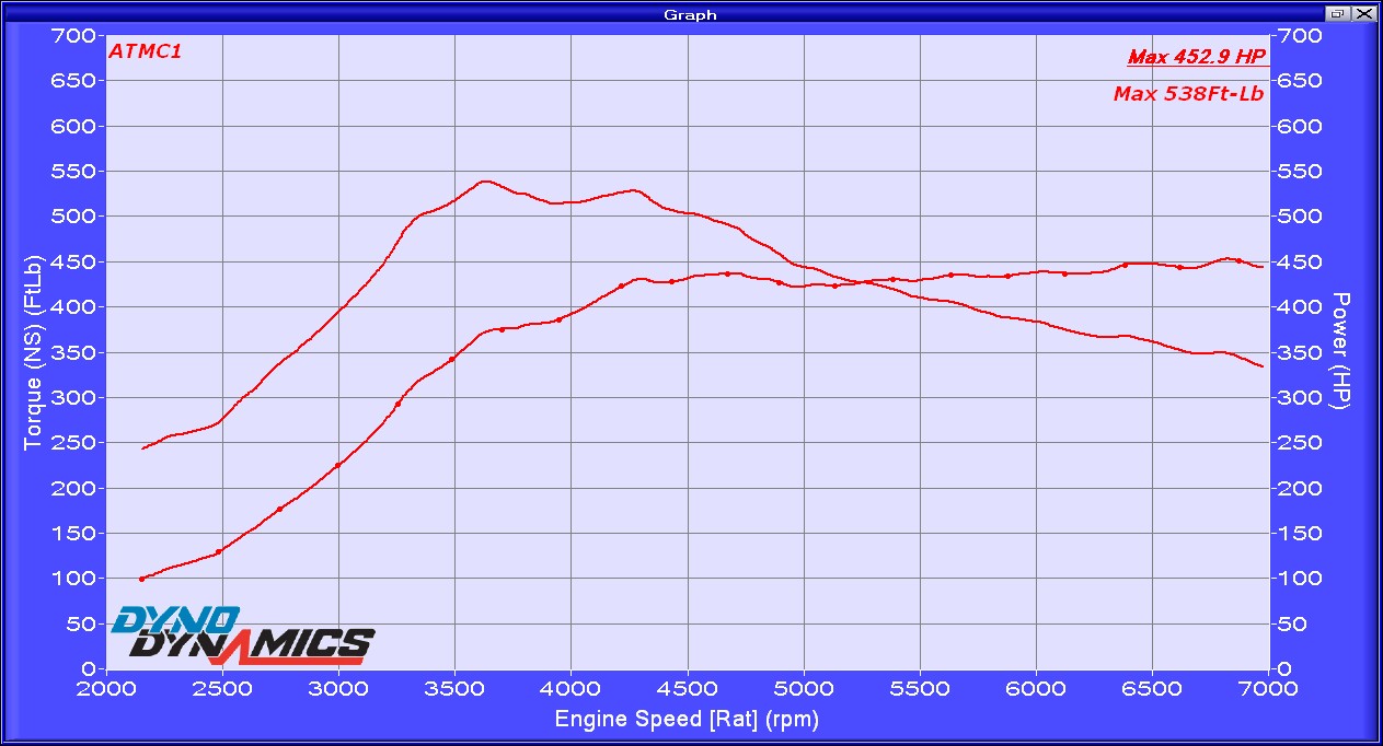

Interesting. Attached is my recent RWD run - EOM k16's and OW 3" catless and UMW tune. It ran out of steam at 4250 where torque falls off and reach a max rwhp of 453.
The suggestion here is the fender well intakes, y pipe w/ external BOV, x pipe style exhaust no cats, maf less removes significant breathing restrictions.
Would those mods allow my stock k16s run to around 5250 with max torque to produce 520rwhp.
Is this overly simplistic ?

Yes, you are oversimplifying it. We don't know what kind of dyno joey996tt ran on and we also don't know if he was running AWD or RWD and on what fuel.
Breathing mods won't move your max torque to the right (which you really don't want anyway). What they will do is cause the torque to hold on longer or fall off more slowly therefore making more HP up top.
450rwhp is fantastic on a Dyno Dynamics for your mods. They are typically heart breaker dynos.

Ok, I will re-word my question as I intended to ask:
My car, same fuel, on the same dyno, same operator + the intake mods discussed here.
Will my existing torque on the dyno chart hold on longer (fall off more slowly) and make 520rwhp from 4250 to 7000 where I'm making 450 rwhp from 4250 to 7000 ?

You'd make more power. How much exactly I won't speculate until Joey posts a dyno sheet.
