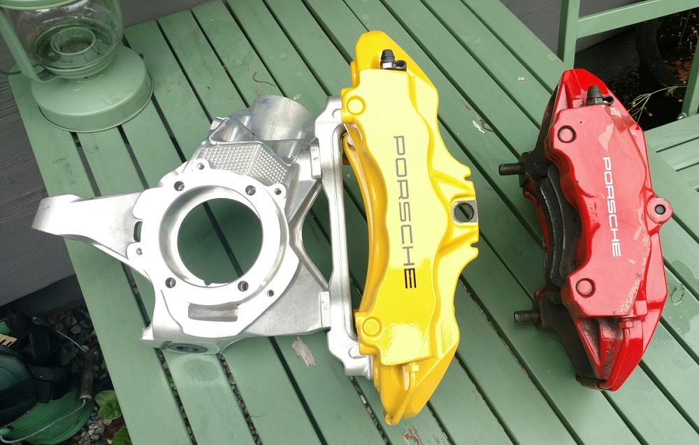

I am currently undergoing changing mine over to 997 cup car brakes. using cup car calipers and girodisc rotors. changing my master cylinder as well. you need adapter brackets for the calipers to for the tt front uprights but they are a porsche oem part if using tt hat offsets. they are a 380/350 setup. I will have about 3k into the change but I got used calipers and rotors.

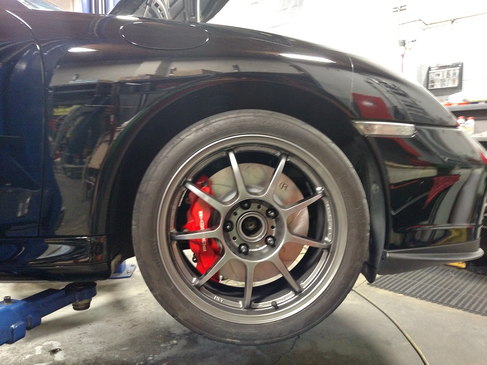

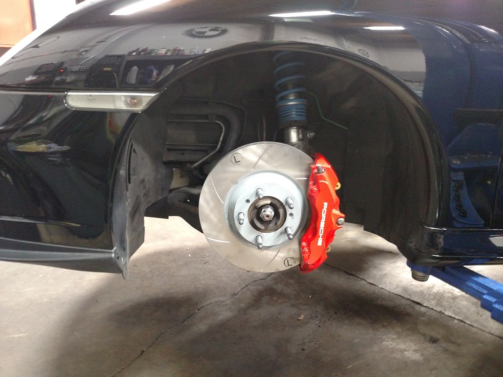

Last spring I went to 997.1 GT-3 brake calipers with 997 turbo rotors, OE rear and Sebro front w/RS29 pads. Use car whenever it's dry and hit the track for lunch hour most weeks in the summer and get in a few other half days too.
Compared to stock, the pedal feel is a little less grabby/responsive, partially due to performance pads and not swapping to the GT3 MC. Way more powerful braking when pushing it with less fade at the track and much quicker slowing when doing something like 130>60mph. Using a pair of front 996 GT2 ducts on the LCA's.
Stock hollow twists, 18' Allegrita & Forgestar F14 all fit fine but I ditched them all for some Finspeed 18" because I'm swapping to the 380 setup below.
Leaving the stock turbo MC in place for now to see how the feel is and because some have mentioned less ABS issues. Have the GT3 part on the shelf in case I don't like the feel and ABS issues vs feel is worth the swap.
