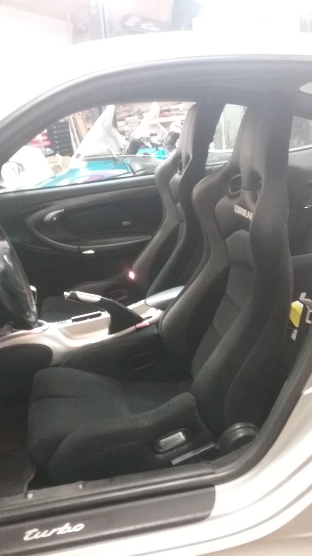

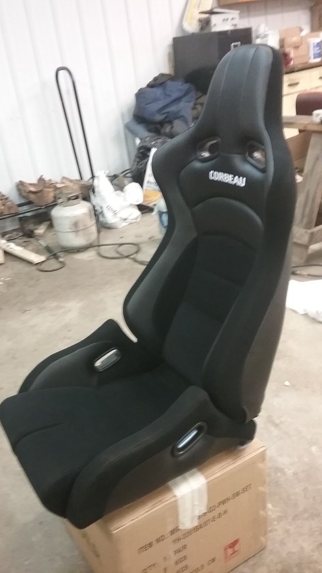

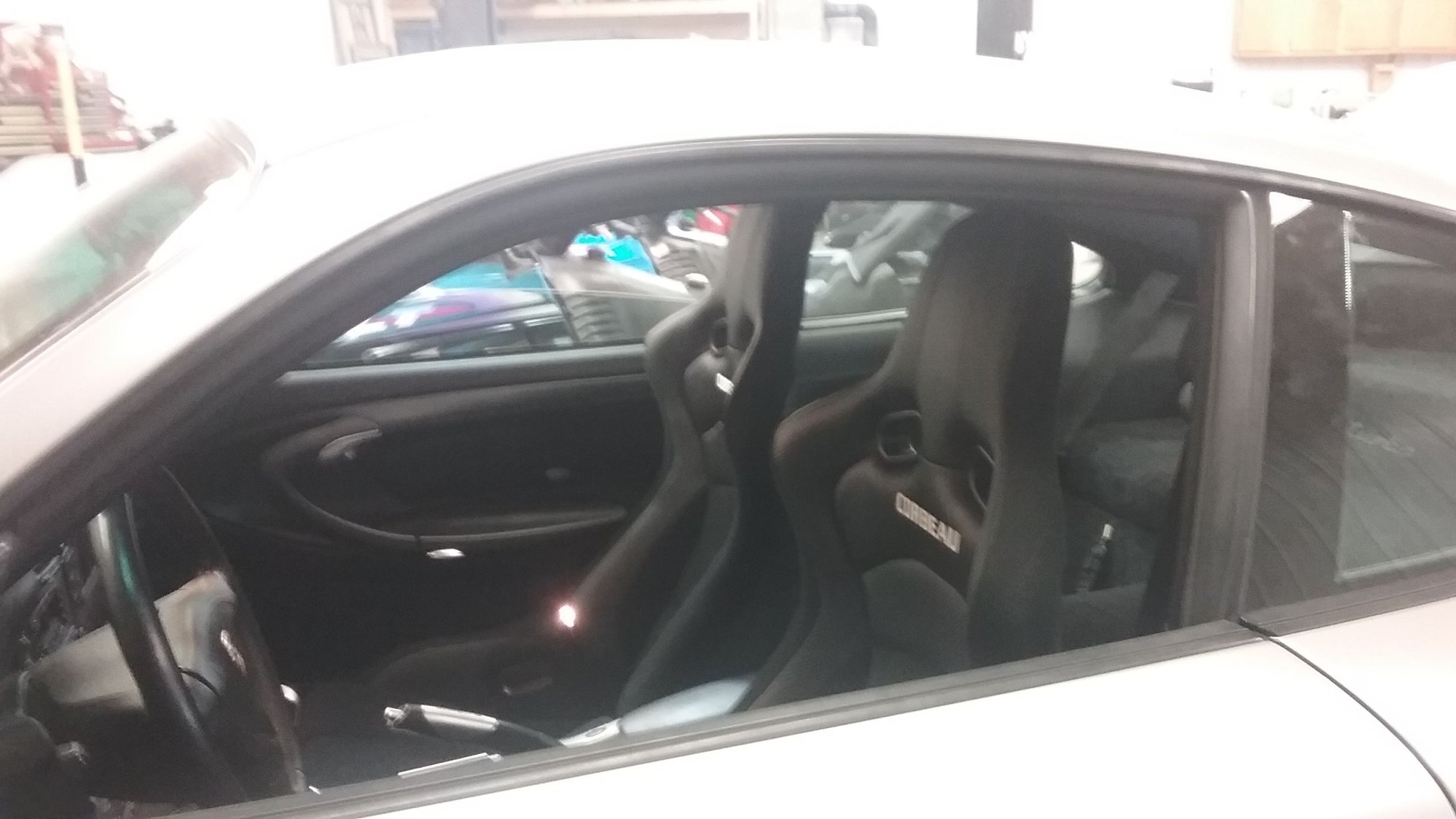

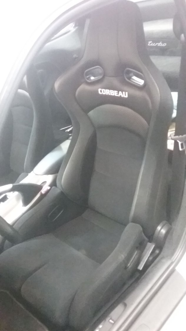

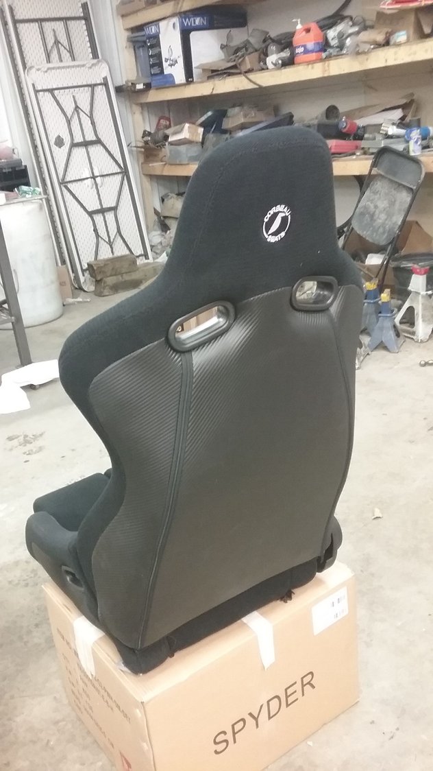

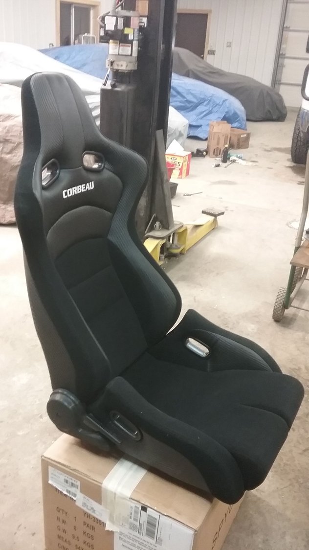

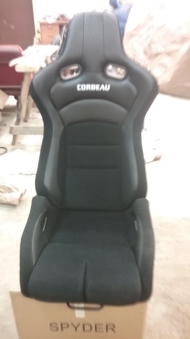

Well yesterday I finally put my corbeau rrb seats in my car. They are a reclining full bucket. I used planted mounts. Besides a litre modding with a steel bushing and bolt for the seat belt latch, it bolted right in. Much more comfortable than the stock comfort seats and the support they have is 1000 times better. Very happy with them and will have them in the car until at some point it turns full race car. At that point it will get a full cage and fia buckets. Roll bar and harnesses will be added as well for autox and club track days.

How well does the lap belt hold you down? Seems like it buckles over the bolster and not through the holes in the seat? How much room between the bolsters? I'd love something supportive but end up on top of the bolsters rather than between them :-(

no way of fitting in in the hole. Holds you down fine though. The gt2 and gt3 seats are similar where the latch is at the top of the bolster height wise. I'll measure with for ya her. I can tell you it's not a far mans seat though. I'm a pretty small guy and it coasy even for me.

Bolster to bolster on the seat is 15 inches.

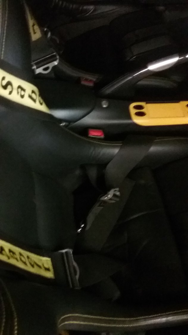

The proper way to do it is to route the 3pt. seatbelt through the left seat hole exactly as is done on the OEM EURO 6GT3 seat. Very easy to do. The seatbelt will clip in to the buckle above the right seat bolster, again exactly as is done on the OEM seat.
On this seat the side bolsters are low enough that they will be below the level of the hips and I don't believe you would have any issues simply routing the seatbelt over the seat as Freddy is doing without looping it through the hole on the left side.

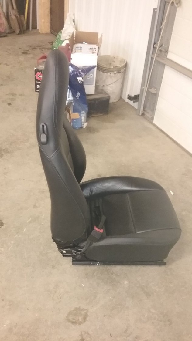

Here is what the 6gt3 seat is like since Chris car is at my shop to look at.

Here is the seat belt routing straight out the the Porsche 6GT3 Clubsport brochure. Obviously on the Corbeau seats you would not be able to route it through the upper hoops.

O I will be putting it through the lower hoop on the non latch side yes. Got confused on that one. Just have not done it yet

look at the corbeau lg1. it has a much lower bolster to allow for bigger folks. and think that porsche secures people in the car by a bolt thats attached to the seat!! should the seat fail whats holding you in? all seatbelt attachment points should be secured to the floor pan independent of the seat. first car i have ever seen this on
