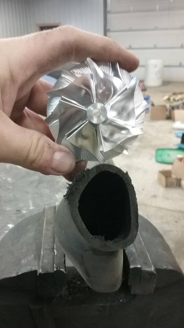

on stock turbos John this is 100% true. 2.5 inch piping has enough to flow more than needed from stock side turbo and not have issues with the added length the air has to travel through the tubes. With large turbos like billet 20g or 3071 3076 you might see a little bit of a difference between 2.5 inch tubing and filters direct of turbos.
biggest thing is to get rid of the super restrictive stock tubing. 2.5 inch piping literally had double the flow area over the stock piping.

very nice. Ya 2x 2.5 inch pipes can move a lot of air. Like said the biggest thing is just getting rid of the stock piping. Filters on turbo is just an easier option for some guys.
stock piping in places are legitimately is about 1.25. Tiny. This comp wheel is a 47.5mm inducer side so that 1.87.
