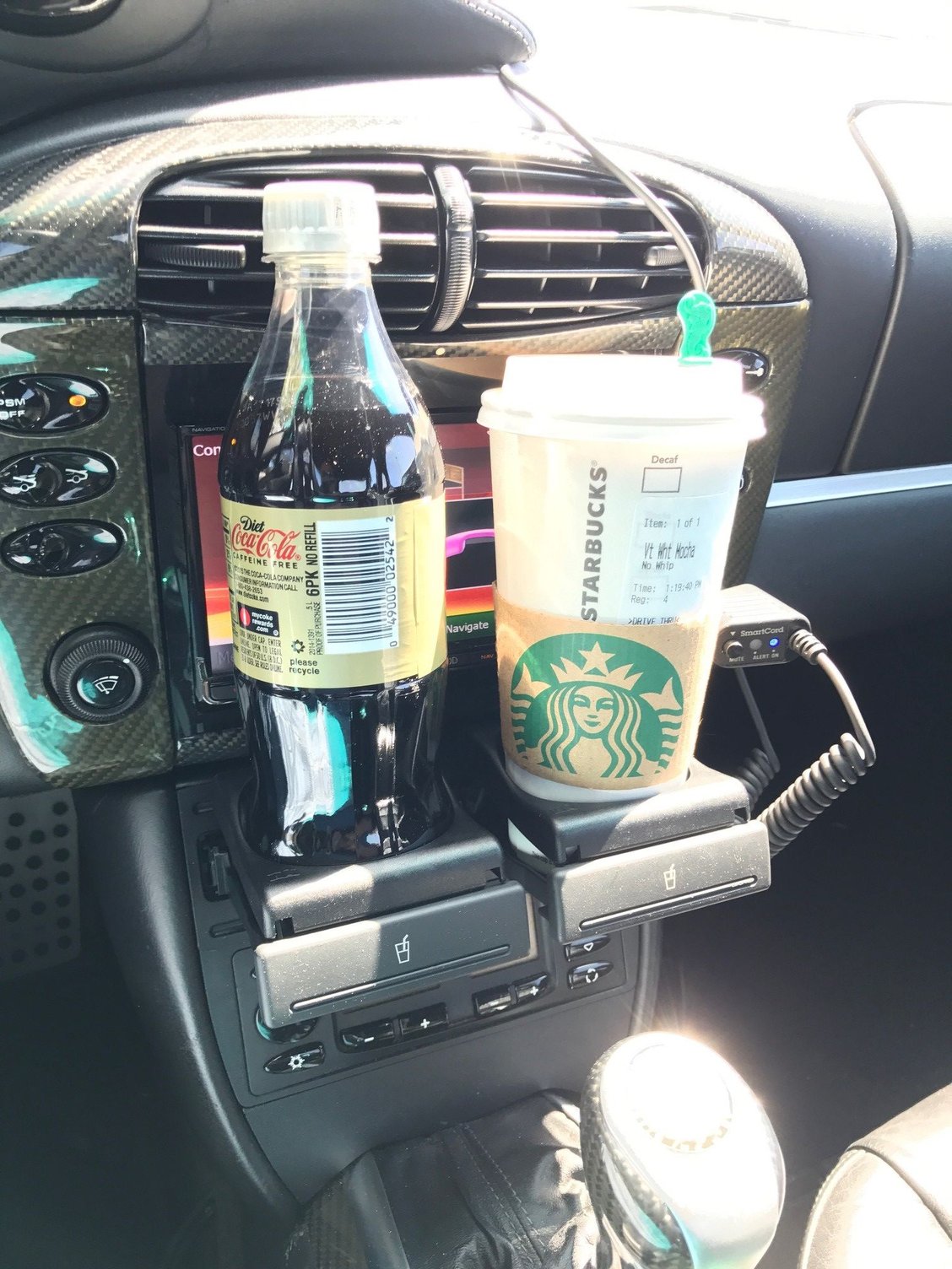

I mounted the stock cup holders. I like it, but it was a royal PITA. The lower opening is smaller than the upper opening, so you have to cut the face plate smaller and make a custom bracket to hold the two cup holder cartridges.
The angle isn't great, but it works.

Hey - That looks good! Do you have a pic of them with cups in them?
No picture, but I'll try to take one.
Later, Steve

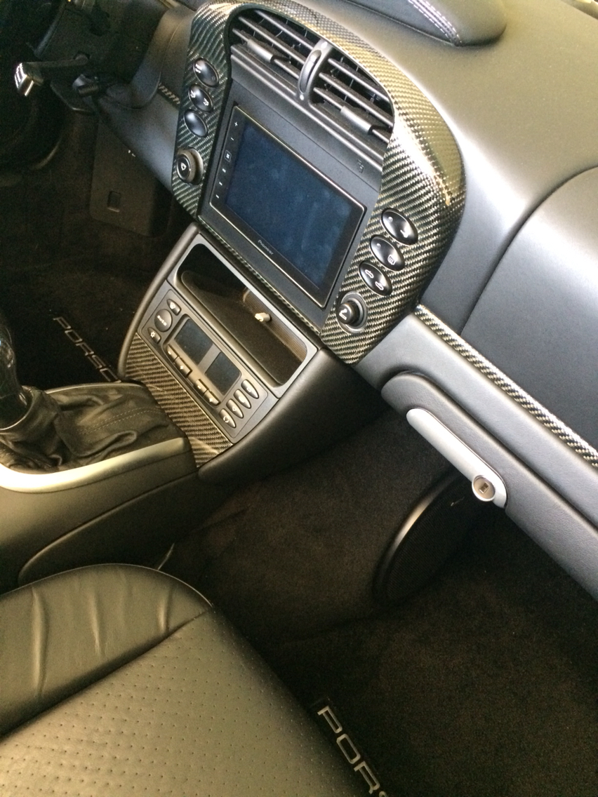

jdexter is a splendid one to beholdjdexter is a splendid one to beholdjdexter is a splendid one to beholdjdexter is a splendid one to beholdjdexter is a splendid one to beholdjdexter is a splendid one to beholdjdexter is a splendid one to behold
I did an ipad retrofit. I think it looks pretty good, and is very functional. Waze ftw.

Better late than never.

Slider Is a GOD !Slider Is a GOD !Slider Is a GOD !Slider Is a GOD !Slider Is a GOD !Slider Is a GOD !Slider Is a GOD !Slider Is a GOD !Slider Is a GOD !Slider Is a GOD !Slider Is a GOD !
Thanks - that looks pretty functional although it does block access to the radio and climate... I'll have to think about that one...

Definitely not optimal, but better then nothing. The head unit is usually not an issue, because there are rarely two drinks in the cup holders. The climate control is also no issue, because I set a temperature and never touch it.
The bigger annoyances are that they are still tilted toward the head unit and it's a little close to the hand when shifting. The worst thing is the installation is a PITA. Trust me when I say you have to completely fabricate the bracket that is holding the drink holder cartridges. Also, the back of the cartridges have to be tilted up as far as possible to help reduce the angle when they open.

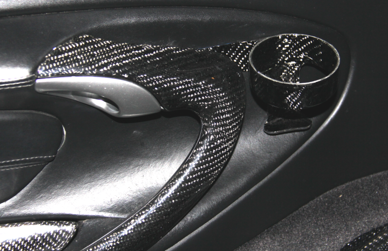

I struggled to find the best place for a cup holder in our cars and settled with this. It's out of the way and does not interfere with anything, but I'm always looking to see if anyone comes up with a better place.

And it's nowhere near any electronics.
Steve, it looks well executed, but I'd be very wary of liquid in paper cups that close to $$$...
