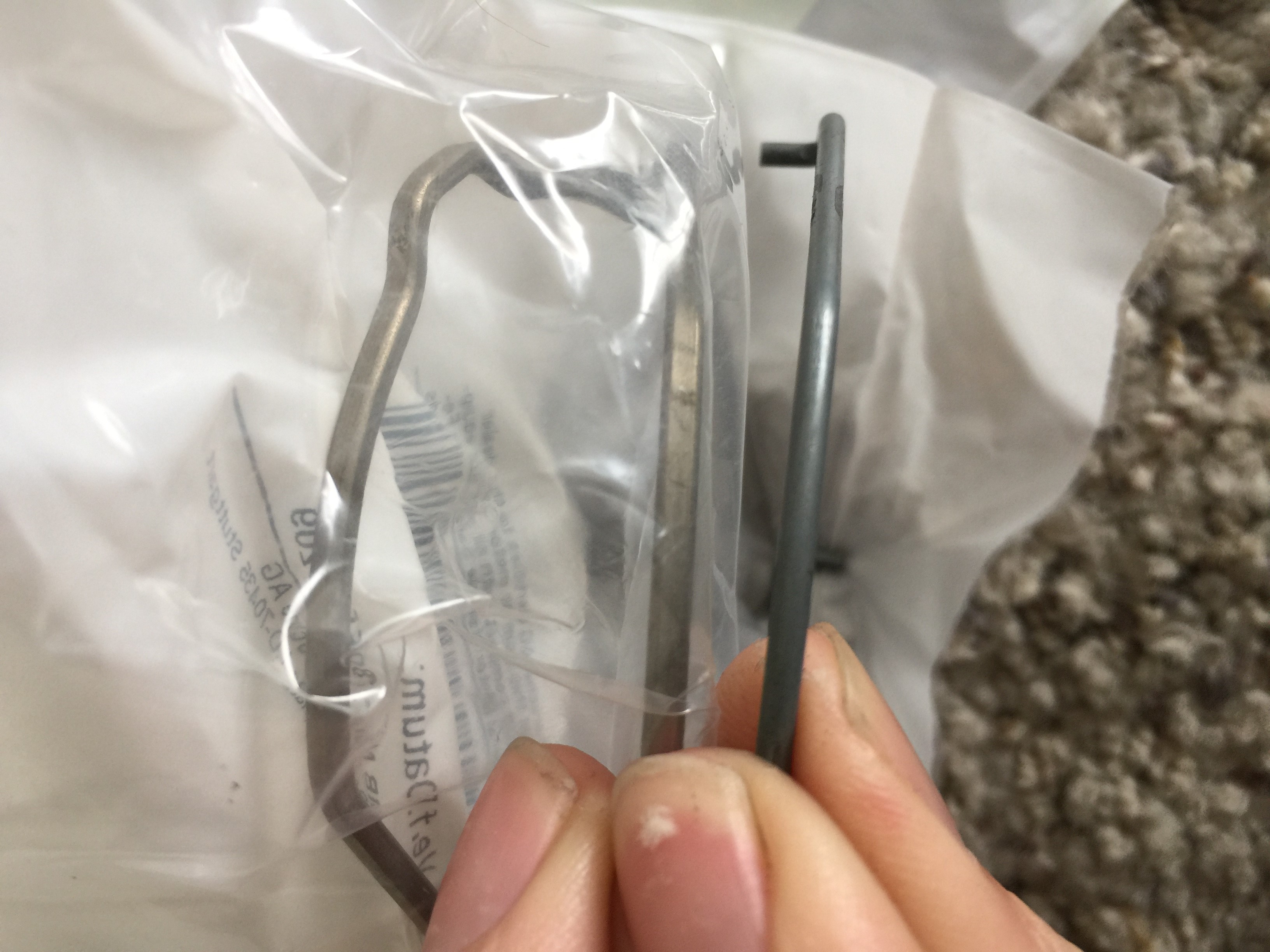

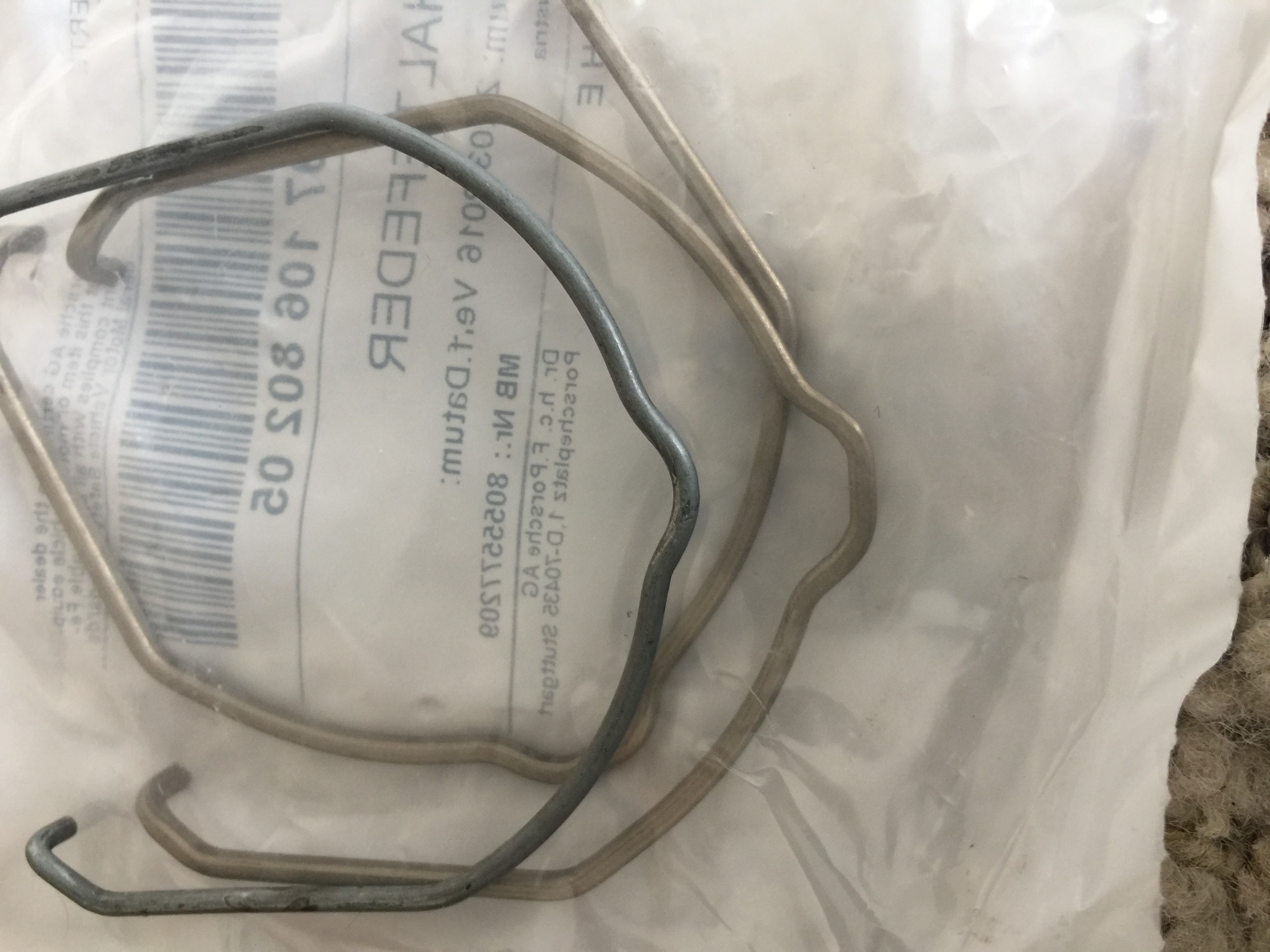

Hairspray dries sticky, helps it hold. If you aren't taking the bumper off the car to fit the hose back in, try that as well so you can make sure it is fully seated from all sides.
Try the redesigned clamps if you don't have them... It solved all of my problems with boost hose popping out.. The ones in the bag are the redesigned clamps...
I will try them. I can see how they would be better. Where is the quickest place to buy? I use Pelican Parts normally, but their ship times are horrible. I wouldn't even get them until May 3rd using priority.

Yes, as SeattleTurbo said, it dries sticky and is a temporary "glue". Sometimes it's just enough to keep them seated. The new clips are also key though. The squarish profile is much better at keeping the hoses in place.
