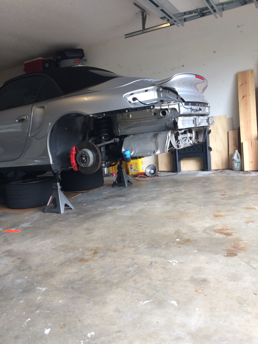

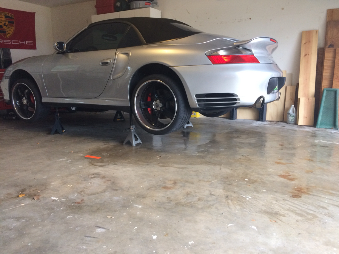

It has begun!
I'm going to take my time working on it. I'll try to keep this post up to date, especially if I run across anything interesting or unusual. Thanks for the support. Click image for larger version

Careful. I put a big wood stump under the car as a safety precaution. Don't trust those stands, have a backup.

You can lift it higher once the motor is out, it will be light.

Originally Posted by 32krazy!
thats not high enough to get the motor out. change them to 6000 lb truck stands
You're totally right. The stands in the rear are almost maxed out and the bottom of the engine case is only about 18" from the floor, i.e. not high enough... I will be swapping them for taller ones. Good looking out.

I do it with the lower stands. Once the motor is out you just take your floor jack and lift the back higher, drag the motor and trans out, then set it back down on the stands.
its much safer to use truck stands and use either concrete blocks or wood to crib the front wheels when the motor is released. or do like i did and get a maxjax. it pays for itself in safety and ease of getting the car in the air. if anyone plans on keeping a porsche and forking on it in your garage its a win win and the best mod you can have

I take my wheels off and put them under the car as a safety measure. They are wider than i am.

Lookup wood cribbing, it's not hard to make, it's cheap, and it's safe. You can use it under the jackstands and lower the extensions so it's not too wobbly. Under the front wheels is a good place for it too and built right the cribbing can be stacked so you can raise the car high slowly. You're probably going to want to use an HF hydraulic to drop the motor and to get it in there is going to require a bunch of height.
I second placing wheels under the car too! I do this on all cars when I yank a wheel so if a jack or stand slips the wheel prevents a crush.

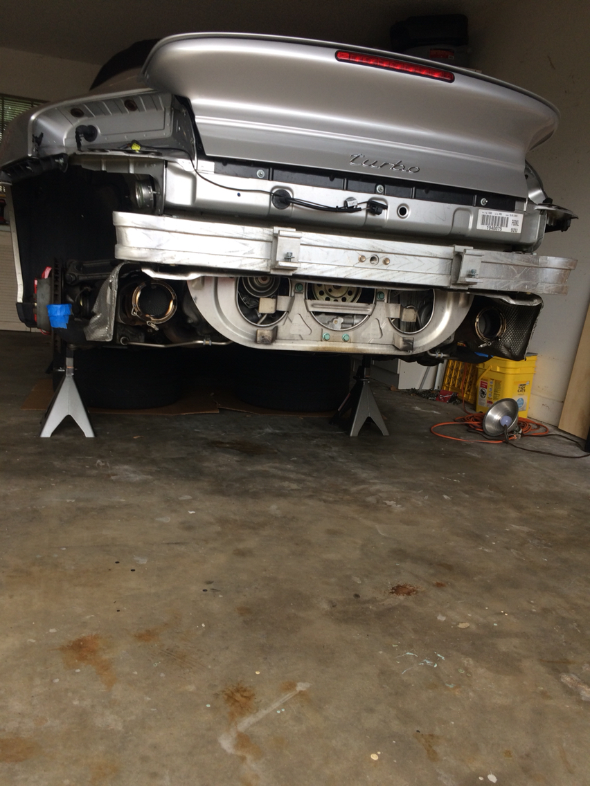

Sorry about your initial issue but I like where this thread is going. Lots of good tips already. Tires under the car is a great one. I'm always nervous about the stands failing when I'm under my car and pulling on something with a wrench. Can you imaging getting killed by your Porsche while not even driving it?

Prep work...Click image for larger version
