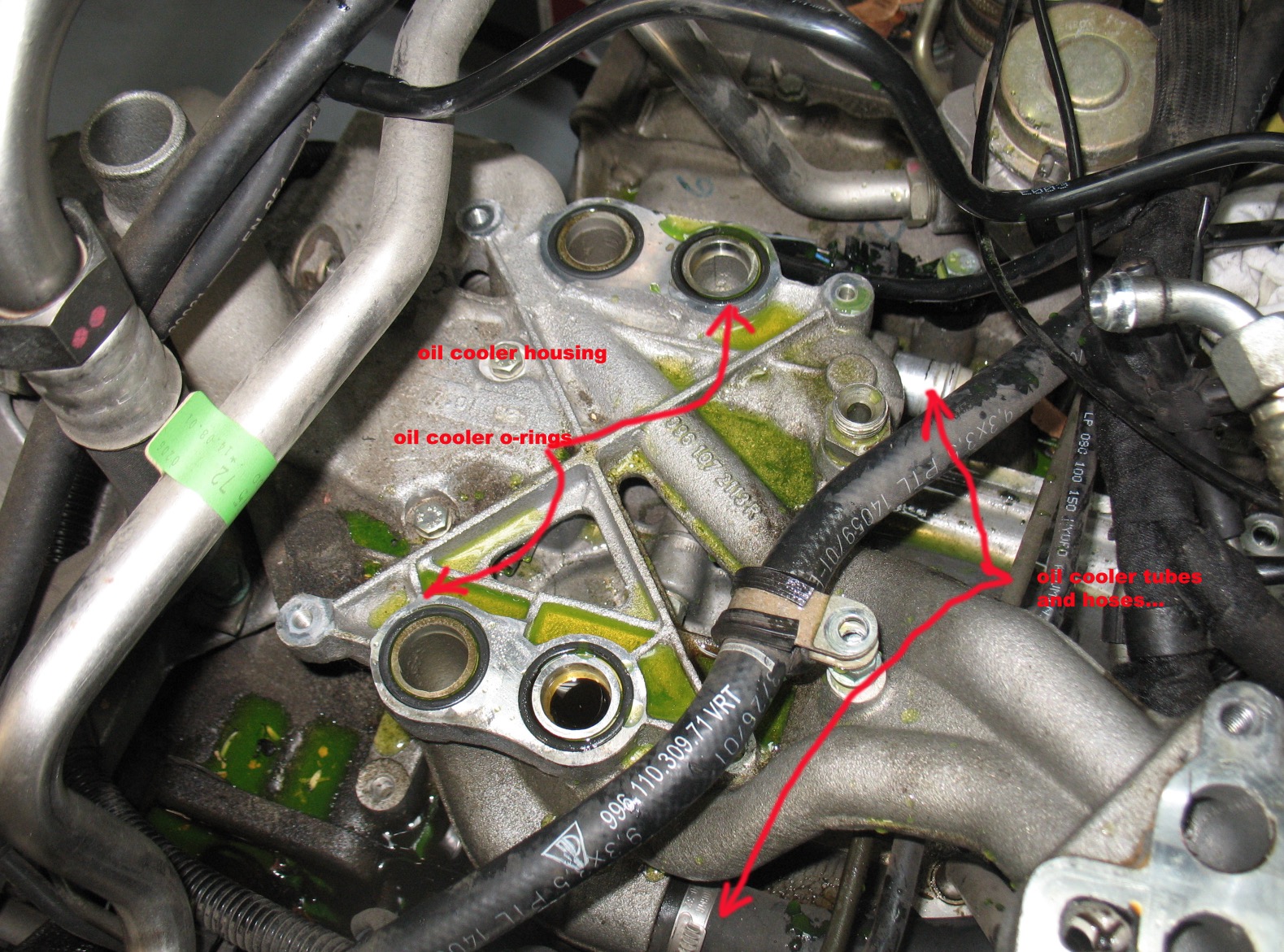

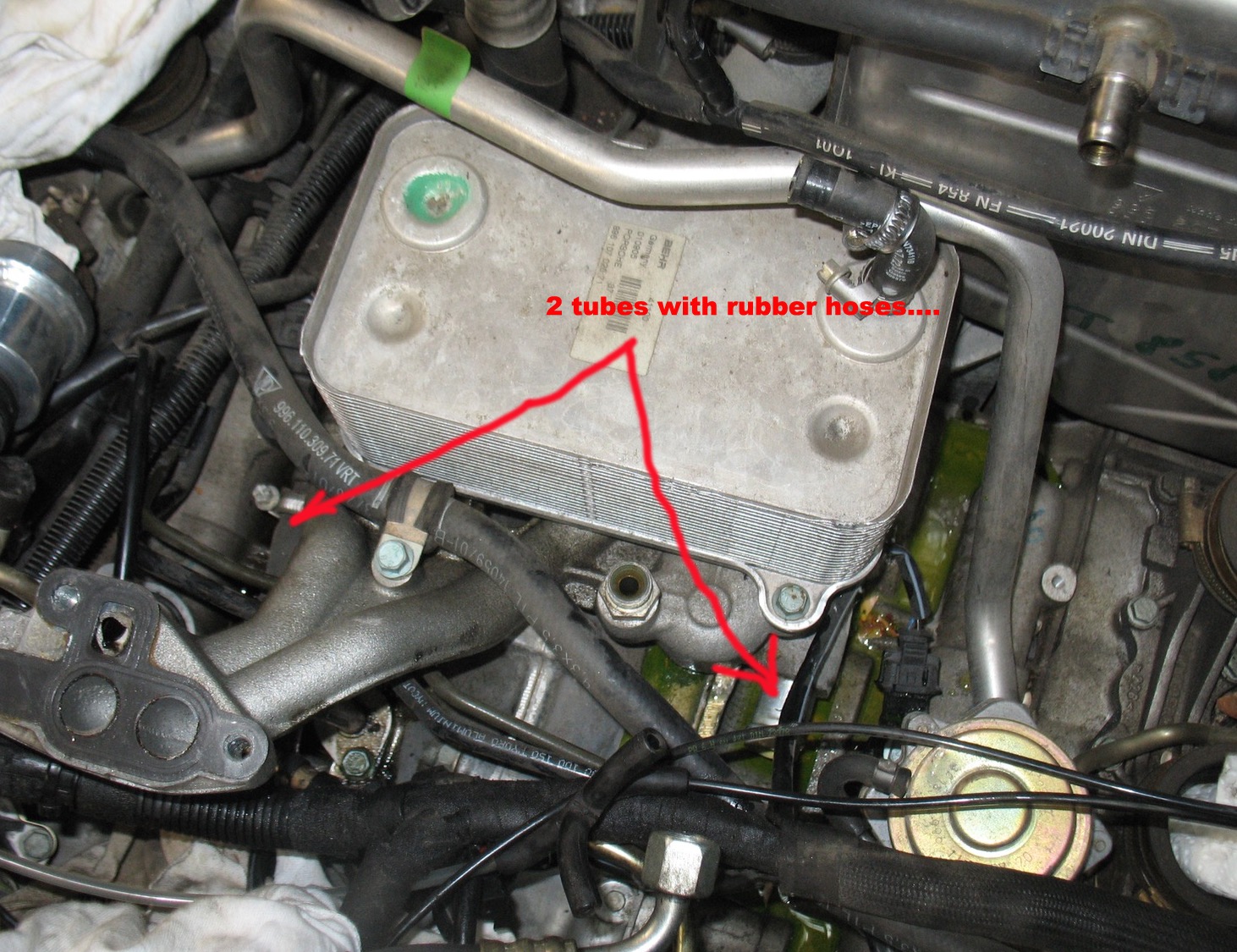

This is what you will see under the intake and these are possibilities of leaks.... You got two glued tubes, 2 hoses going to them and two o-rings between the cooler and the cooler housing (of course you got other o-rings for the oil....)

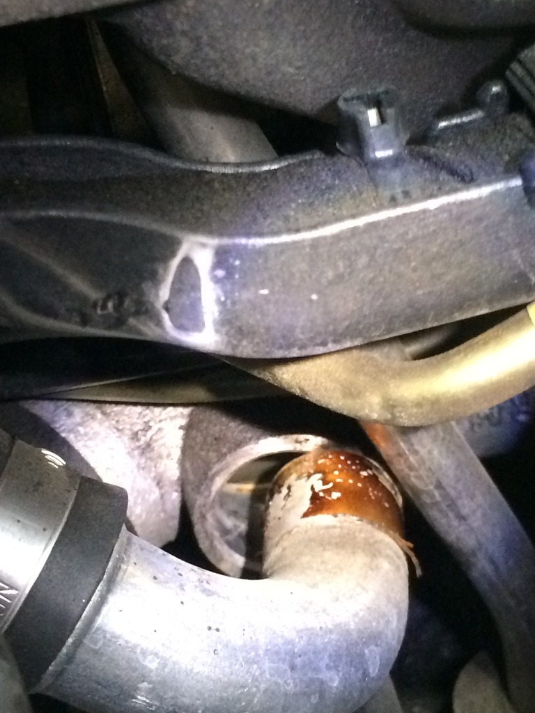

It wasn't major like yours. The liquid was staying on top of the block and eventually evaporate.... The pipe did not pop out because it is in a tight location with a short hose holding it...But I had a strong smell of coolant...Just a little note, I took out the engine to weld the pipes, all the pipes on the water pump housing where easy to remove. The glue did not hold any of them. The one on the steering pump housing was also easy to remove but the ones on the oil cooler where really hard and I can say they were glued properly.....

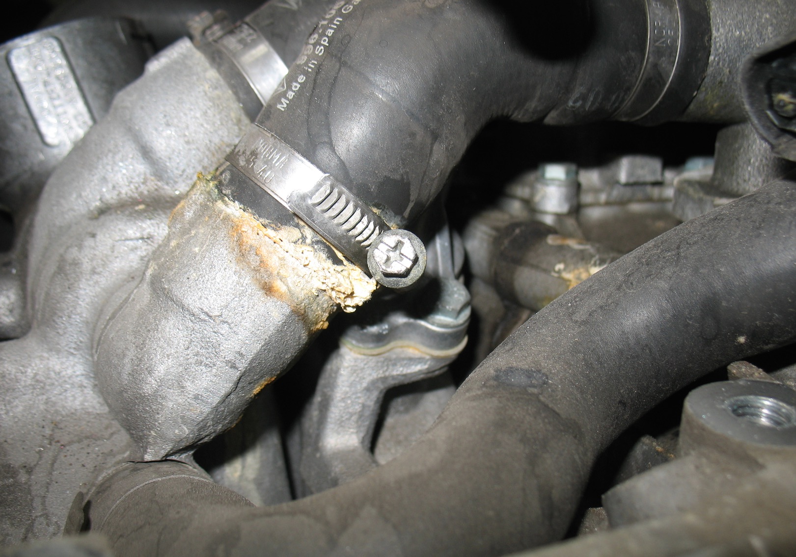

I haven't suffered the water pipe failure yet, but one of the first things I did after getting my car was track down as used parts the four housings with water pipes that could fail and get the fittings welded, so I've got all the parts ready to install if and when the day ever comes that my engine springs a water pipe leak. I'm currently not doing track events, so I can't see dropping the engine (and the $3K - $4K until I actually need to). The most common failure is the small pipe under the alternator that as a temperature sensor in it (first photo below).
FWIW, I spent hours reading all of the threads on this topic, including reading all of the materials submitted by Porsche to the NHTSA when they investigated this problem. I concluded that welding was the best way to go; YMMV.
Nice welds, who did the work?

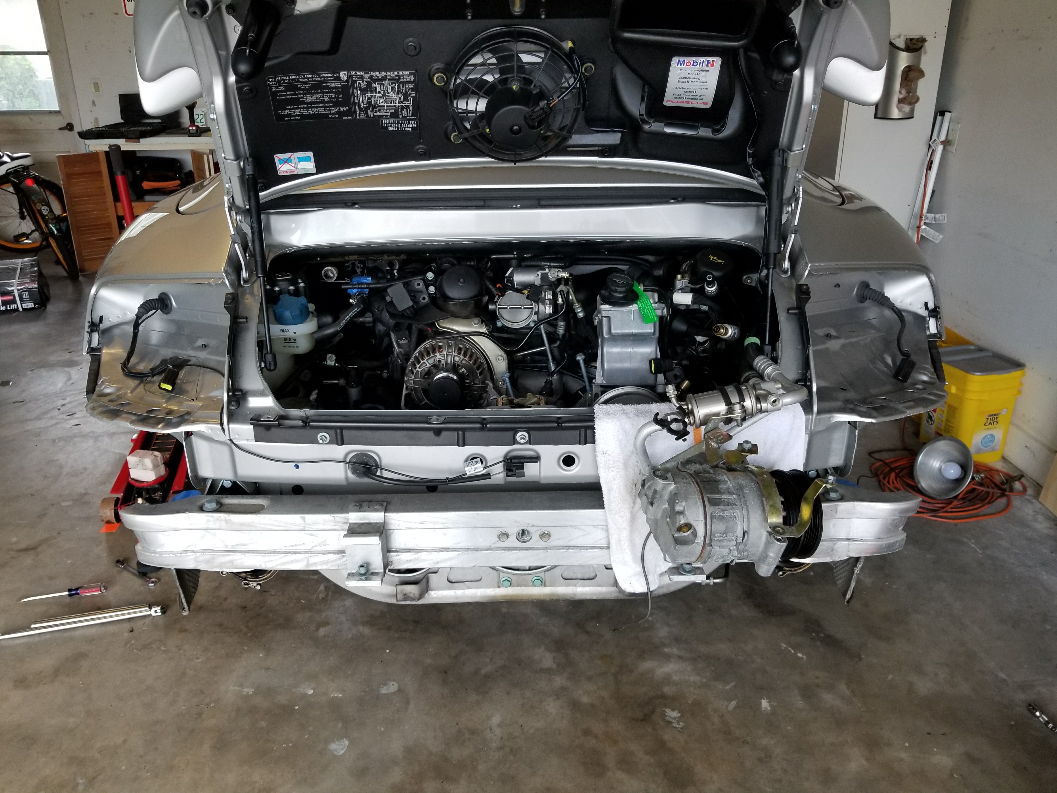

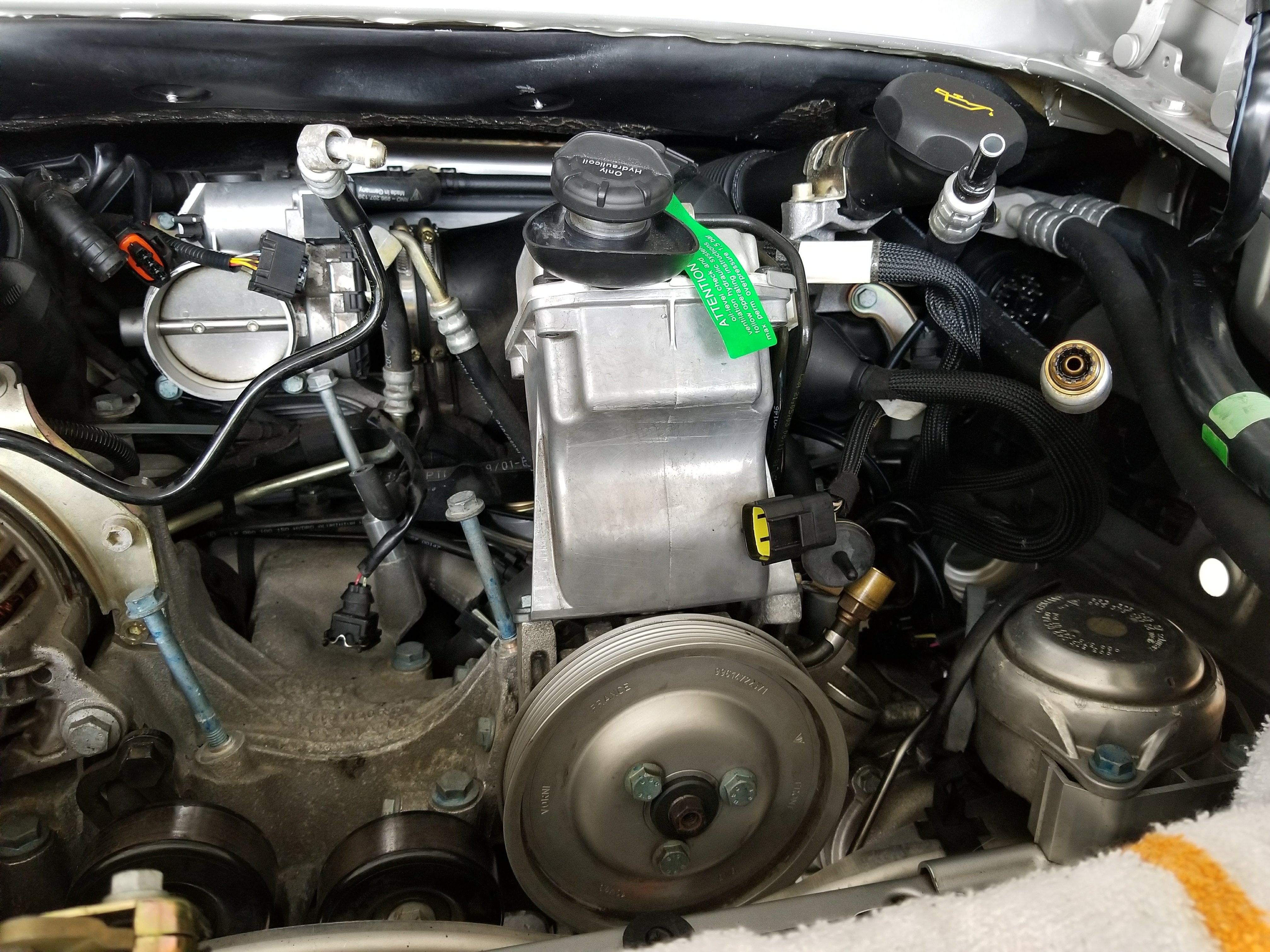

I'm about 99% ready to drop the motor. Its definitely not the easiest motor to pull... much more doable thanks to all of the past/present forum peeps!!! I appreciate y'all.
Btw, I am NOT looking forward to putting that turbo inlet piping back together. Bleh! MFer
C'est la vie. I will take more pics when it's out.
Here's where I'm at:

Good tips
I already pumped all of the pentosin out of the p/s reservoir using the pulley; so it's not leaking... and too late about the I/Cs and exhaust. It's not like I'm gonna put em back on to drop the motor!! They only take 2 seconds anyway AND this is my second car, so it can be down for a little while with no inconvenience to me.
I'm not going for the motor pull/replace speed record here. Lol

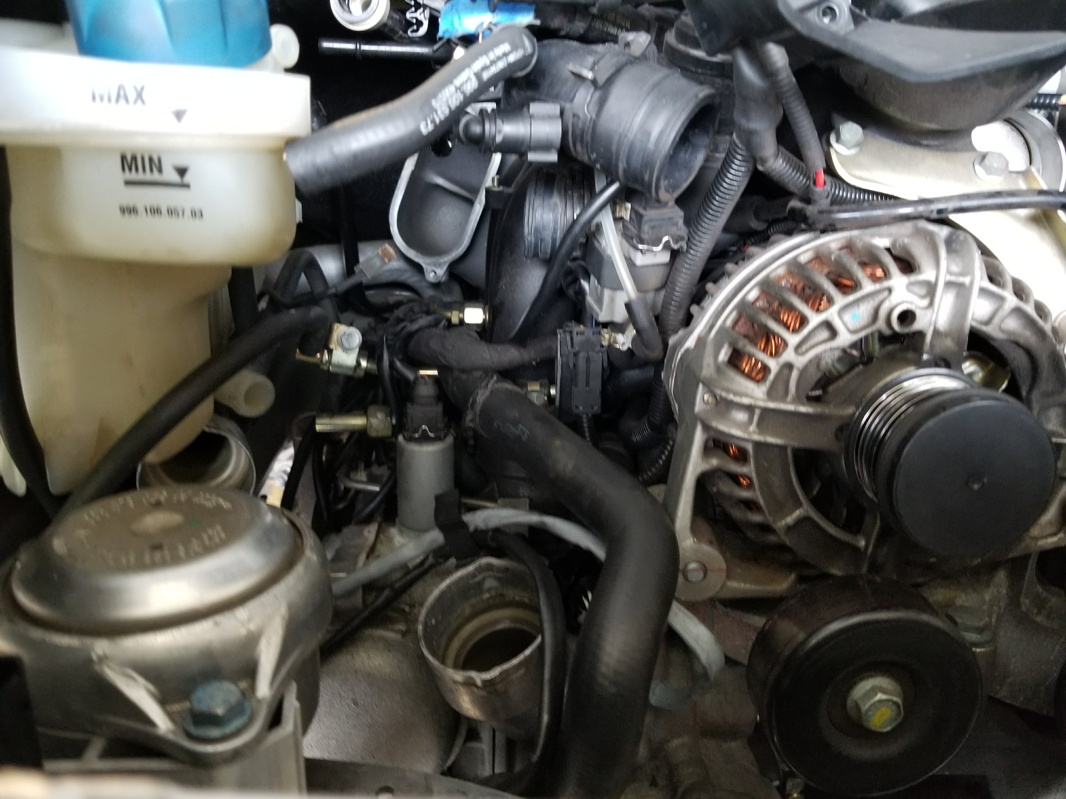

Once I pulled the alternator this little bastard was staring me in the face
