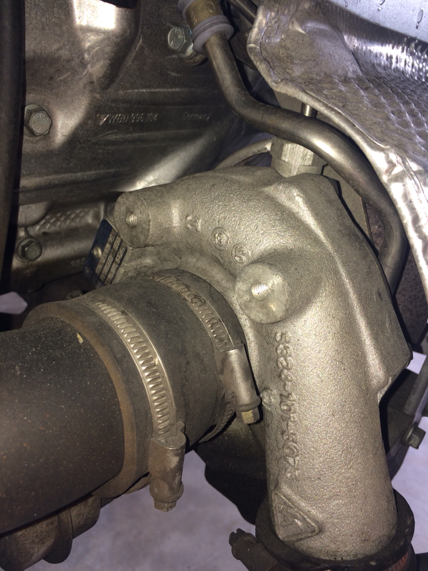

Also, these turbos are starting to look kinda small... there's plenty of room in there. 🤔🤔

I'm kidding! Unfortunately, I won't be addressing them now. This is going to remain a coolant pipe failure thread. But it's awfully tempting to empty my bank account "while it's apart"...

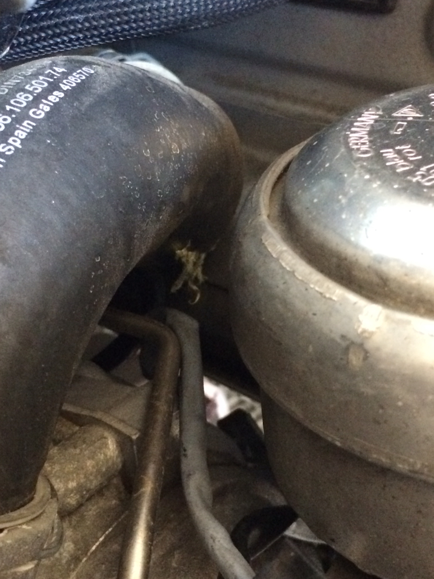

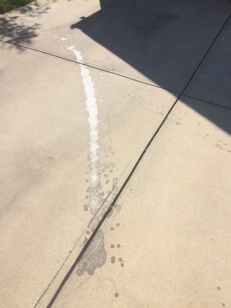

Aight y'all. I just found my problem and don't even have the motor out yet.
Split hose. Rear passenger side just ahead of the motor mount. You can see the yellow string guts of the hose blown out in the pic. It's a longitudinal tear. I'll get better pics when the engine comes out and I pull the hose off. Click image for larger version
At least this reopens the possibility of pinning my fittings... not sure which way I'm going to go now. ATM I'm probably still leaning towards having BBi weld them.

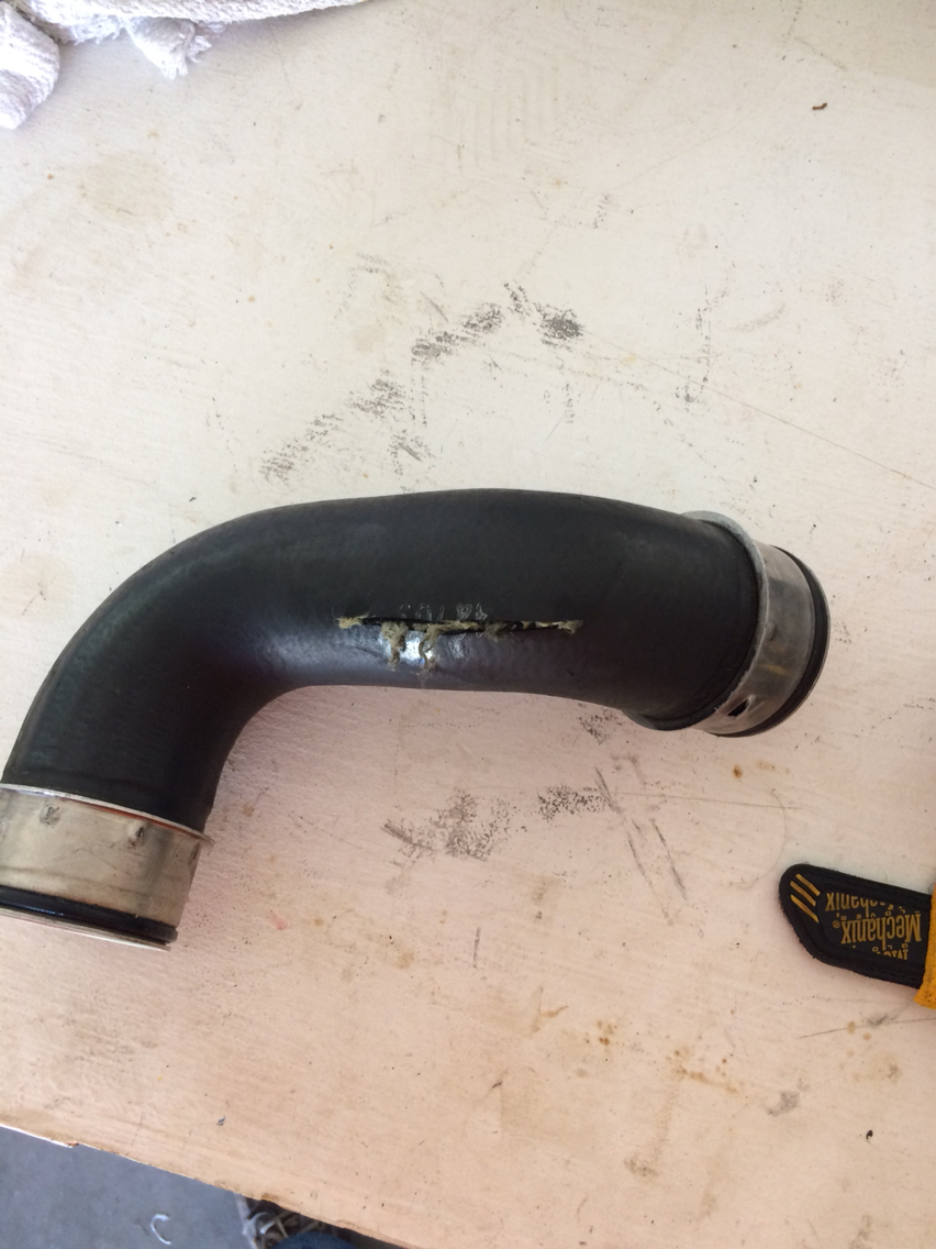

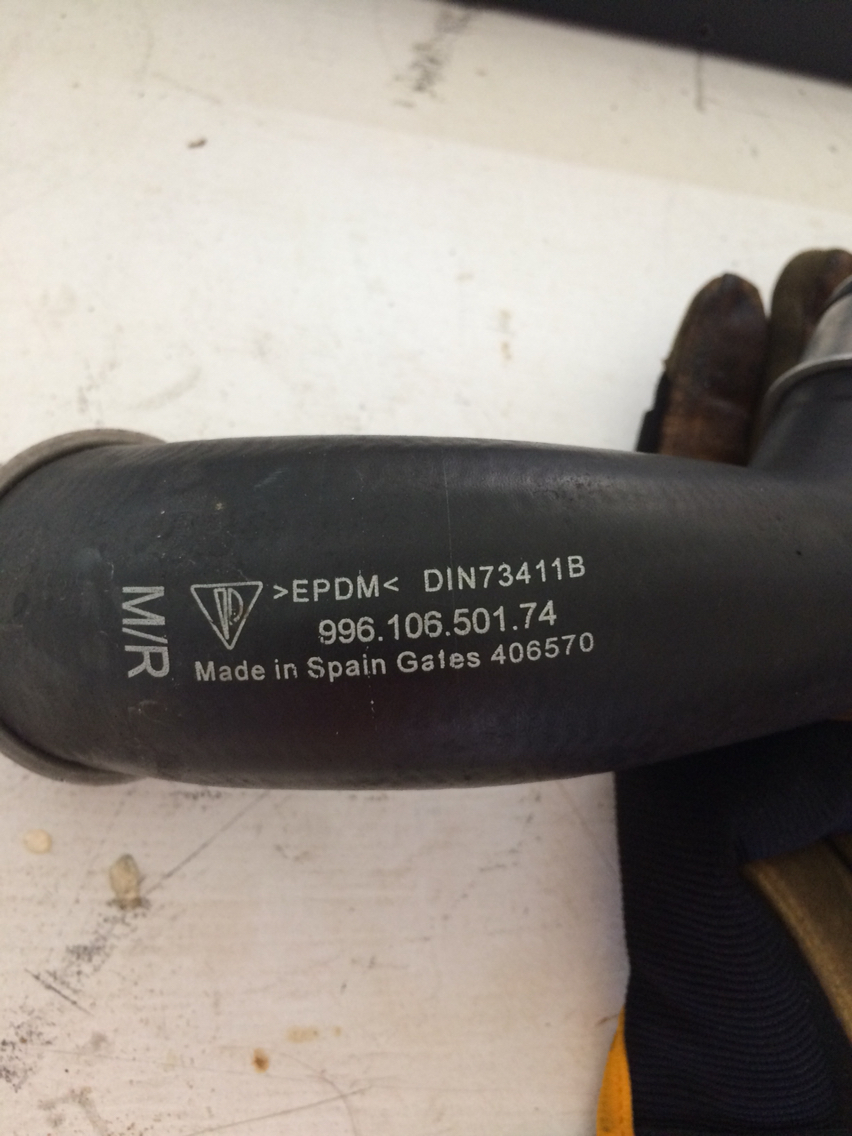

Here's the hose. Split and p/n. Click image for larger version

You got your leak!!! There is an updated part# for this hose 996-106-501-77, $23.34 !!!

The updated Right hose is as JP said 996.106.501.77
The updated Left hose is a 997 p/n...
997.106.502.00
