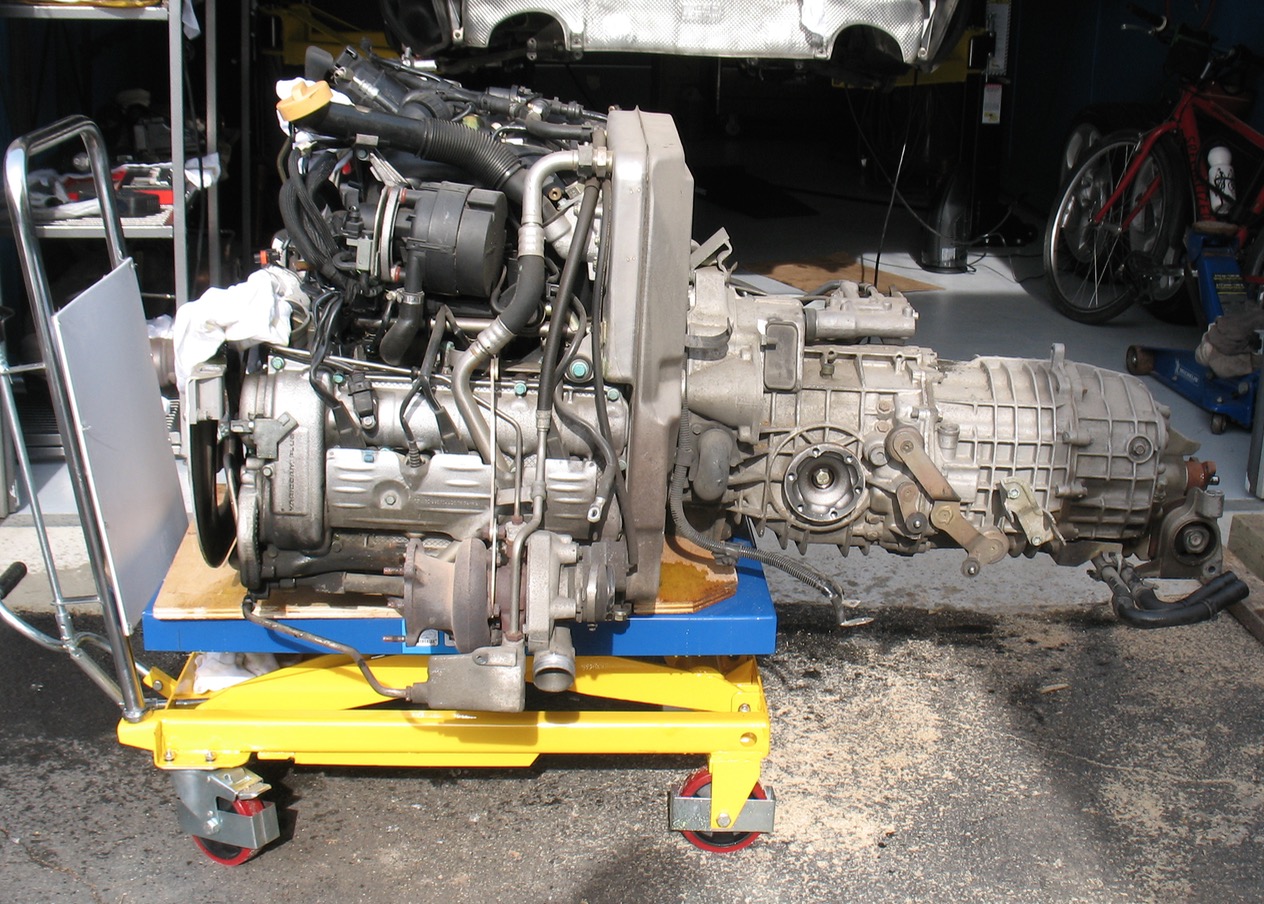

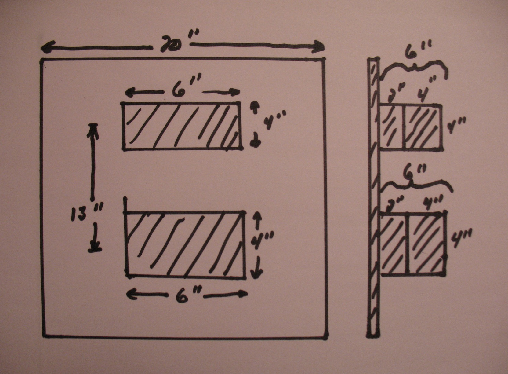

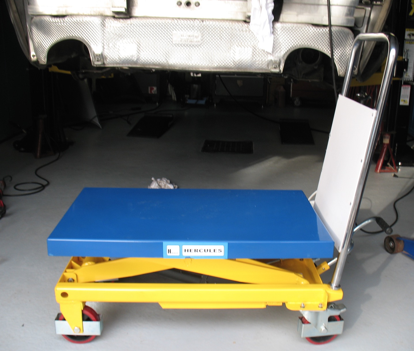

My hydraulic table is 32 X20 and here's some pictures of my set-up.....The last picture is the wooden platform to secure the engine on the table.... For the height, I got a lift cannot help ;-( This set-up was used several time and I am really happy about it....

I order that table from a company located in Canada (link below). Unfortunately the one I got is not there anymore and the prices are a lot higher ???? I got the model # 716240 MOBILE LIFT TABLE/1100LB CAP-B and I paid $588.00 but you can found better deal at Harbour freight I think.....

The last picture on my post is the platform made of wood. I made it to get the block of the engine to rest on it.....It was really stable and was able to move the platform with the engine on it around the garage without any fear of falling off.....

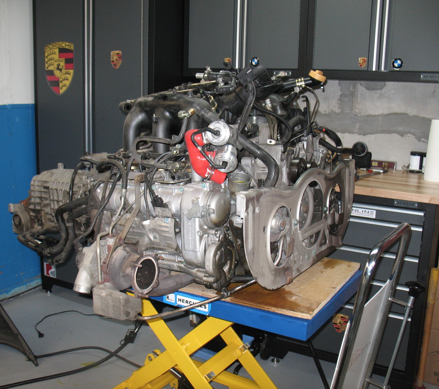

You live north of Toronto? A little bit too far for me to give you a hand My set-up was perfect and with the lift table you can adjust the engine at your height to work on it easily.... Never had a problem with stability, transmission on or off....

Hydraulic table is a lot more precise to operate when you lift the engine in place. The other factor is you can do it alone like I did! But if you got someone to operate the lift I guess it can be done if your lift can be operated gently....

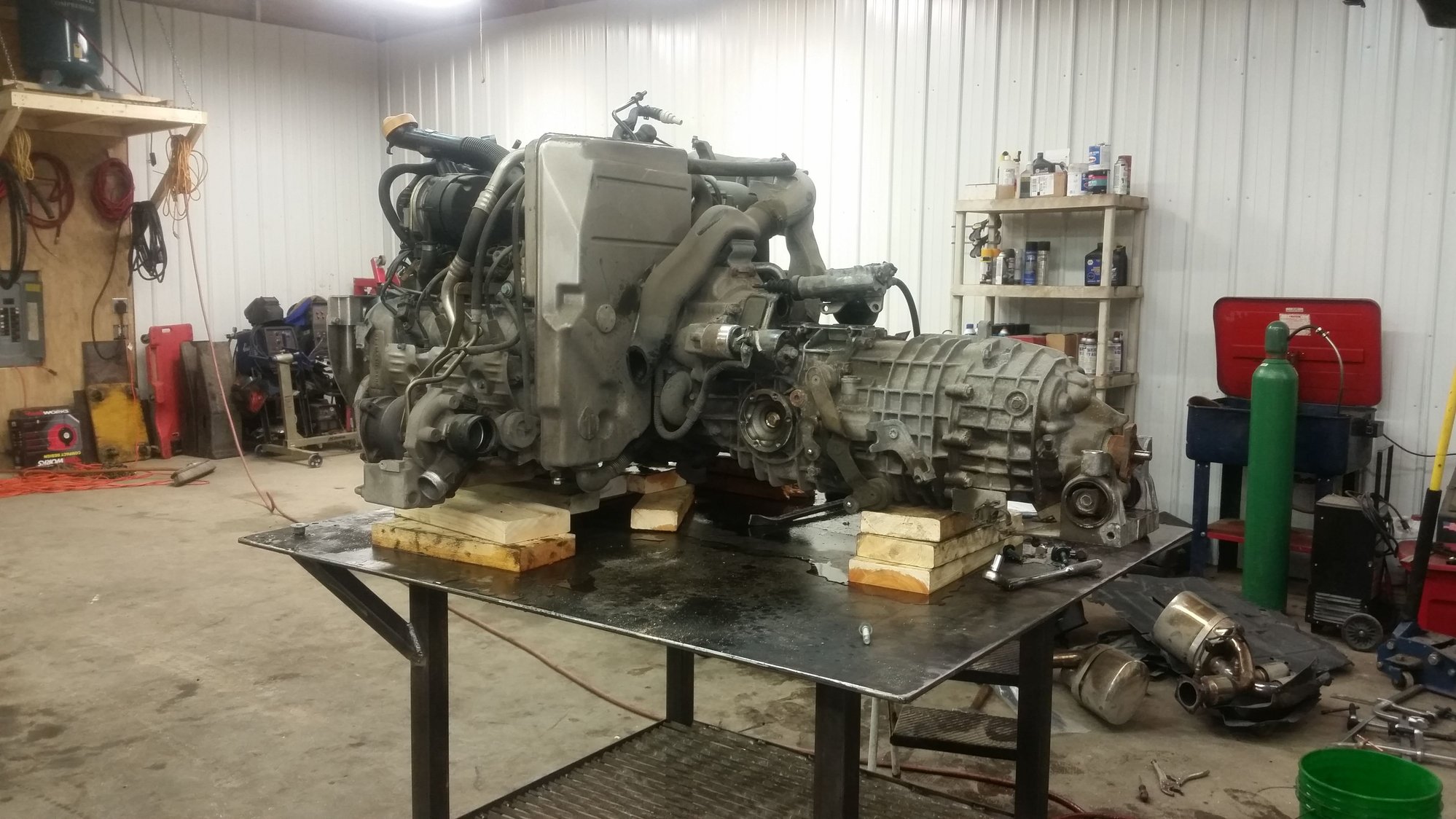

I use me welding table with some wood blocks when I pull motors. I'd have to measure but I think is 40x48

^^^^ That's what I'm talking about!
