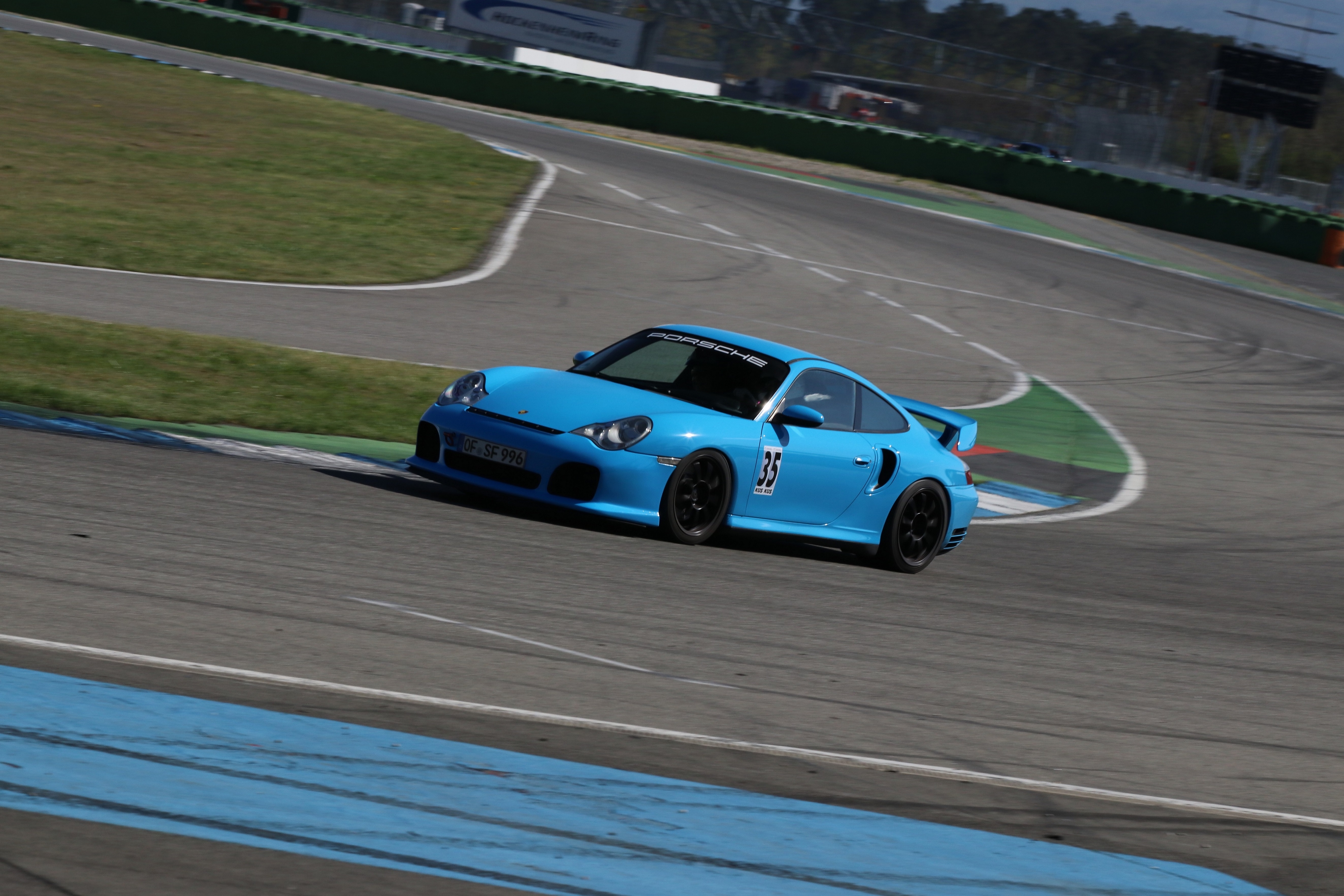

the ET40 offset on the front can be a probleem, when your car is lowered. So rolled fenders on the front are a good thing.
On the rear it isnt neccesary. Just the fenderliner on the inside can be a problem, so the 996 GT2 brackets can help out there.
The pic shows the GT2 wheel size on my car with Toyos. On the rear i got 5mm spacers.
