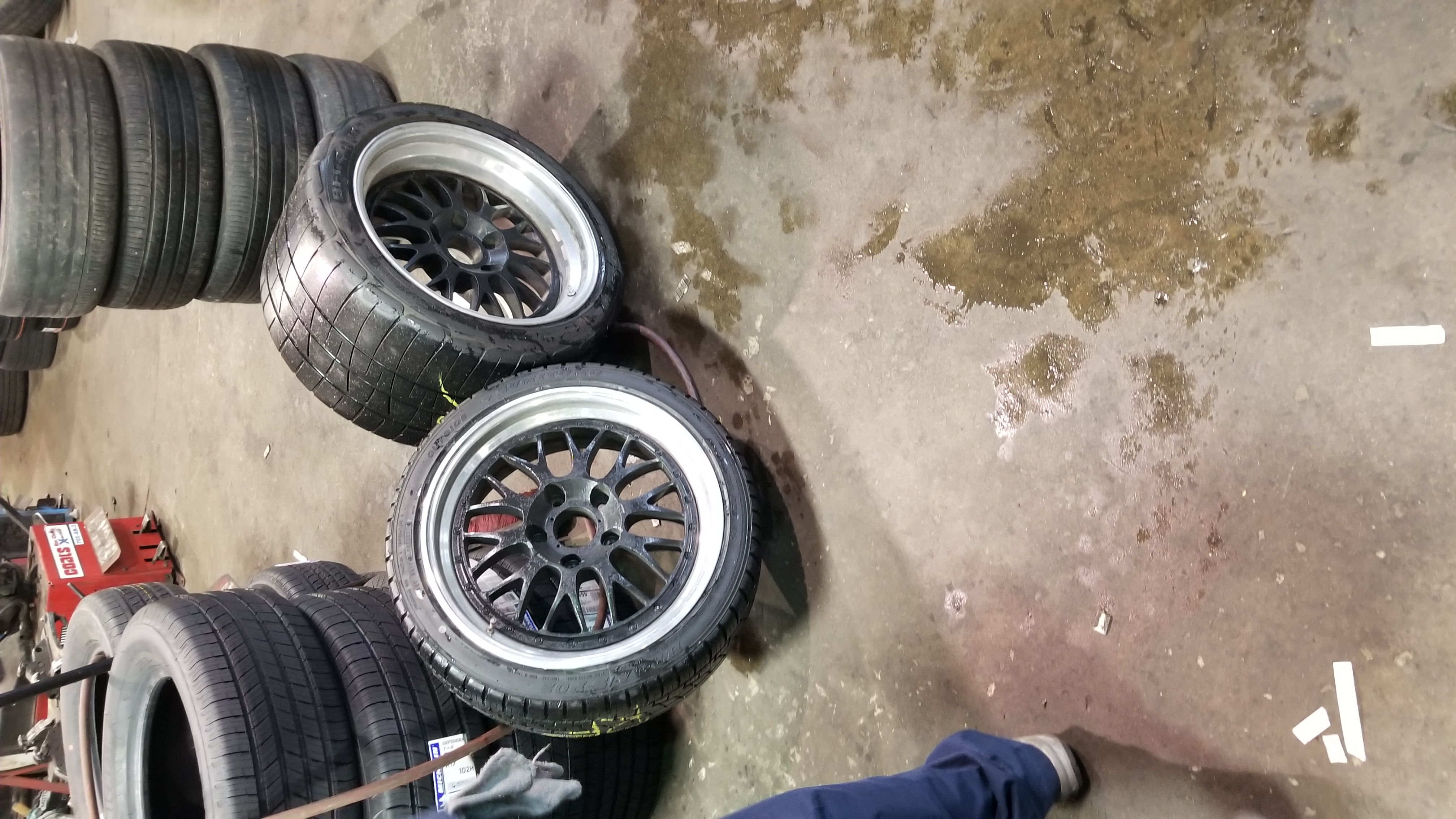

Sorry for the crap pics but here are the 335 on 12s.
Hey thanks for the pics, seems they do in fact run wide if that is on a 12" wheel. On a 13" might only have slight stretch.
Interesting setup. Since you drive a gt2, any rubbing? The rim got Gt2 stock offset?

I don't have a gt2, just gt2 wing and bumper. As for rubbing, my car is super modded. I think I have my rears rolled and pulled more than anyone, even john. Front as well. I run only the rear intercooler liner in the back. These rears are 12 +41 but I run 5mm spacers as well to push out flush but still habe wiggle run on track to never rub.
as for front, if you do the radiator mod, a 265/35/18 will fit up front fairly easy with that and rolled fenders. 275s require a bit more work and running more camber

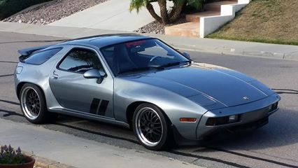

I am running the BF Goodrich 335 30 18 ties on my 18x13 E28 wheels on my 928 widebody. They fit well, a little stretching.
By the way, I am looking for a source for new or used 24 hole BBS barrels for these rims. I have a hairline crack in one and one is a little bent. Any suggestions?
