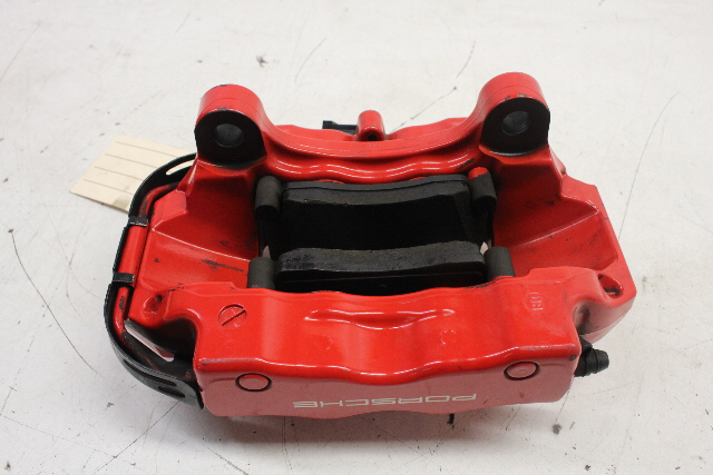

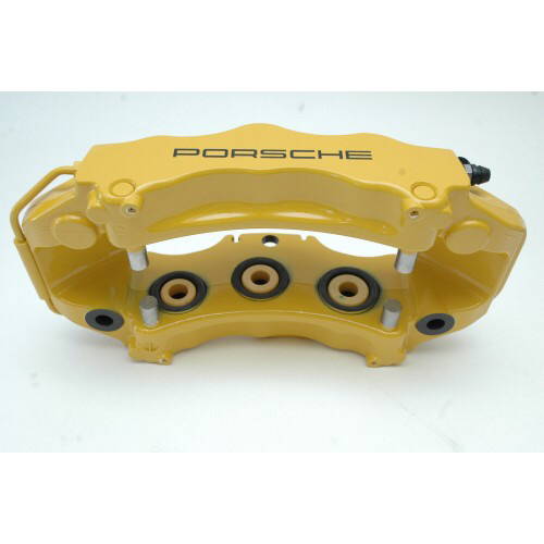

Originally Posted by j_the_guy
I was looking into 6 piston brembo kits and they are all pretty expensive. I was thinking about a budget option, would the front breaks from a ceyanne gts fit on a 996tt with 19" wheels. I'm thinking about doing a stage 3 600hp build and need to upgrade the front breaks but I don't want to spend $3k-$5 on 6 pistons.
No. Different caliper mounting layout. The cayenne are mounted with tabs versus radial stud mounted like ours. While it is possible and often that people use our calipers with an adapter bracket to make work on tab mount applications, the reverse is not possible.
Those look like calipers from a new cayanne. Would it work with a ceyanne from around the same years as the 996? I don't know much about ceyannes btw so they might not have had 6 pistons back then.
All the cayennes are flange/tab mount type.
