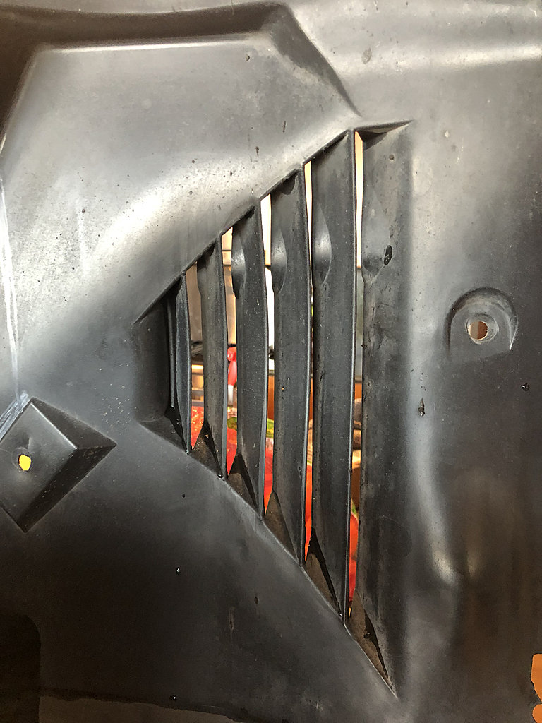

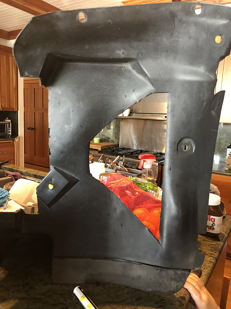

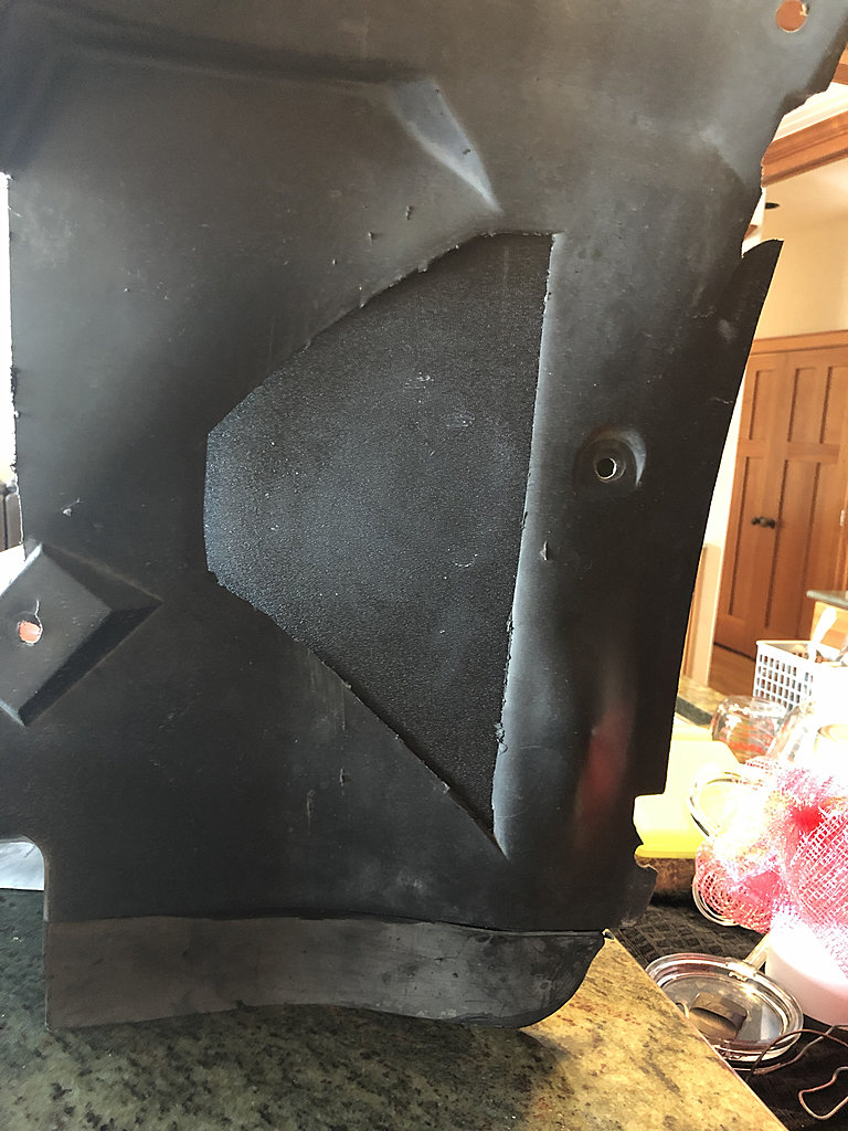

ID:	531643Click image for larger version
ID:	531644Click image for larger version
ID:	531647Click image for larger version
ID:	531646Click image for larger version
ID:	531648Click image for larger version
Old Jan 12, 2019 | 02:31 PM
jdexter's Avatar
Joined: Jul 2014
Posts: 347
From: Syracuse, NY
Rep Power: 33
jdexter is a splendid one to beholdjdexter is a splendid one to beholdjdexter is a splendid one to beholdjdexter is a splendid one to beholdjdexter is a splendid one to beholdjdexter is a splendid one to beholdjdexter is a splendid one to behold
https://www.amazon.com/gp/product/B01M7O5BZO/ref=ppx_yo_dt_b_asin_title_o04__o00_s00?ie=UTF8&psc=1 https://www.amazon.com/gp/product/B01M7O5BZO/ref=ppx_yo_dt_b_asin_title_o04__o00_s00?ie=UTF8&psc=1
I used 1/16" HPDE plastic from amazon. Only needed one sheet. I bought the grills to attach to the new cut out section like John's. However, I'm not sure I really need to add it. I may leave it alone.

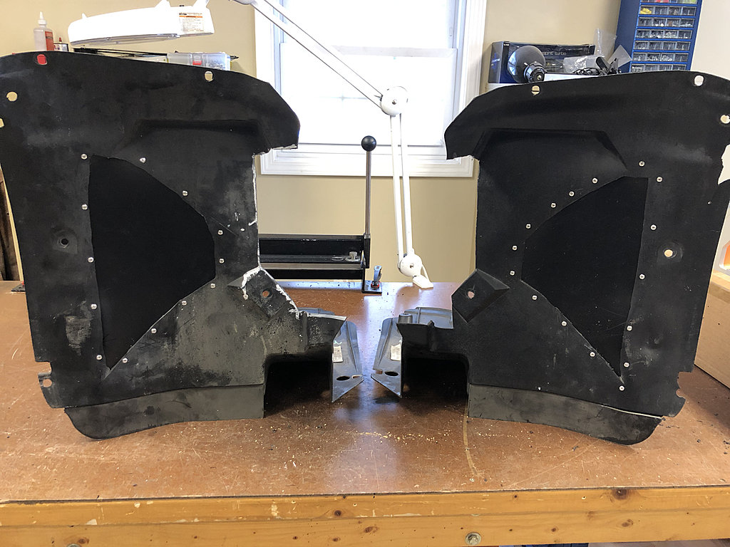

So I trimmed it in place to get the most airflow I could. Here's where I finished.
