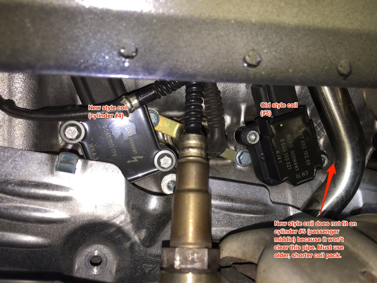

What coil pack for 996 Turbo Cylinder number 5?
I Just ordered 5 newer style 997 coil packs and longer screws, but what are you guys using for cylinder number 5? My 996T coils are original and need to ALL be replaced. Thx

I'm in an '03 and did not have any trouble with the new style coils (997-602-104-02). #5 was a little tight so I wedged a screwdriver against the pipe just to move it a hair. Worked out perfectly. I used 1/4 inch E10 sockets. One long and one short and some wobble extensions.

Originally Posted by BOOSTTT
I can't find this part.
I was involved in starting this posting the pic above. Another forum member convinced me just bending that tube out of the way to make room if necessary is acceptable. It seems to vary by car. Or you could source an old style coil from your dealer as I did, or reuse your best old one.
