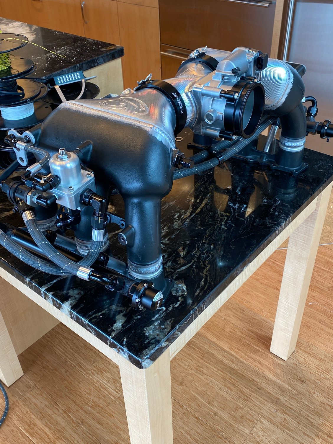

Quick mockup of new manifold from SRM. I ceramic coasted the halves and need to redo them - but gives you a good idea.
