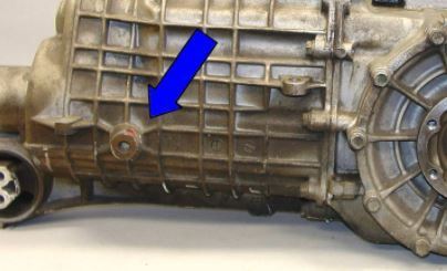

Sounds like you pulled the wrong plug? There should be nothing behind the side plug.
Should be this one.

Wrong plug. Fixing this will require gearbox disassembly...
I assume you did not remove the fill plug which is directly behind the oil cooler on the drivers side. You can see it here directly behind the zip tie on the oil cooler "center ear" in the picture below...
It's hard to see, but I replaced the hex socket filler plug with a 17mm plug from a 944. This makes it easier to remove as you can easily put a 17mm box wrench on it.
