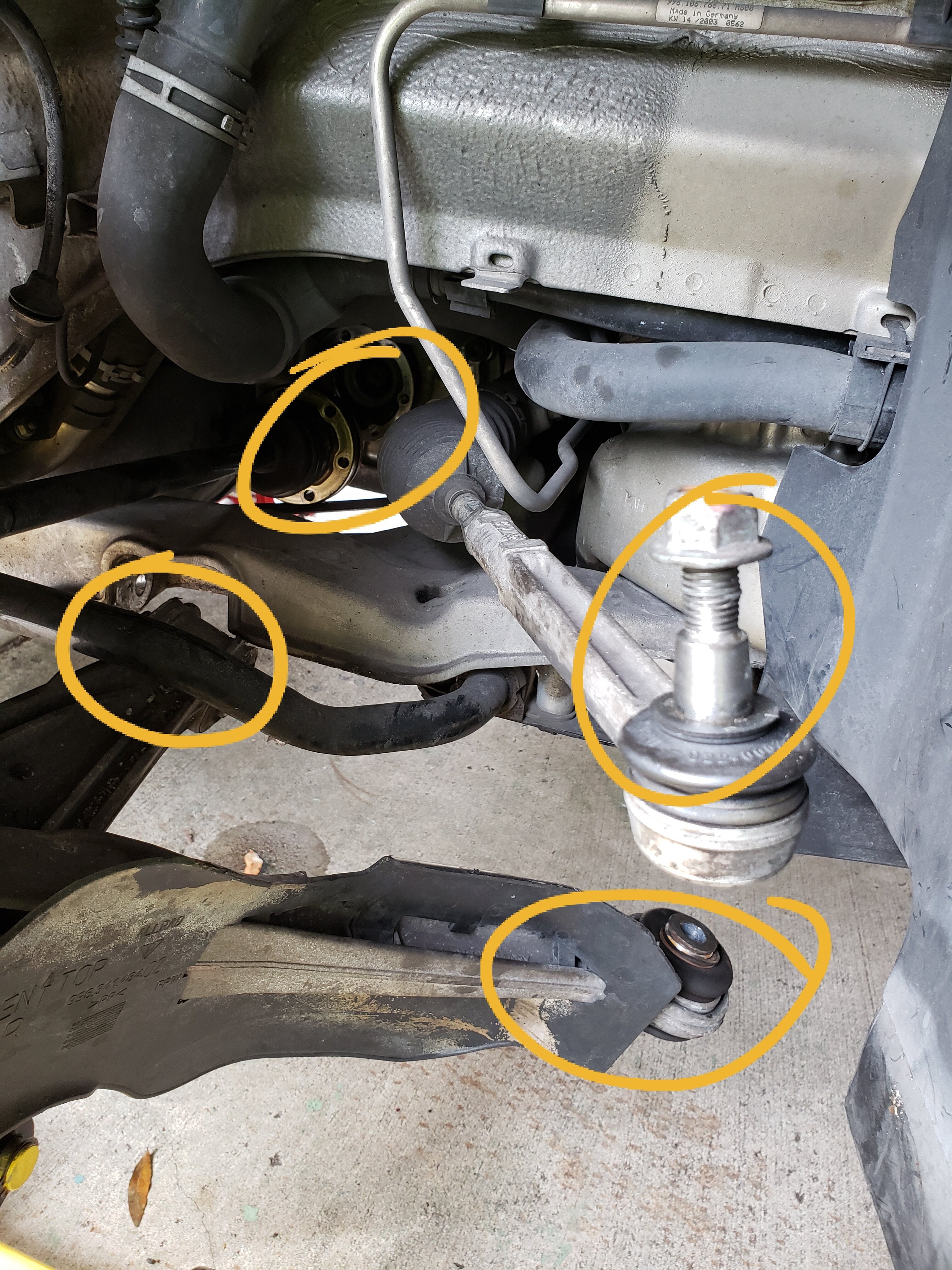

You're supposed to disconnect the front axles as well. I pulled mine out of the diff and put them back in but this caused my seals to leak.

This rings a bell. I may have also unbloted my axles. What do you mean pulled them out of the diff? They're just flange bolted face-to-face... also curious what seals messed up and how? Hopefully I didn't cause any issues that I haven't noticed yet!

The axle splines in the diff are just held in with some compression C clips. I forgot to unbolt my axles and they just pull straight out of the diff.

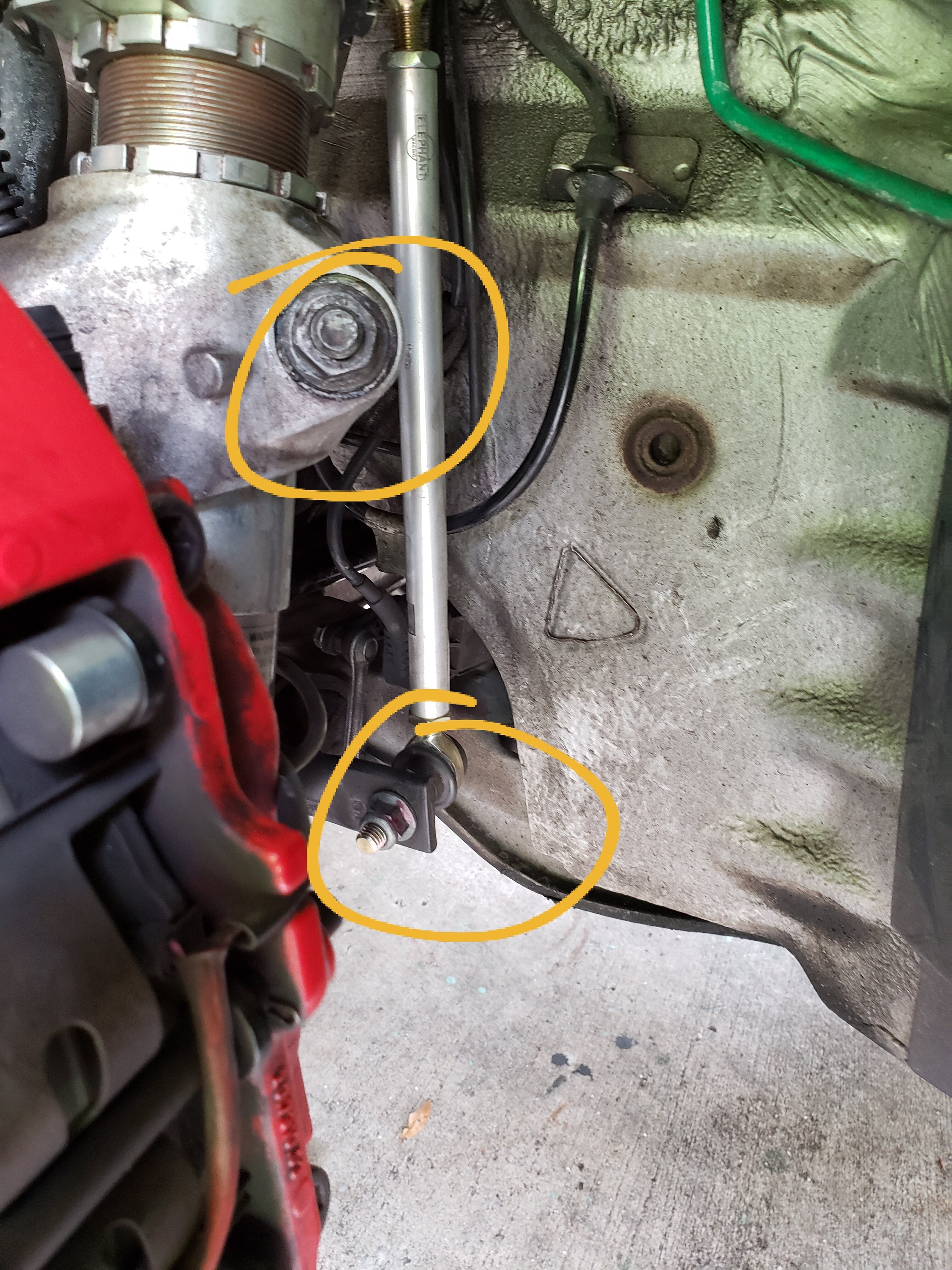

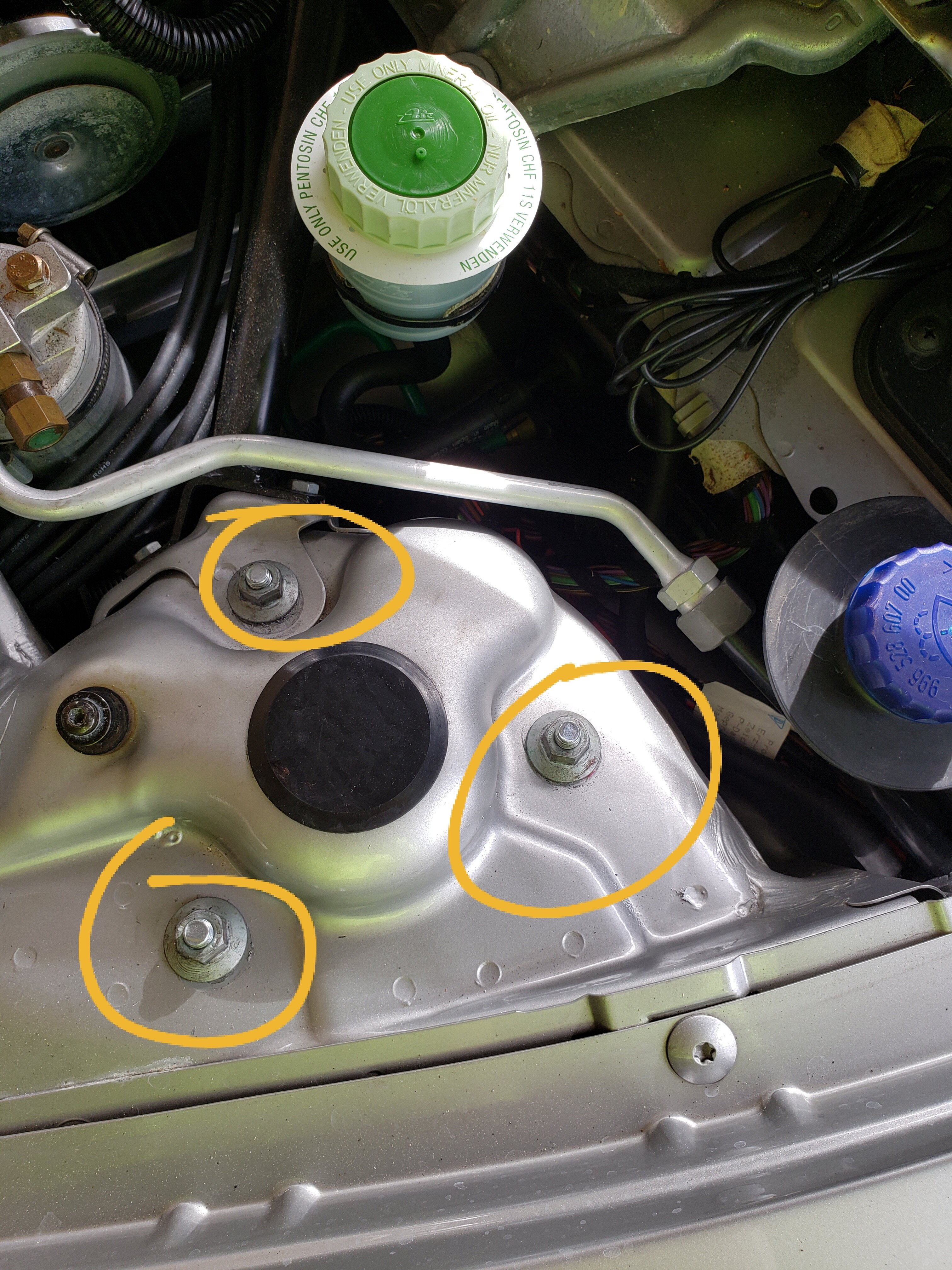

Holy jeez. It took me about 8 hours to do the swap. Its so tedious to transfer all the threaded collars and lock rings from the old to new struts...
I won't do a "write up" as its all been done before but I will throw up a few pics to show what I believe to be the minimum amount of members to remove in order to do this.
