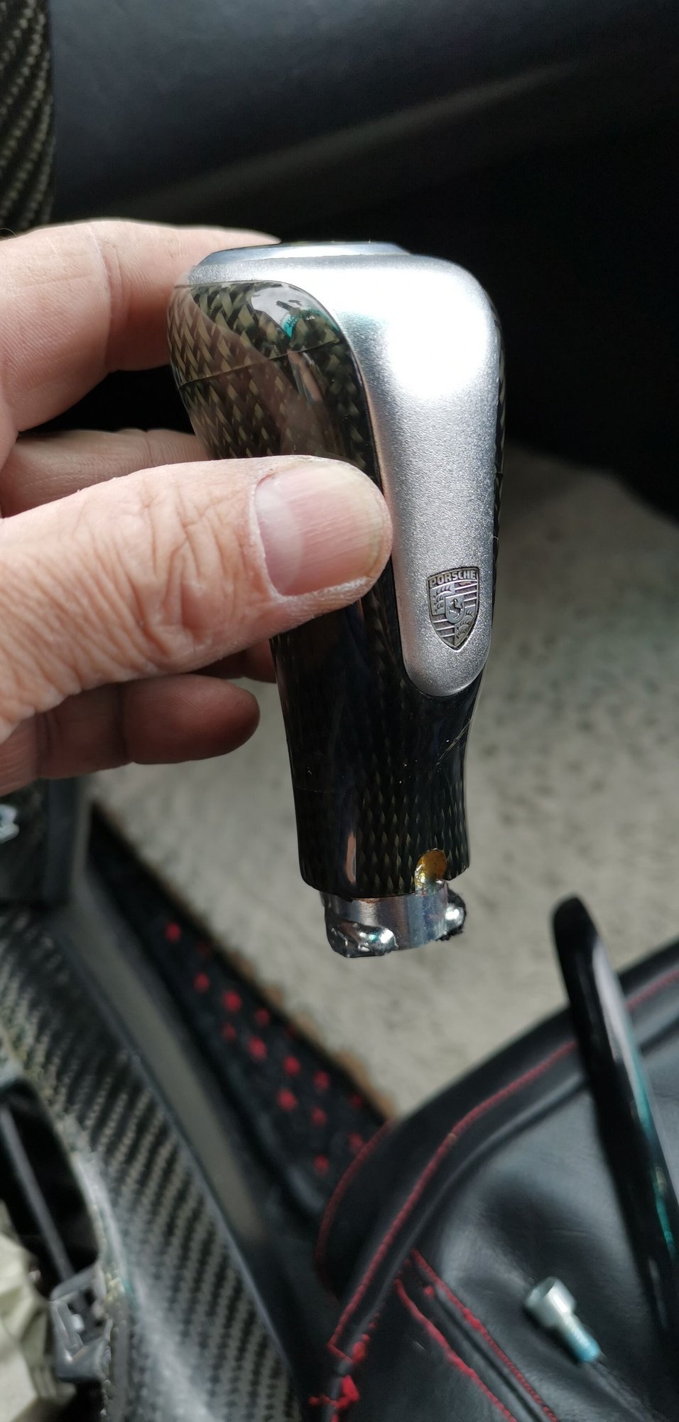

I had replaced my shift boot long ago with Alcantera, but I guess it was pretty cheap stuff. I had some time today so switched to faux leather. The whole thing took about two hours from start to finish. I had some spare hardware so I was able to make the whole boot first. If you only have one, you'll just have to switch the order of things around a bit.
This is the old faded one. (Ignore lab hair)

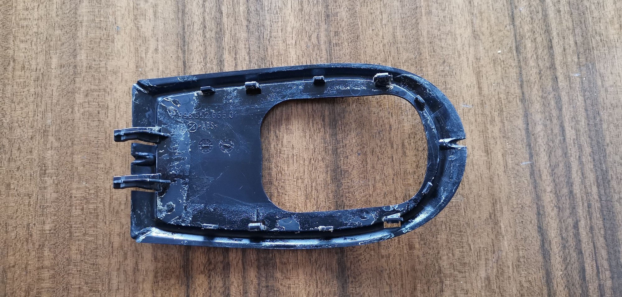

This is the plastic part that connects to the console

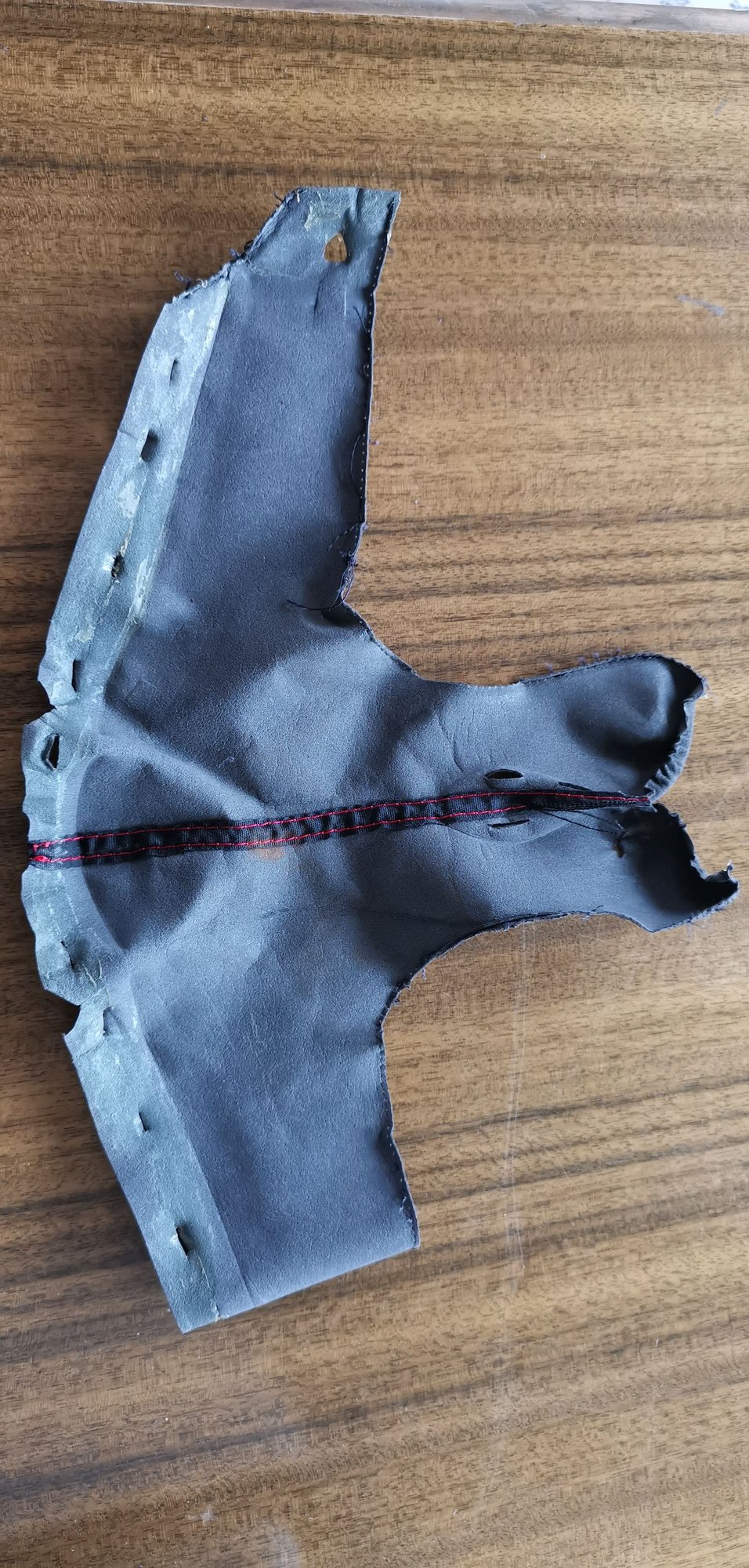

First thing - copy the pattern to the material you intend to use...
If you are going to do the colour stitching, you have to sew the front first. Sew from the inside - you are building this inside out...
... then sew the other side and flip it inside out...
Put the plastic part inside and check for fit...
Fold the material back around the bottom and cut holes to anchor the boot to the plastic base. Work your way around to the front. (You can glue it too if you want)
