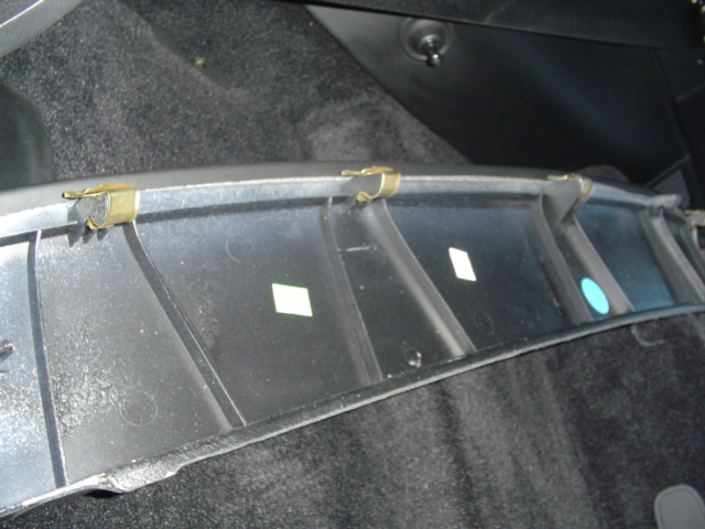

Here is the back of the panel with 4 of the 5 clips still on.

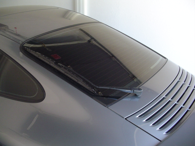

The motor still in place
