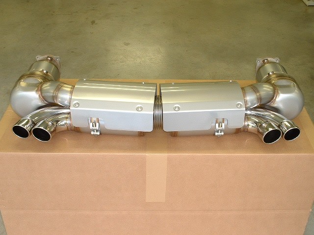

we Dyno tested the 9ff Variotune Gen II several months ago. The result was a 39HP gain!! We were ecstatic with the results.
Of course the real superiority that the variotune has over all other "competitors" is its complete and absolute lack of resonance, a weigh savings of 20 lbs, the smooth mellifluous soundtrack , but most of all the advanced technology that allows the selection of either a "loud" setting or the quieter "sport" setting.
The beauty of the system is that unlike the fine Kreis-seg, the 9ff's valves are entirely behind the cats. As such, the only diversion involves the mufflers. The importance of this is that the power delta between open and closed modes is negligible.
Its a fully engineered, high quality system gauranteed to please the owner for years. Granted, it wont spit fire - like craig's straight pipes, but at least it will pass smog (if they actually test an AWD TT).
Let me know if you guys want to run another test.

HI Its Joe @ Fabspeed Motorsports
Obviously "CRAIG" race systems with no cats and 3.0" tubing will support Gigantic power.........BUT that was not out yet and is "outrageous" in terms of realistic street exhaust tuning.
I completely agree. My exhaust is inappropriate for mass consumption and cannot be marketed as part of a “tuning” package. It is not street legal and it is overkill for most people. Then again, it is capable of “gigantic” power and that is exactly what it was designed for.
IMHO, the Fabspeed Loud is the best available exhaust for those seeking good power from an off-the-shelf product inventoried and readily available. My exhaust is something entirely different, custom made for those that want “gigantic” power that is not readily available off-the-shelf. That being said, Fast Intentions has recently received many inquiries about my exhaust and rumor has it that Fast Intentions may create a jig and make the exhaust more readily available (perhaps even sold by a board sponsor).
Craig

Of course the real superiority that the variotune has over all other "competitors" is that allows the selection of either a "loud" setting or the quieter "sport" setting. The beauty of the system is that unlike the fine Kreis-seg, the 9ff's valves are entirely behind the cats. As such, the only diversion involves the mufflers.
I have never seen a 9ff Variotune, so I cannot comment on it. However, most of the valved/switchable exhausts that I have seen have a common design shortcoming. The valve is half way through the pipe running parallel to the cat/muffler, such that, when the valve is closed, the exhaust flow is permitted to travel down the pipe to the closed valve, thereby creating resistance/turbulence, and when the value is open, the exhaust flow is still split between two open pipes, with some of the exhaust flow traveling through the cat/muffler. IMHO, this design is not optimal in either the open or closed position.
