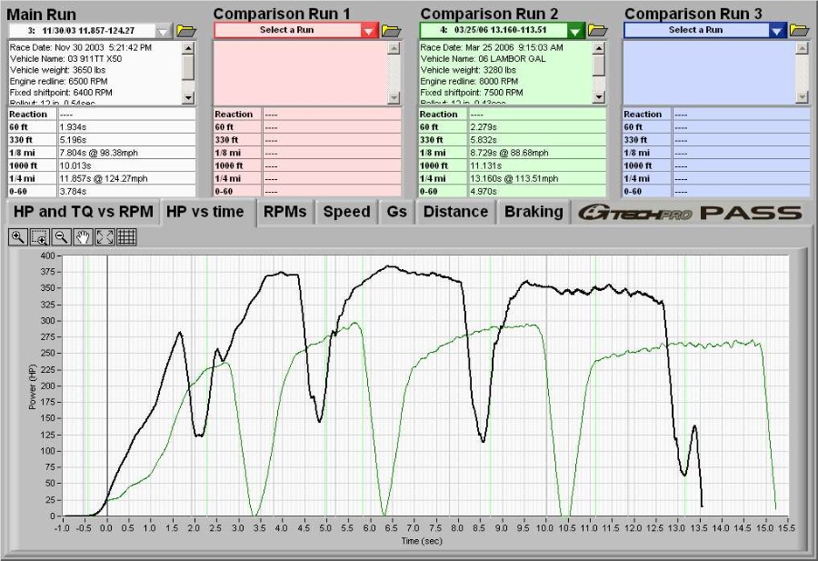

A good way to see relavant HP is with a G-tech since the cars are actually in motion on a road with resistance. Here's a stock 515 HP Lamborghini Gallardo vs a stock 450 HP 996tt X50. Both runs are valid with correct 0 Gs base line starts.
The 11.8 1/4 is from a stock 996tt X50 with a bit over 5000 rpm launch. Shifts were in the .25 second range. The run had a density altitude of about 1200 ft and was performed immediately after cruising out of boost on the freeway for about 10 minutes. Engine intake temps were very good. I tested the Lamborghini in the same location, but with a density altitude of about 2500 ft.
