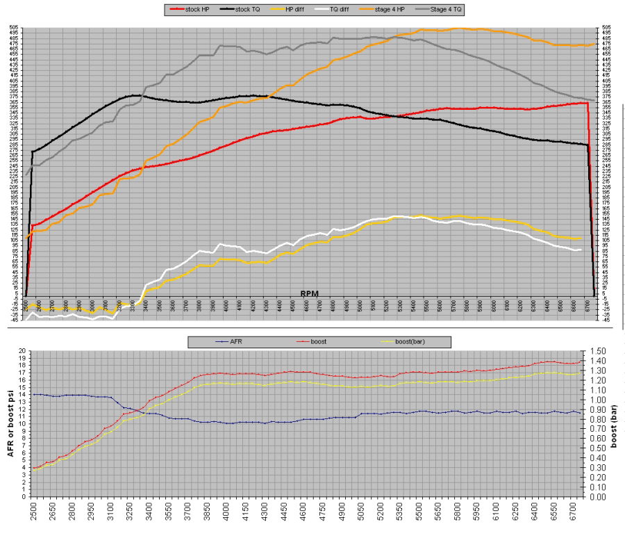

OK so it was my day off yesterday but I decided to dyno the car anyway. It is a EVOMS stage 4 package and the dyno is a Mustang MD-AWD-IMP-DE-B with the variable wheel base option. At the risk of the arguments/discussions that may ensue , here is the data from the run.
It was pump gas, i wanted a good representation of how the car was for the street and the fuel is certified premium(93) out of a drum to avoid the "winter blending" crap that is going on in Michigan right now.

looks great. Do you have the upgraded WG springs? I noticed ur boosting past 1.2 bars and its hard to achieve those values with stock springs.

Markski -the old springs are still intact. I noticed this as well and thought it may have been a bit of creep?? not sure but our pressure transducer was recently calibrated so i have no reason to believe it is off.

hard to read, what was the final HP and TQ numbers you made?

505 hp and 488 TQ in AWD mode. Let me know if you can't read the attached word data file, i never checked it.

Rico - would love to see what our ext wastegates would do to that TQ number. If you get the car to AZ, free test session
