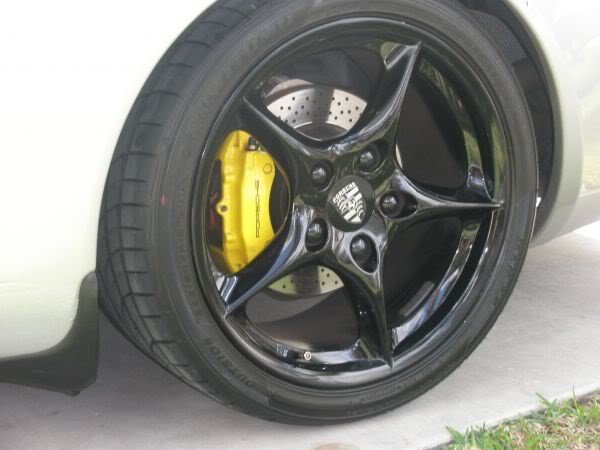

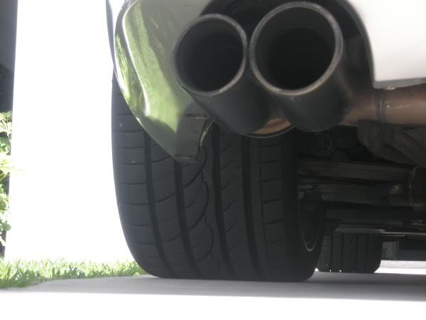

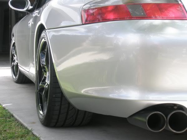

I have 295 X 18s on factory 10 inch rims. No problem.
