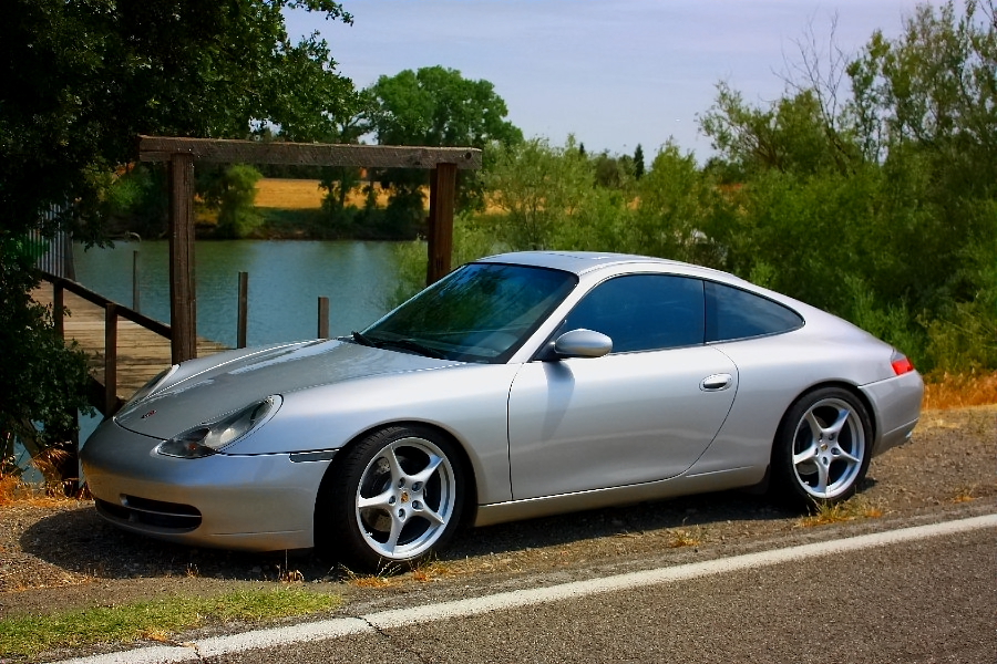

I'm running JIC Cross 7/10 on my C2
Front 25 1/2
Rear 25 5/8
Was supposedly setup to GT3 specs...
Here's a side view
Old Sep 3, 2008 | 07:18 PM
Brando's Avatar
Joined: Oct 2007
Posts: 1,351
From: Roswell, Georgia
Rep Power: 83
Brando has much to be proud ofBrando has much to be proud ofBrando has much to be proud ofBrando has much to be proud ofBrando has much to be proud ofBrando has much to be proud ofBrando has much to be proud ofBrando has much to be proud of
Thumbs up
Exactly what I was looking for!
Thank you!
