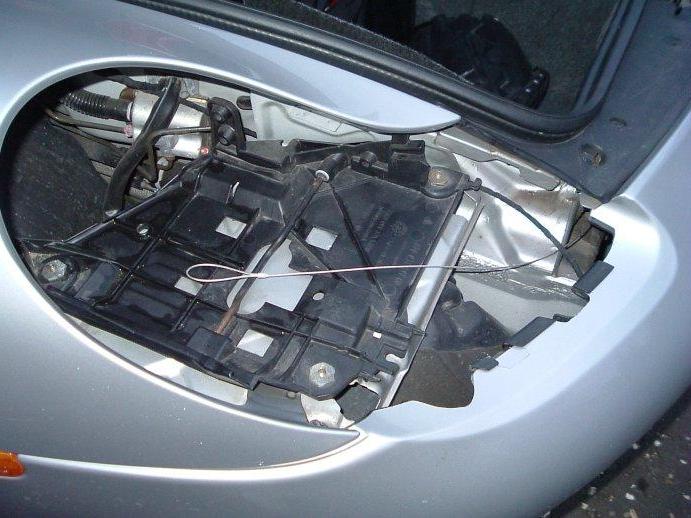

Originally Posted by DucatiS4R
I was packing for a road trip today and locked my only key in the trunk of my 911! Please help me figure out a way to get it ASAP. Is there any way? I tried a pen to unlock the trunk and that obviously didnt work.
Answer (with photo) is on Renntech - you should become a member there as all of the real technical info is there: http://www.renntech.org/forums/index...20front%20hood
Here is the relevant image - flipped to represent US orientation.
Basically, there is a manual release cable on the passenger side somewhere between the trunk and the wheel housing. You have to fish for it, as they are sometimes moved around.
Some people are lucky and find it by removing part of the wheel housing liner. Others have had to remove part or their bumper.
Good luck.
-td

If you have enough time, you might give it a try while you wait. The wheel liner is just held on by snap clips. Pull a few off, and peek in with a flashlight. You might get lucky. (have a coat hanger and some pliers handy...)
At the dealer, you should be looking at less than 30 minutes. Unless they decide they need to take your wheel off, and you have lug-locks with the key ALSO in the trunk...
