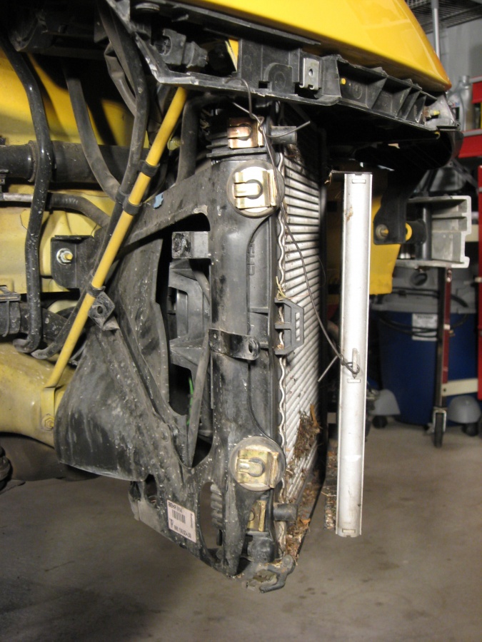

Redridge, thx for the tip. Here's what mine looked like. Please... no flaming me on using bailing wire! LOL
Looks like you are doing more than rad cleaning....mods?
