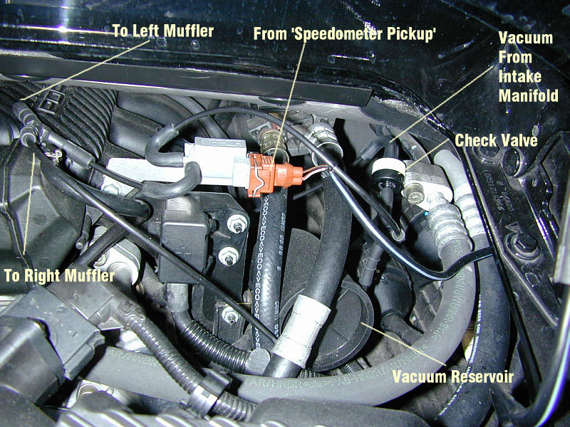

Here's a pic--not mine--can't remember which site I got it from. The "check valve" is the item referred to above. On my last Carrera ('02) I tried reversing the check valve, but it didn't work, so instead I unplugged the orange plug labeled "from speedometer pickup" and wrapped the white and orange pieces with electrical tape to keep the ends from getting dirty in case I wanted to plug them back together (which I never did).

If you modify/disable the vacuum system, the dash switch (if you have one) will not function to turn the PSE to quiet. Not an issue in my mind, since I'd never turn it off...
I just thought of something, I can't just unplug the speedometer pickup because my cab top also depends on that speedometer pickup. I believe that's why the renntech instruction effects the cabs in a different way.
But I'll try reversing the other thing, hopefully that'll work.
If anybody has done this on a cab before. PLEASE HELP.
Peter

You should be able to unplug the Orange/White assembly which is labelled speedo pickup as this is actually the vacuum solenoid whis is DRIVEN FROM the speedometer signal.
The vacuum soleniod only switches the vacuum lines to the PSE on and off and will not affect cab top operation at all.
