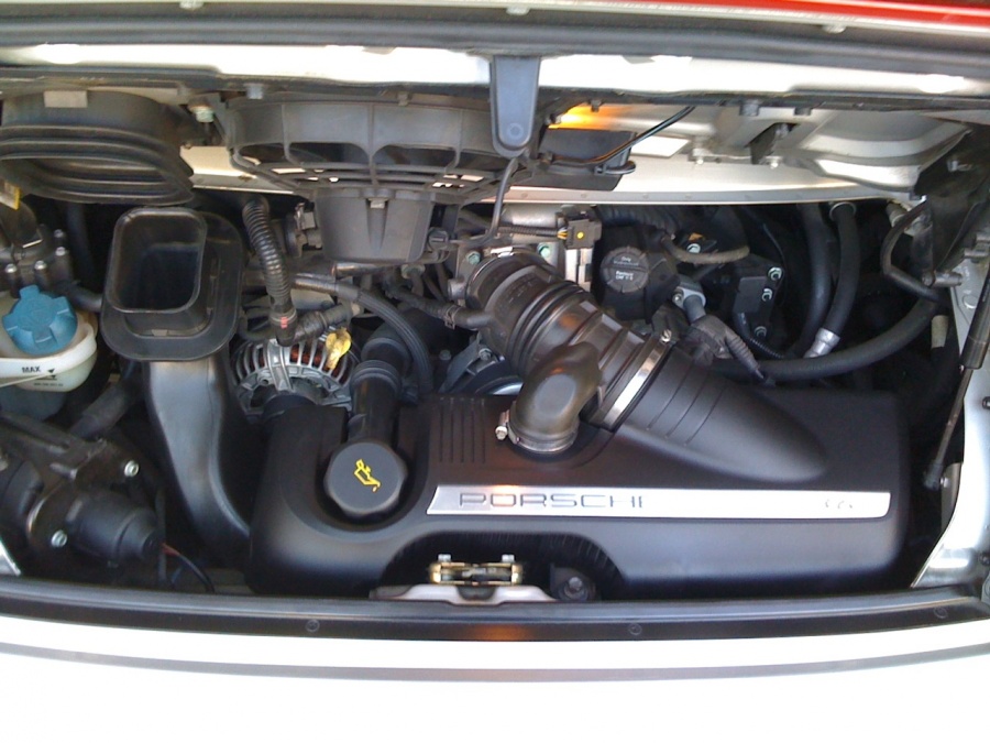

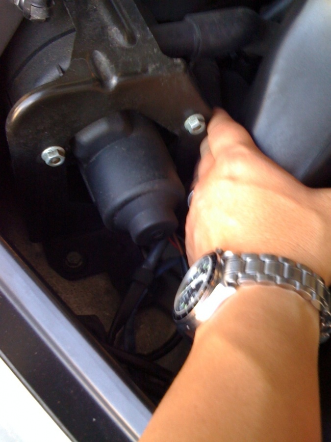

here's my install
So I have a 3.6L 997 airbox installed as you can see. And in one picture, i put my whole hand between the snorkel and the air-pump. Plenty of room. I do have to note, that I have a wide body c4s, I used my 996 snorkel, and my 996 rubber intake hose.
So here goes, enjoy...btw, the last picture, hitchhiker in the old 996 air box.

the evoms bracket relocates the injection pump more to the left of the bay... it makes room for the 997 airbox (997 snorkley and all ) to fit like oem.

Originally Posted by ALE-SUPERBIKE
I mounted on my 2003 carrera 2 of the airbox of the 997 3.8, but it is not mounted because there snorkley 'pump of air. I put the airbox and snorkley of 996.
yep - 997 box with the 996 snorkel = no relocation for air pump.........
I understand why u used the 996 snorkel but why the intake hose?

bought the box off ebay
Because I got the airbox on ebay for like 60 bucks, and it didn't come with either the snorkel or the intake hose
