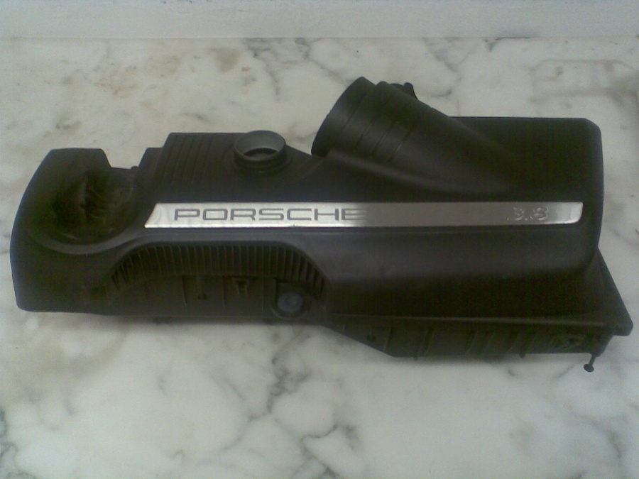

I sold airbox 996 and airbox 997 , contact me .
Old Feb 24, 2011 | 11:57 AM
  #65
2300cc's Avatar
Joined: Jan 2011
Posts: 93
From: Long Island, New York
2300cc is infamous around these parts2300cc is infamous around these parts
You have a 997 airbox for sale?
Old Feb 24, 2011 | 04:07 PM
  #66
ALE-SUPERBIKE's Avatar
Joined: Feb 2010
Posts: 224
From: italia
ALE-SUPERBIKE is infamous around these parts
Yes , i post the pics :
