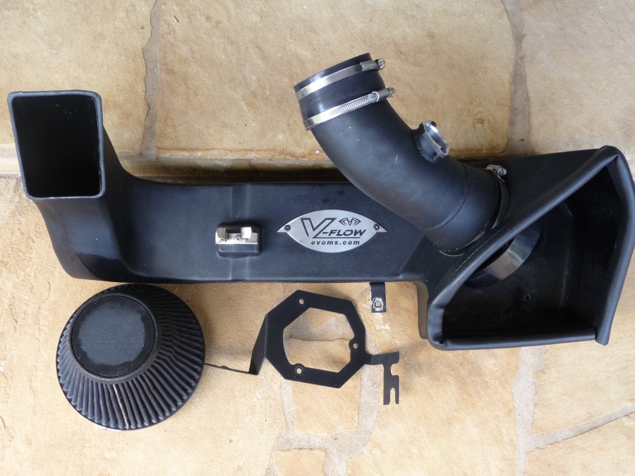

the EVOMs CAI kit for the 996 contains the bracket to move the air pump
over when fitting their CAI to 996. You may be able to purchase it from them. It's the middle item in this pic of their CAI.
Though i've not installed 997 airbox, i believe this part will do the trick as the EVOM kit for the 997 doesn't include this
bracket, where it does for the 996. hope this helps.
