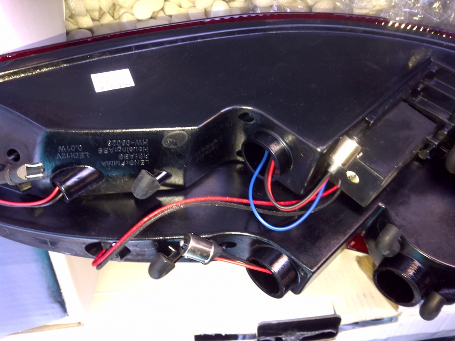

here is the bak of my LED light

here is what mine looked like (keep in mind i ended up cutting and soldering mine because i broke the factory socket)(so you are just seeing the two ends not the whole assemblies)
but the factory socket is on the left - and what was on the LED tailight is on the right - it should just plug in and twist - just like a bulb.
if you don't have this - then i'm not sure what you need to do.
exactly -- you see the ends of the wires are put into connectors that look just like light bulbs (without the bulb part). You just plug it in and twist.
as you can see the one with two wires is the turn signal -- the other is the brake/running light
that looks like mine- ok so i'll go try that, lol- i didn't know that thing twisted in instead of the bulb- Now what about the end little lights, some people said you dont use these? i didn't get it ....or don't plug them in?
ok so from what i understand i will UNTWIST THE BULB (JUST THE BULB NOT THE THING THE BULB GOES INTO) then SHOVE that GOLD END THING COMING OUT OF THE LED INTO WHERE THE BLUB WENT
